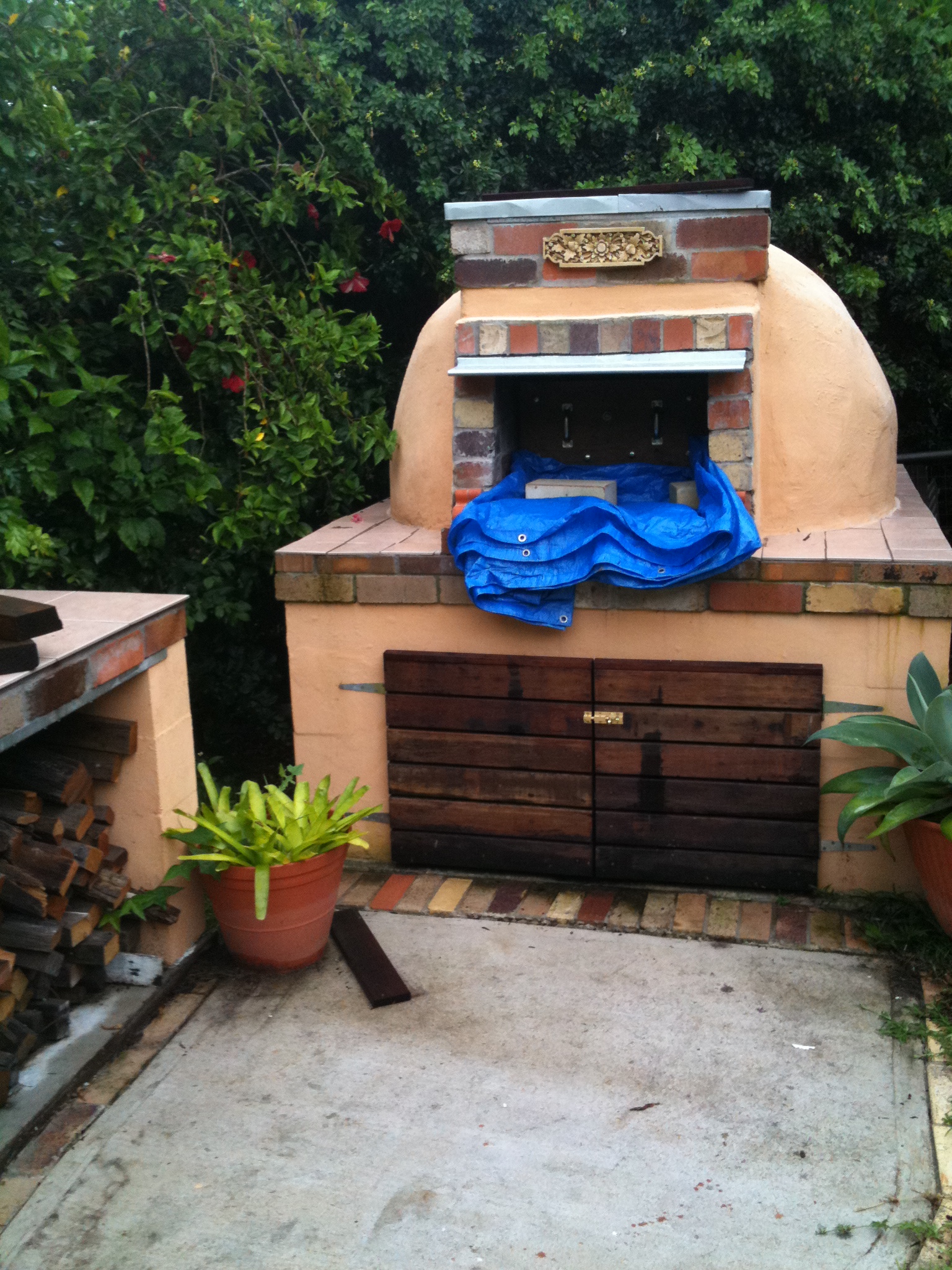

      I lowered the outer arch by one course which helped a lot with the smoke. I think that the smoke is only when I first fire up. Once the fire gets going and the flue starts to draw it doesn't appear to be an issue. I think that with a deeper flue the issue might go away but with my limited space I couldn't go any deeper. A small compromise I guess.
      My oven cracked immediately as I built it. The special fireclay / cement / lime / bricks sand combo made an excellent sticky clay-like mortar which made building the dome a breeze. The only issue, is being almost like potters clay, it shrank as it dried. The result was lots of little cracks on the larger joins.
      I did not opt to shape every brick, only the top courses where gaps started to appear. This meant that there were quite large gaps at the rear of the bricks, which required a lot of mortar, this is where the cracks are.
      Since firing it today, with ever increasing fires, no further cracks seem to have appeared.
      However cracks or no cracks it does not appear to affect it's use. Not sure it will still be standing in 2000 years tho.
      Here's the finished flue + stack
