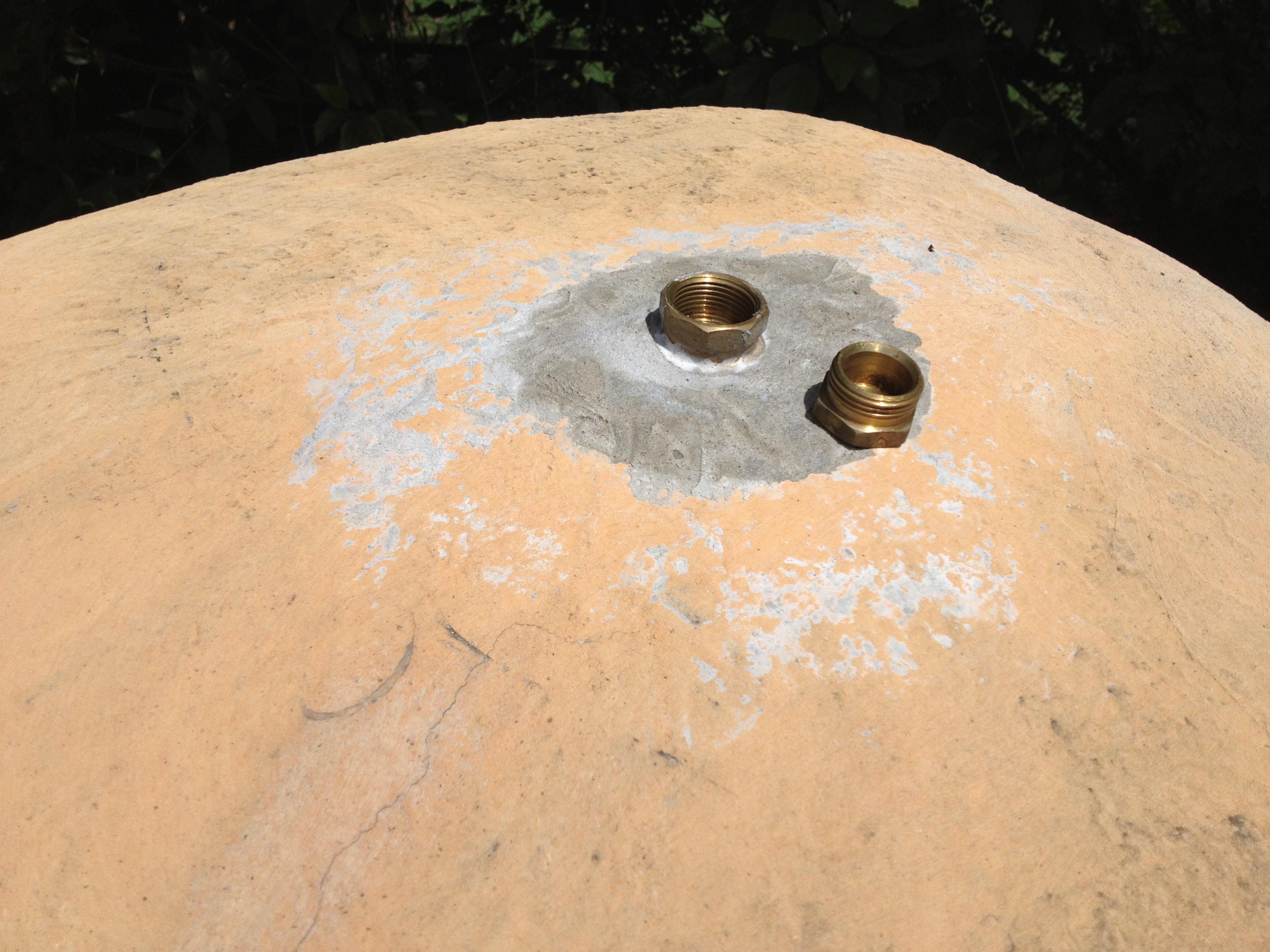

                    I followed Davids advice have fitted a vent to the top of the dome to allow any water trapped in the dome to escape. Mk1 was a hooded 100mm vent cap and allowed the insulation to be open to the air. Unfortunally the ants as well, they like somewere up of the ground when it rains and they tried to move in with the whole family. They dont like a fire lit undeneath them either. It takes all night for the heat to get through to them and I found them next morning pouring out the top.
                    So Mk 11 was fitted and its simply a 25 mm brass water pipe end cap you can unscrew when needed.

                      It is just a Gear Box Breather for industrial applications. It can be removed and the hole plugged with a standard 1" threaded plug. A gooseneck like Cobbler Dave has would do the same thing. The main thing is to have a route for moisture to escape. As far as heat escaping from the apex of the dome is conserned. I haven't felt any heat escaping from that hole since the "heat bead" curing. I have cleared the dome several times including this evening. I still have not attached the breather but my dome is under a cover. I plan to install it when I complete the splitbrick on the dome.
