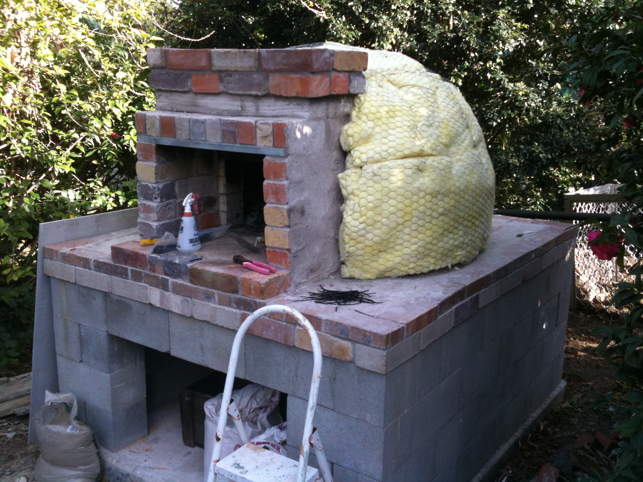

          At the moment I only have enough blanket for 2 layers or about 50mm so I will put that on and see how my shape is looking. If its a bit wonky from the blanket, I'll go a layer of vermiculite on top. If I can keep the shape ok with 2 layers of blanket, I might just buy another blanket and leave it at that. I do like the thought of rendering over vermiculite rather than a blanket tho. Has anyone had any issues with render cracking or being egg shell like when it's straight on top of a blanket?

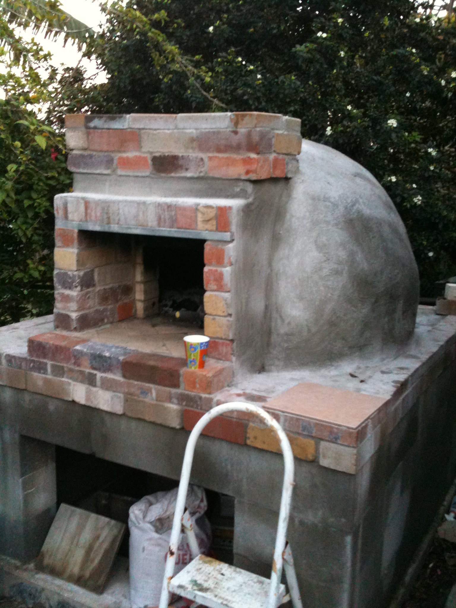

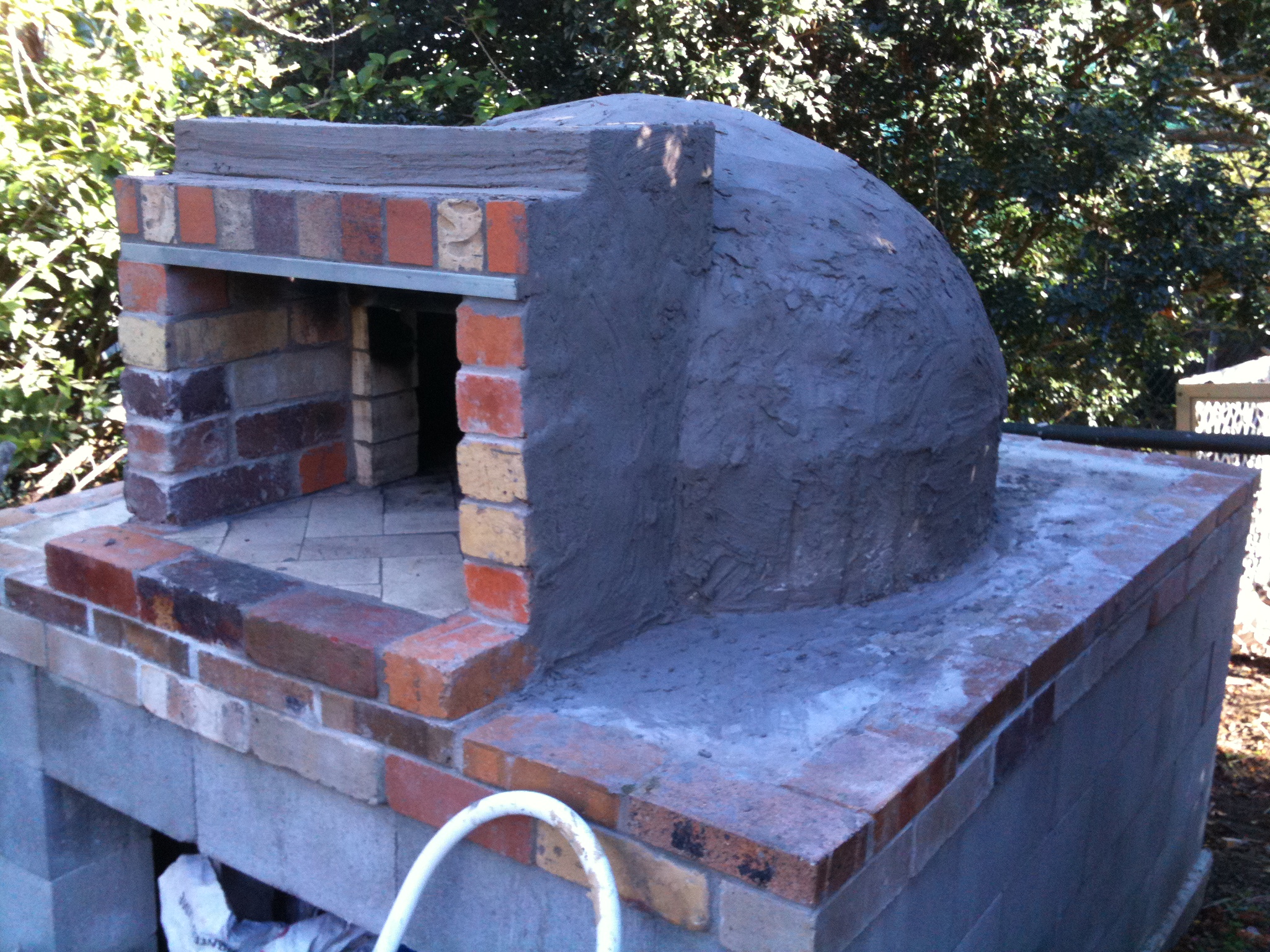

                            I was prepared to do a pearlite layer had a chichen wire cage affair made 75mm out from ceramic and poked handfuls pearlite/cement through the wire and it rained. Ripped the wire and the unset pearlite cement off just in case the rain carried the cement through and wreak the ceramic layer. I replaced the pearlite/cement layer with rockwool ,a layer of chicken wire and put 2 maybe 3 lite layers of render over that. thickness varied probably 20 to 40 mm to overcome the lumps but the rockwool layer wasn't that lumpy. Used just render by the bag.
                            yes I did a crack at junction of the brick chimney and dome. Uneven expansion I suppose, it wasn't a biggy and I chased the crack open with an angle grinder and filled with paintable silastic. Never a problem after that.
                            I have Brick veneered over the dome now more for looks than wheather proofing.

                              Thanks heaps Dave, I'll aim for around 20 to 30mm, should be plenty. Not the best weather for drying out my oven right now that's for sure. Had a look at Gulfs jig for keeping it round. Yeah I'll be in that. This site is so good for ideas and information. Also, I really like your veneer bricks so if my rendering skills turn out to be limited, I might copy your brick veneer idea too. Did you get the brick tiles locally? They do look good.
