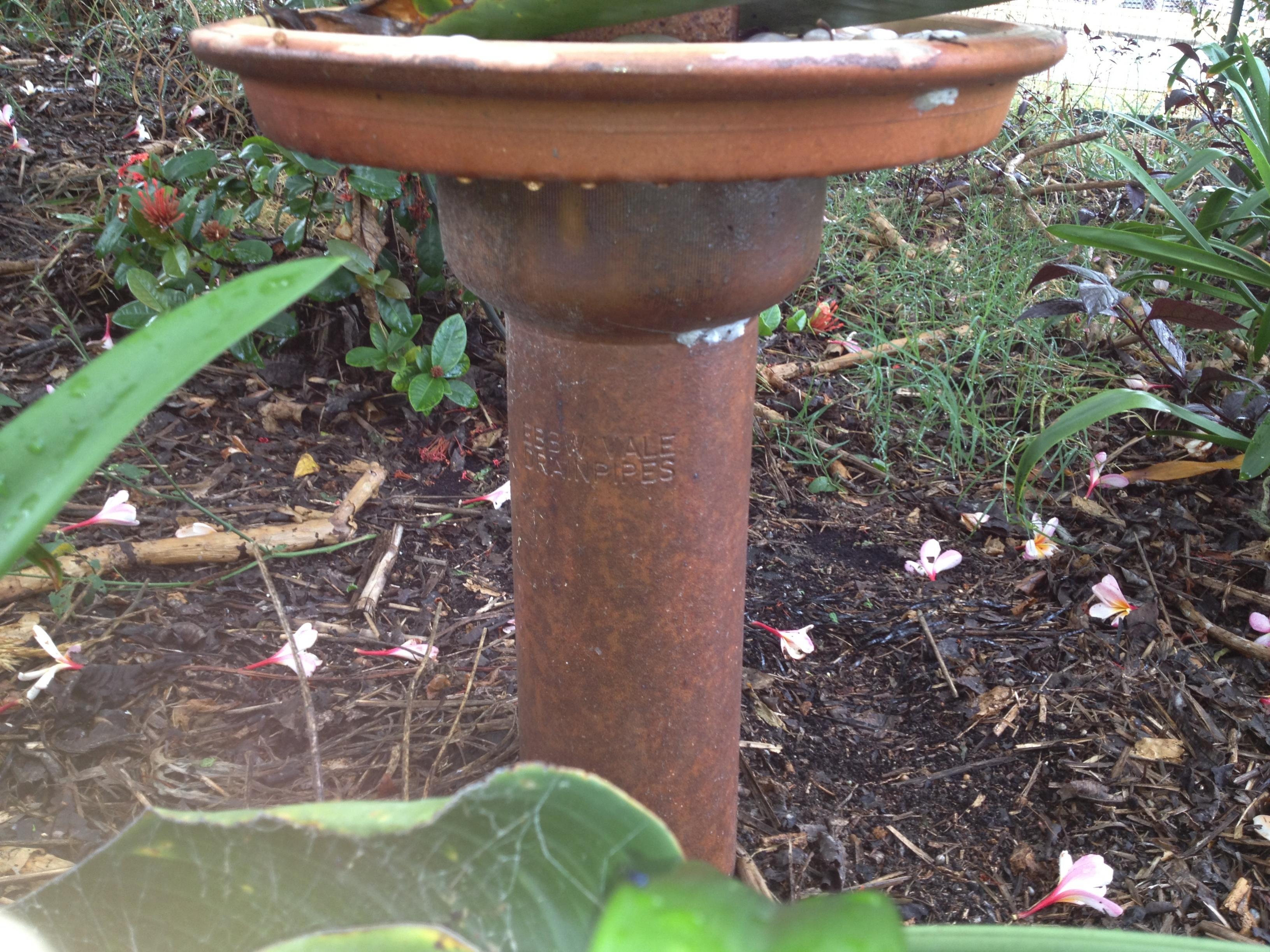

                            An ceramic waste pipe that I had planned to use in my oven which my wife used as a base for a bird bath . It's that much longer as well as 1/2 is buried in the ground. I discarded its use for a chimney for two reasons. First its only 5 ins 125 mm which its much to small for a 42 in 1 mtre oven its should really have a 8 in 200 mm one . Secound is the real possibility of kids breaking it as the clamber over the oven as kids do.
                            You could possibly use twin pipes I suppose.
                            As for used one. I doubt it. They were cemented together as the pipe would break long before you could get it apart. You usually come across them as builders leave a couple spare under a completed house along with spare roof tiles. I suppose most people would never have seen one as plastic has been used for so long now.
                            Regards Dave
