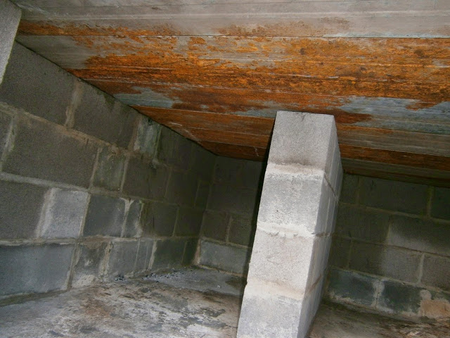

      Shows the framing. All screwed together from below with chipboard screws for ease of removal. I didn't use form work for the slab just a row of bricks. The brick and mortar is 85mm and then the slab is recessed 10mm. Then your core fill and an pour on the same day. Use the builders plastic on top of the slab underneath your insulation layer. You'll only need one thickness it's plenty strong enough

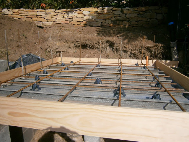

            I actually used metal interlocking metal suspended slab as my base, due to its strength and my centre wall I didn't use any bracing or supports when I poured.
            The whole process was extremely easy. I was lucky as my father in-law had some lying around as it quite expensive, but if you know a builder or have some local construction going on you may get some cheap or free.
            Worth a look as it was a breeze, some of the traditionalists may disagree with this method but I've haven't seen any structural issues with this method.
            Enjoy your build.
            Attached are a couple of pics.
