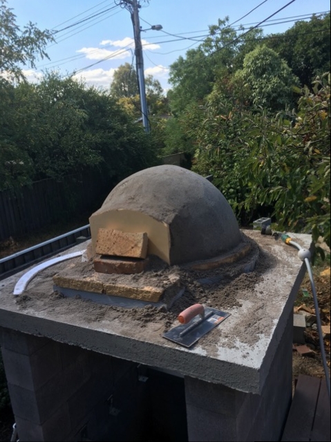

                  I'm using proprietary castable on top of the floor tiles with 5% SS needles (should I make it only 2%? They are rather pointy) . I have made the dome today (picture attached) which took longer than I expected to get the shape right. Its currently 31C here and the wind is blow strong , making it a challenge to put wet news paper down (it keeps blowing away).
                  Big question is is 31C to hot (espeically with strong hot winds) to attempt the castable?

                    5% is good. 2" thick is enough to give you required strength, sufficient thermal mass, reasonable heat up time and fuel economy. In hot weather I always use chilled water because calcium aluminate cement goes off very fast. Don't mix up more than half a bag at a time and make sure your barrow is cool. ie not left in the sun.
                    The castable is quite thixotropic so wiggling it a bit will make it more fluid. When done, cover it for 24 hrs, but it does not have to be damp cured for a week like Portland cement as it achieves its full strength in 24 hrs.

                      You should cover the sand mould to prevent the surface from drying. Cover its surface with strips of wet newspaper to give your casting a good smooth surface and prevent sand sticking to the inside surface of the casting.
                      if it were mine, I'd be making another door face 2" higher and 2" wider at each side to trowel against so you create the oven door mouth with a nice flat front face of the correct thickness. You also need to oil its face as a release agent, to prevent the castable bonding to it

                        I had another piece as a front for the entrance to cement up to that I left out of the previous photo. I missed your message so I didn't put oil on its face, I hope the melamine board will release okay. My finished dome is below. If/When I do it again I will make a template for the dome curve out of something stronger than foam-board (which broke first measurement.
                        I'm planing on making the gallery slightly larger to create the inside reveal of 2 cm.
                        When finishing I realised I had left a couple of section rough and it had hardened already. At those points its about 6cm thick, so I'm hoping other than cosmetic issues (which will be invisible once the blanket goes on) it shouldnt have to do anything ?

                          You can remove the sand after 24 hrs as calcium aluminate concretes achieve max strength then. While the casting is still damp you can fill any voids with some castable. I find it works best if you sieve out the more coarse aggregate then make it into a peanut butter consistency. It won't work very well if the casting is dry. I find 24 hrs after demoulding is good. 2 cm for the rebate is not much, there are advantages to making it bigger in that working the oven is easier with the extra space, it also gives you more wriggle room for the door.
