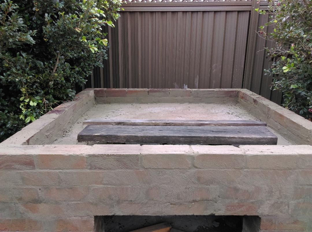

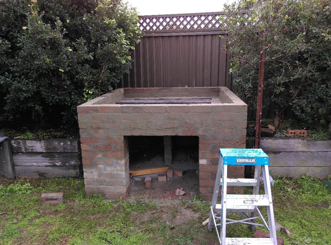

    Hey Guys this is my my "Budget" 42 inch build in inner west Sydney.
    Plan was to build the entire oven with house bricks or other cheap materials as this isn't my place so I cant take it with me.

      Time to update my build:

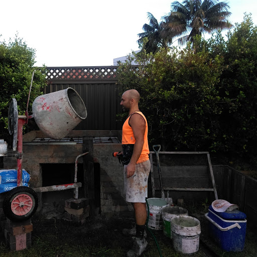

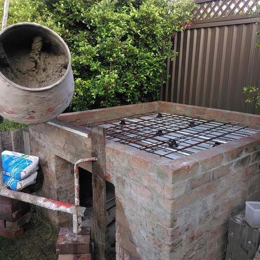

      My Brother in law turned up and decided to get the oven build moving. Thanks Bro!
        Just need to figure out which way to go with the insulation and then its the dome

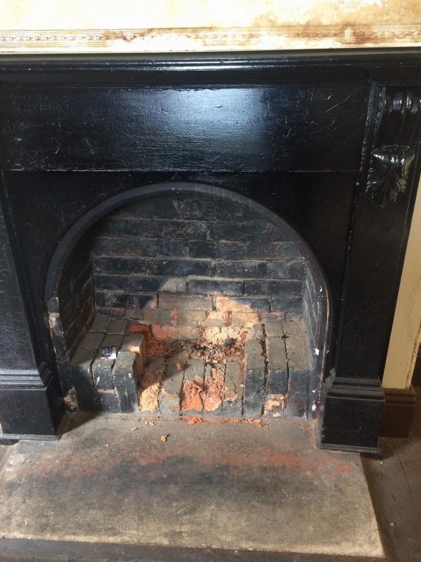

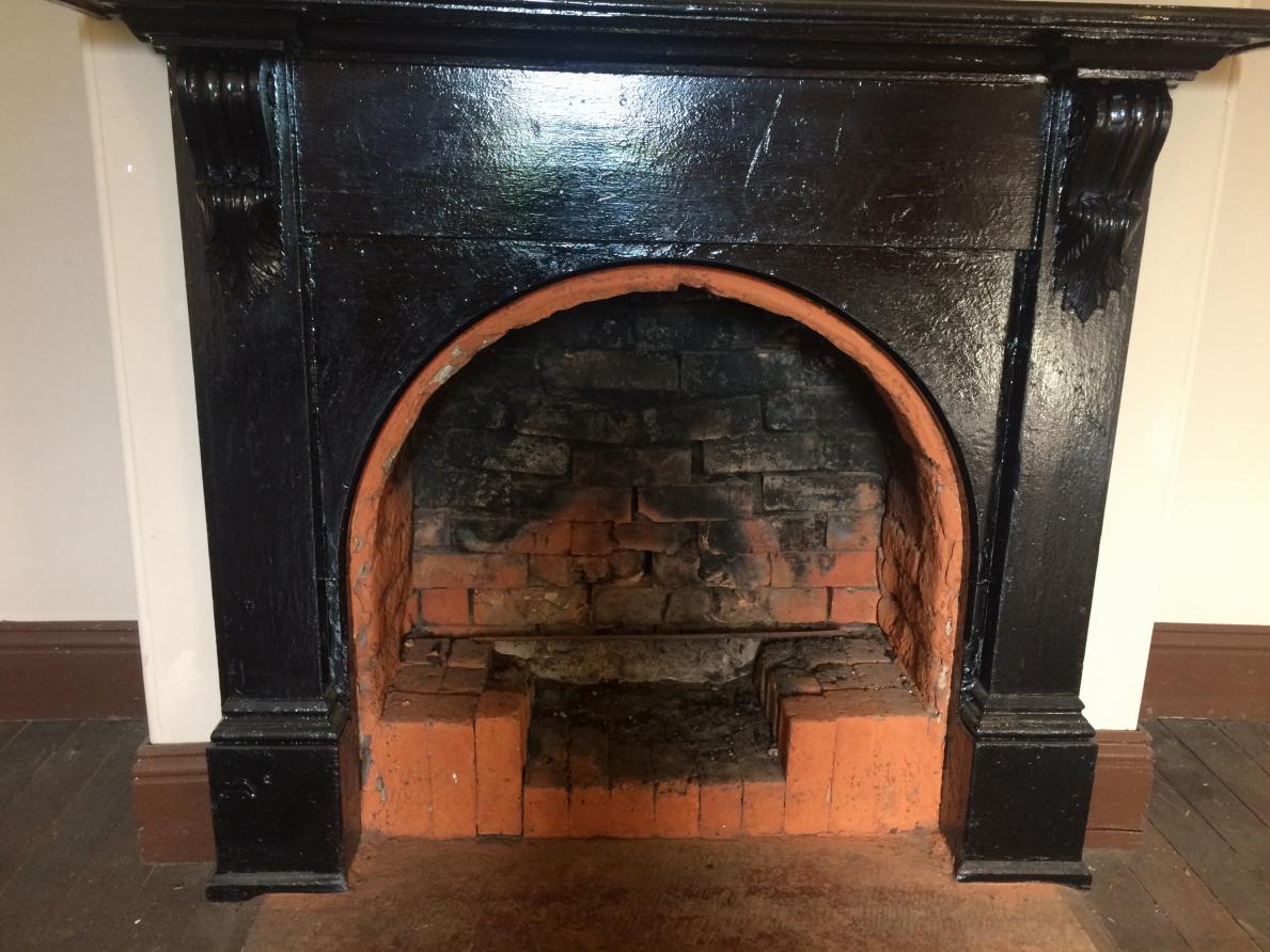

          select your bricks carefully. You need solid bricks not wire cut bricks full of holes. That may mean sourcing second hand old red pressed bricks. Depending on the clay composition they may hold up or they may not and you won't really be able to tell. Generally lighter creamy coloured bricks are likely to be more suitable. For the dome you should be able to get away with them, but the oven floor takes a greater beating so use fire bricks if you can afford them. Forty years ago solid creamy house bricks from Cooroy were discovered to be suitable for stoneware temps (1200 C+), lots of powers got some, I got a pallet of them to build a kiln, but i doubt they'd be available now.Attached are pics of badly spalled solid reds in fireplaces in Tasmania. I've seen the same thing in Victoria, but some oven builders in S.A. have reported good success with solid pressed reds. Sydney ??

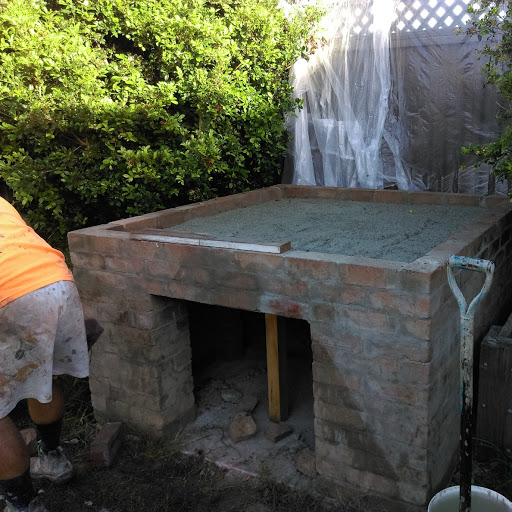

                  Had to add an extra course of bricks to get the required height to give me enough room for the insulating component of my oven. Ended up with 130 mm total thickness. Should be more than enough.
                  For those wondering why i have left it 20 mm from the top is to get a nice flush finish with the oven floor and the outer finished level. The plan is to go with 50 mm bricks which leaves me with 30 mm proud finished level to which the outside tile can marry up to.

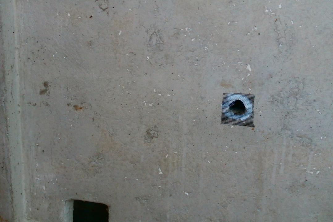

                    If you can, be sure to drill a couple weep holes in the concrete hearth (maybe even come in from underneath) so any errant water can work its way out. Also, let the P/Vcrete dry as long as possible before you place the fire bricks on. P/V crete holds a lot of water so the more you can get out now the easier it will be to cure your oven later.

                        That is a sixty four dollar question on length, depends on your current climate, since you are in Southern Hemi, it is your winter now but you are in Sydney so a little more moderate. Do the best you can in drying it out and keeping any rain from getting on it. Should be okay with size and number of weep holes. This is important since you have the pcrete sunken in around a brick side wall. Water has a way of finding low spots and the weep holes will save you issues later on. I do recall that David S from NSW suggests a couple weeks.
                        • #13
                          I did an experiment on drying vermicrete (attached) and it does take longer than you would think. It will eventually dry but as builders have reported that their ovens keep improving after months, i'd suspect that the damp underfloor insulation is the culprit as it is the hardest place to remove moisture from. Regarding the weep hole(s) attached pic shows how i do mine. The hole is actually square because i cast it 20 x20 mm, I glue some insect screen over it to prevent the vermicrete from falling through. A number of smaller holes should work the same.

                            I went with a 5-1 ratio with the Vermicrete and was quite surprised at how easily it compresses.So i sprinkled some portland cement on the top to give it some more surface strength.
                            Next time I think i will try 3 or 4 to 1 with the vermicrete.
