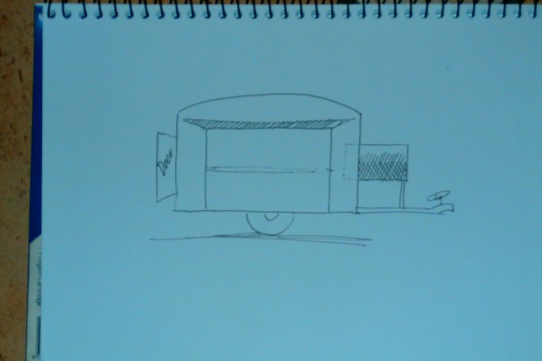

            Hey David, was there oven mounted on a trailer or on its stand? What I had in mind was to use the stand it came with for the markets, but then realized that I would have to wait for the oven to cool down be for I could go home
                Here is a pic from memory as to how he had it mounted. I did get his card but can't find it. Shall look harder and get back to you. Click image for larger version

                    hey David thanks for the effort with the drawing, much appreciated.
