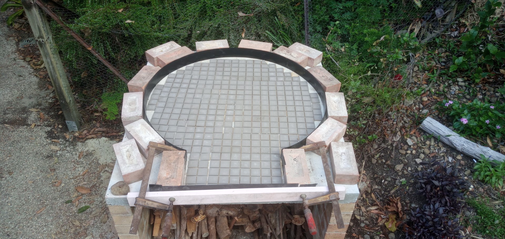

        + elevate the insulation off of the structural hearth.
        What is a good way to do that?
        Gotta say, so far this thread has been almost as helpful as all my other research combined. Thanks!
        • #19
          That depends on what you can source. Some have used 2" concrete pavers. Some have used glass foam block. Some have used mosaic ceramic bathroom tiles that come already spaced on a sheet. The theory is to get the insulation above the structural hearth level where it can stay high and dry. You may be able to find some examples by using the key words "elevating insulation" in a search of the forum. You may have to change the key words get different examples.
          • #20
            Here is an example of elevating board insulation with ceramic tiles. A poured insulation would a require a fine mesh like window screen material or landscape fabric to prevent the spaces from being filled with insulation.
            • #21
              Here is what I ended up doing under the insulation layer on the hearth - the tiles (including lots more) cost me $2 at the local tip recycling shop.
Name:	oven-tiles-under-insulation (Large).jpg
Name:	oven-tiiles-under-insulation-closeup (Large).jpg
              I hope this helps others
