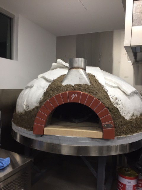

    The addition of perlite or vermiculite to any mix severely compromises its strength and applying a strong render over blanket is difficult because the blanket is rather springy. My solution (and there are many ways to go) is to cover the blanket with a very lean (10:1) mix which results in an insulation layer with equivalent insulation value, per thickness, as blanket.
    I find a combination of perlite and vermiculite (50/50) works better than either of them alone.Once this has dried I apply a 4:1:1 sand, lime, cement render enriched with AR glass reinforcing fibres about 15mm thick. This eliminates the need to use chickenwire.

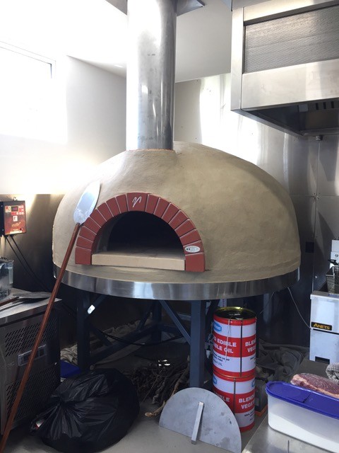

    Here's a pic of a 160 Valiorani I built which shows my method.
