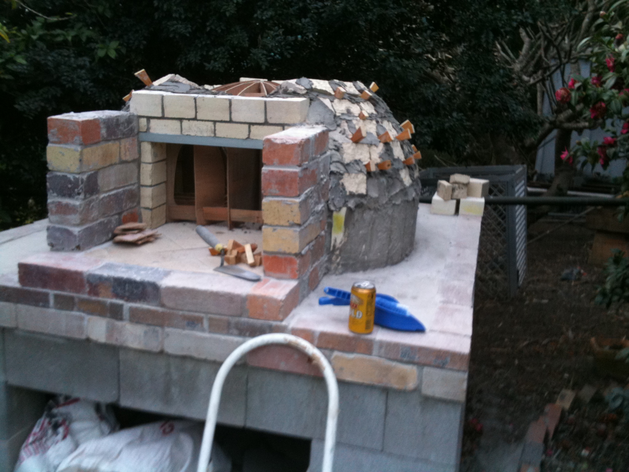

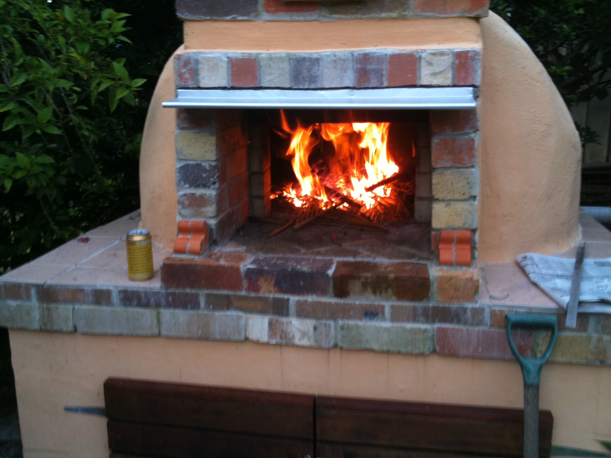

                                #45
                                Re: Tanzania/Canada
                                dear SteveS
                                as a good friend of mine said I a bit "masonary impaired" so a square opening is what I built supported by angle iron as well
                                attached are a couple of photos which might help.... a picture is worth a thousand words
                                construction
Name:	dome construction.jpg
                                and completed
                                As you can see the chimney size is dictated by the oven opening size (check the instructions for yours). Make sure you leave a revel, a lip around the opening, so an oven door can be fitted to seal off the oven.
                                From memory the chimney ended up about 4 bricks wide 2 deep and is 5 bricks higher than the top of the oven door. The slot that carries the smoke is as wide as the oven door one brick thick. It draws well and handles the volume of smoke easily. I kept its height low so it would not be to heavy, any higher and I would have continued with a metal flue.
                                hope this helps
                                Regards cobbler dave
