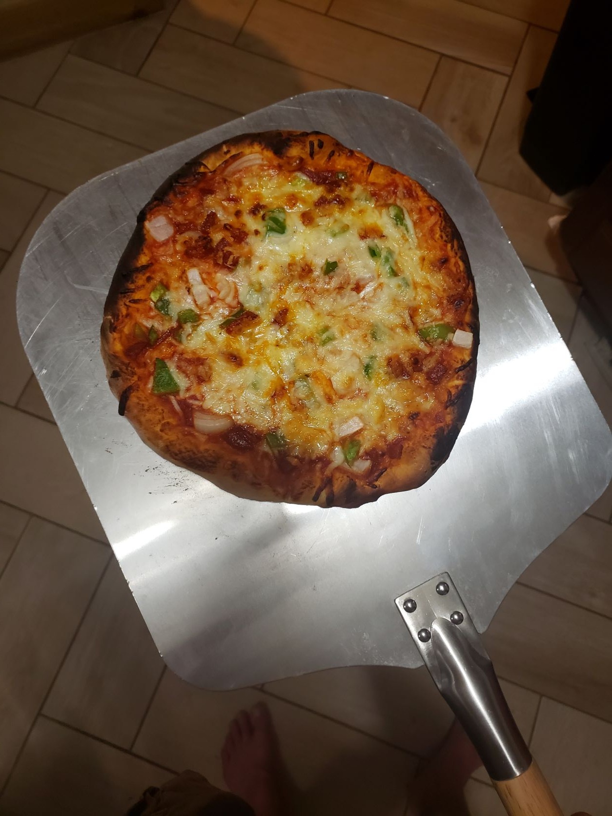

            I'm actually having the same issue. I built a pretty sizeable fire brick oven, with fire brick floor that sits in refractory cement. I also have an iron door with the thought of keeping in the heat. I'm still getting familiar with how to regulate the heat and fire, but am able to get it to around 650 degrees. I'm not sure if I'm doing something wrong, there is a construction/design flaw, if I'm not preheating the oven long enough, or if I shouldn't close the door while cooking. My top and side of crust is cooking much faster than the bottom. The top will burn, but the bottom will be barely cooked (but not crispy). I preheated the oven for about an hour, maybe 90 min. Is that not enough? The oven is a decent size like I was saying. With the fire on the side against the wall, it can easily fit 2 pizzas, if not 3. Here is a picture. Appreciate the feedback!

              Mfacchini , you picture didn't post, so that might help, but what we really need are some construction details about your oven. The floor bricks are embedded in refractory cement - is there insulation under the floor or can heat bleed into the sub-structure?

                You need a strong fire to preheat the oven, but while baking pizza, the flames should be very moderate.
                Either heat the floor hotter, by burning longer and move your fire around, or (probably the easier fix) keep a lower fire while baking pizza.

                  Heat travels slow. Preheat 1 h per inch of mass to saturate. I usually burn 2.5-3 h for a 2" dome and 2" floor mass thickness and it always works. I cook at 850-900 F.
