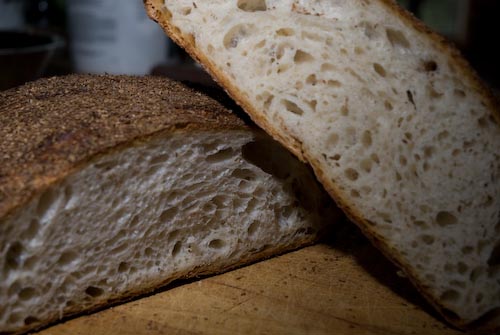

            Round two: Genzano
            I had another go at the Genzano this weekend, this time with Leader's whole wheat version. Once again, I did not use his full, high speed mixing times. I just ran it through until I was happy with the windowpane test. The only real difference this time around (outside the whole wheat addition) was leaving out the gluten flour. Last time I included a tablespoon since he recommended high protein flour and all I had was plain vanilla AP.
            The mixing and rise were similar to before and the final proofed loaf was loose and jiggly. The baking results, however, were more in line with the Genazano descriptions, not the inflated basket ball I got last time . While that was tasty, it was not what I expected! This loaf was flatter with a more open crumb. I suspect it did go in at a bit higher temp than last time. My thermometer batteries decided to die right as I was getting ready to load, so I don't know for sure. At any rate, I do like this bread.

              You can use more bran... The real stuff is pretty heavily covered in bran. Your crumb looks just a little tight for what I would expect OTOH, you used whole wheat and that tightens the crumb so???? I think it looks good. You should have an almost nutty flavor to the bread from the bran toasting. That is a key flavor to the white loaves. Not sure how that translated to the WW.
              Looks like you have cracks in the crust. That suggests you may have been a bit underproofed. I would tend to bake it a little hotter and a little longer. (The loaves in Italy are almost black.) But I know for sure it tastes good! Nice job!

                Re: A try at Genzano
                Thanks Jay. My best guess is that the temp was probably about 580 when it went in, so I don't think I would kick that up, but the time could have gone longer for sure. I ran about 30 minutes and 50 or so is recommended. The last one did go longer. The bran was there, but some brushed off or broke out around the cracks. Definitely has the nutty flavor to it. Hard to judge the proofing I guess. I did the finger poke test and it was pretty slow to spring back. I'm game to try the white flour version again too.
                The crumb is perplexing to me. This dough gets minimal manipulation: one fold at 1 1/2 hours, shaped at 3 and proof for 1 1/2-2 hours. Loading is a straight dump from the collander to peal. Going in it sure seems like there are larger bubbles in the dough.

                  This is directionally a dough that you want to have on the overproofed side - much like Pane Pugliesi. (Pugliesi is poked down with fingers to give it room to expand. Since they don't do that to Genzano it is best to be over and have the absorbed gas level in the dough declining - so you don't get a violent expansion/rip). As an unscored loaf it needs to be over the hill enough it doesn't explode. Looks like you probably judged right (by my taste) for conventional rustic loaves but may have been a bit early for Genzano. The extra proofing will also help give a more open crumb.
                  I agree on temp. 580 is hot enough. I think this bread benefits from longer bakes. It is SO wet that you could bake it forever and it wouldn't dry out. (okay, exaggerated but...)
                  But the extra baking/browning will add a nuttier flavor to the loaf.
                  I am going to guess that a part of your denser crumb arises from being on the underdeveloped dough side due to your short mix. When I have made Genzano I have mixed all the way per Leader and the resulting loaves have been really robust to handling. Your lower mixing is likely to yield less robust development which may lead to loss of gas at forming. You can probably shorten your bulk ferment a bit if you want to which will lengthen your prooof and should give more open crumb.
                  I think a better idea would be to do S&Fs at every half hour for at least the first hour. As wet as that dough is you can probably do it for the hour and a half with no problem. That will give you a more developed dough and better gas retention. (Just quit S&F whenever the dough gets too tight/starts to tear or "lock up" (i.e. you can lift the dough ball in the stretch phase).
