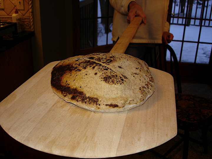

            I found that I got better results with a rolling pin. The hand stretched ones don't reliably blow up for me, but if they are rolled out I get baloons every time. It's into the really hot oven until they just baloon, flip them over for 10 or 20 seconds, and out. Don't try to brown them: they should be soft and tender. You have to brush really well because pitas seem to pick up more floor crud than pizzas.
            I use a 50-50 whole wheat/AP dough. 250 grams of flour (1 yeast 5 salt 155 water) yields four turning peel sized pitas. As ttriche says, they make a real show.

                  I gave this a try tonight with dmun's formula with 50/50 AP flour, whole weat. I didn't plan ahead and do an overnight cold retard in the fridge like I often do with pizza. Just mixed up the dough, a few hour rise, shaped into 165 gram balls, rest about an hour. Then rolled (yep, I brought our a rolling pin!) quite thin. They dough rolled very easily, but sprung back to a smaller (subsequently thicker) shape when I transferred to the peel.
                  It still turned out fabulous. I slid them in a very hot oven (about 900 F). They ballooned up perfectly with a little char. As soon as they were ballooned, I flipped them, let them sit another 10 secs, then pulled them out. The entire process was less than one minute. As others have mentioned, the visual effects are a real crowd pleaser. The taste was better than any I've had before. I can see myself making these VERY often.
