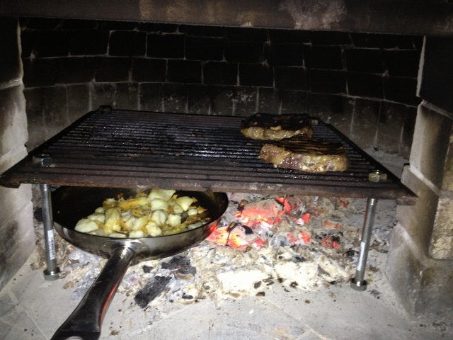

      Well I seem to have the Tuscan Grill to the stage when I can stop experimenting on the family and use it on the guests. Mk 1 I used thin bolts so they would fit through the grills. Wrong move they buckled after the first use and I found them a bit short. The eldest likes his meat well cooked and by the time the inside was cooked the outside was a bit flamb?.
      Secound set of legs are 1/2 in thick and 6 in long which seems to cook a little slower and suits the amounts of coals you can get for a 1 hour burn.
      I lost a few arm hairs the first time but a twenty inch pr of tongs you can keep the hands from the burnie bits.
      Show is just a couple of simple steaks and some pan fried potato, but I have also cooked lamb chops and a butterflied lamb another time.
      All in all I recon this is a great way to cook the flavours great and the meats tender. Feels a little strange working in a still black oven though.
      Regards Dave
