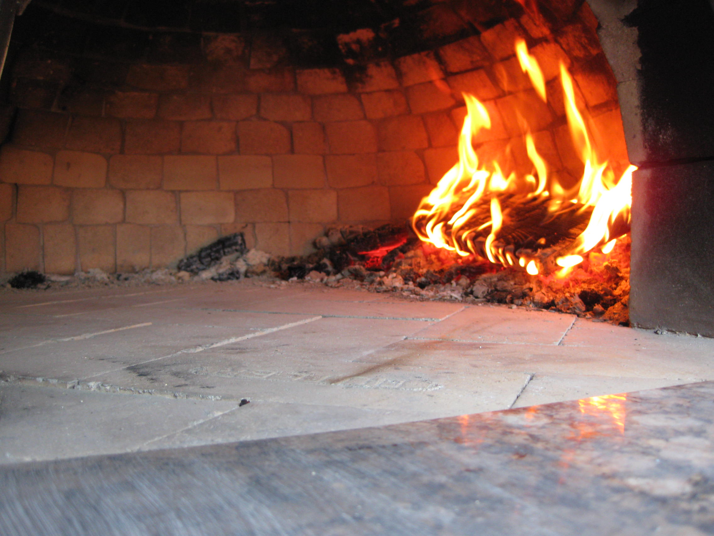

I built a smallish fire and let it heat over two hours time. The dome began to clear a small circle at the top around 750 F and finished clearing about 850-900 F. The peak oven temp was 950 F -with peak floor temp about 875 F.

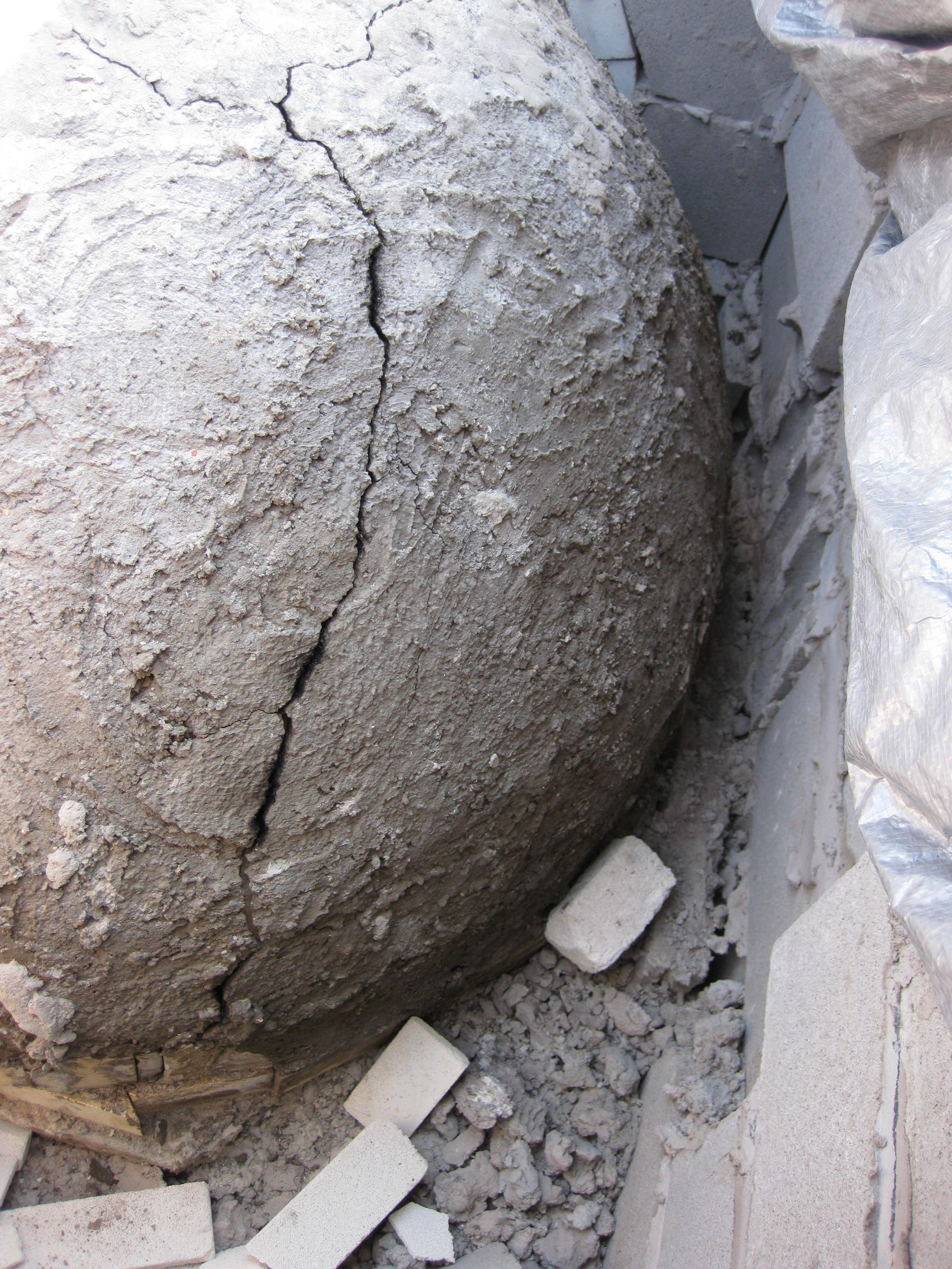

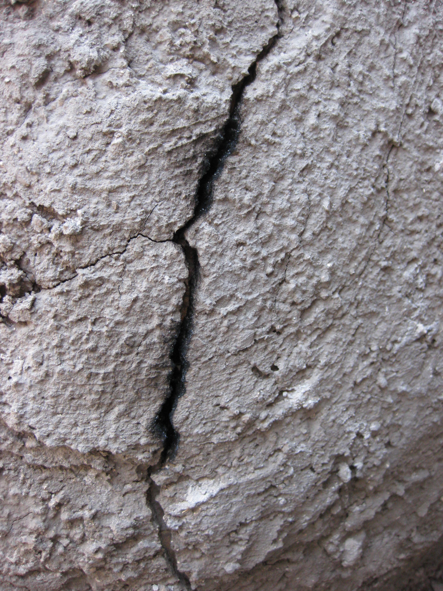

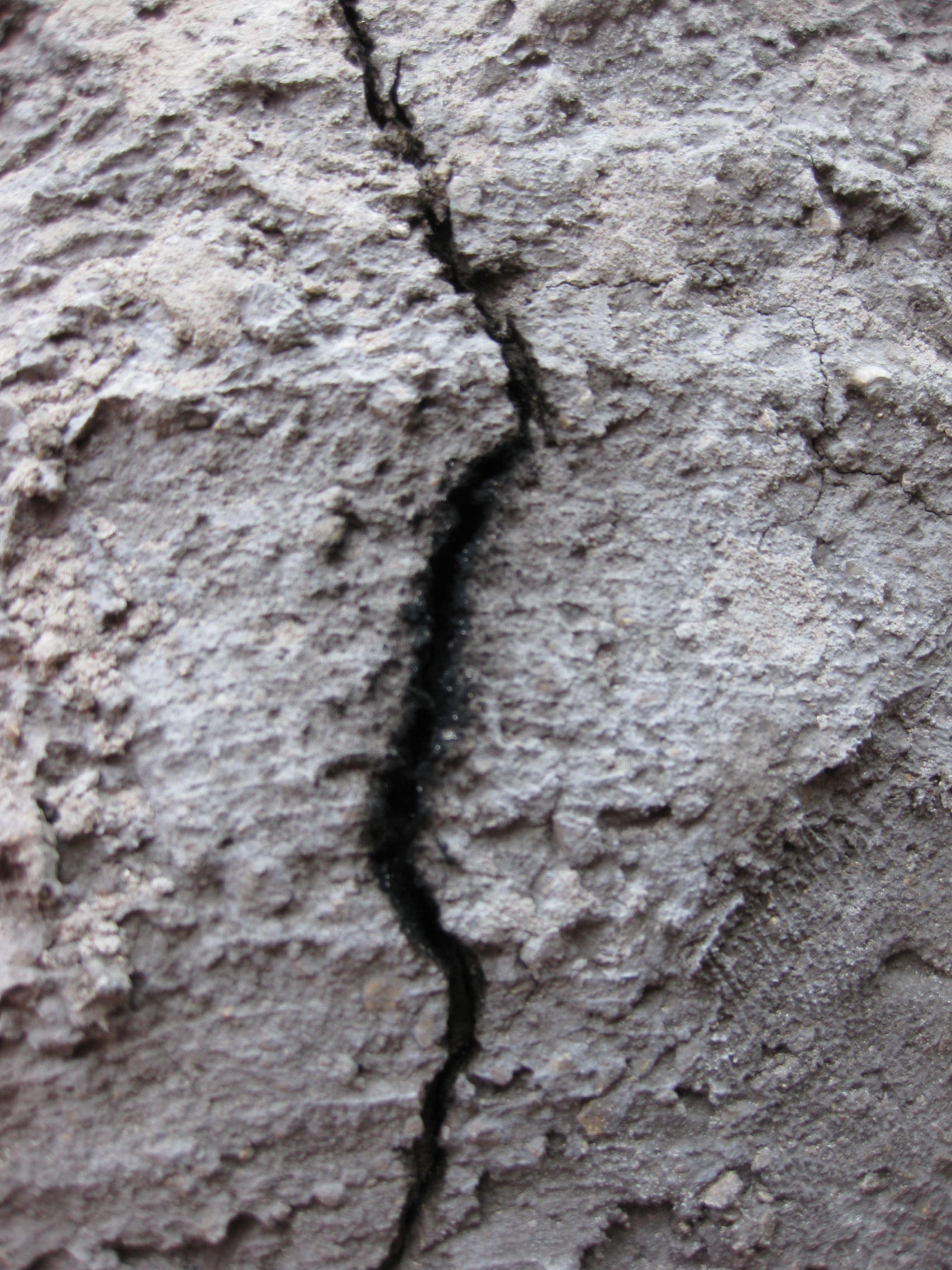

Was good to see the bricks in the dome again, except for those cracks
I realize now that those cracks don't affect the cooking and it seems the oven won't fall down
First pizza was less than two minutes (floor temp was over 800 F).
