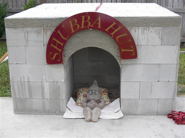

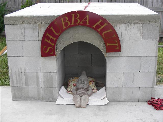

              Re: Name Plate
              I had my fabricator cut this from 1/4" aluminum. It's two pieces held together with brass screws. Each piece was powdercoated seperatly. This and the Nome will be mounted above the arch opening for the oven door.

              • Wiley
                • Mar 2008
                • 804
                Re: Name Plate
                Djrljr,
                Aluminum plates with brass screws? I expect you will see some corrosion due to galvanic action (sometimes called electrolysis). I might suggest you consider switching the screws to cadmium plated steel or even stainless steel (with thin layer/coating of grease if using S.S.)
                Hoping to help,
                Wiley

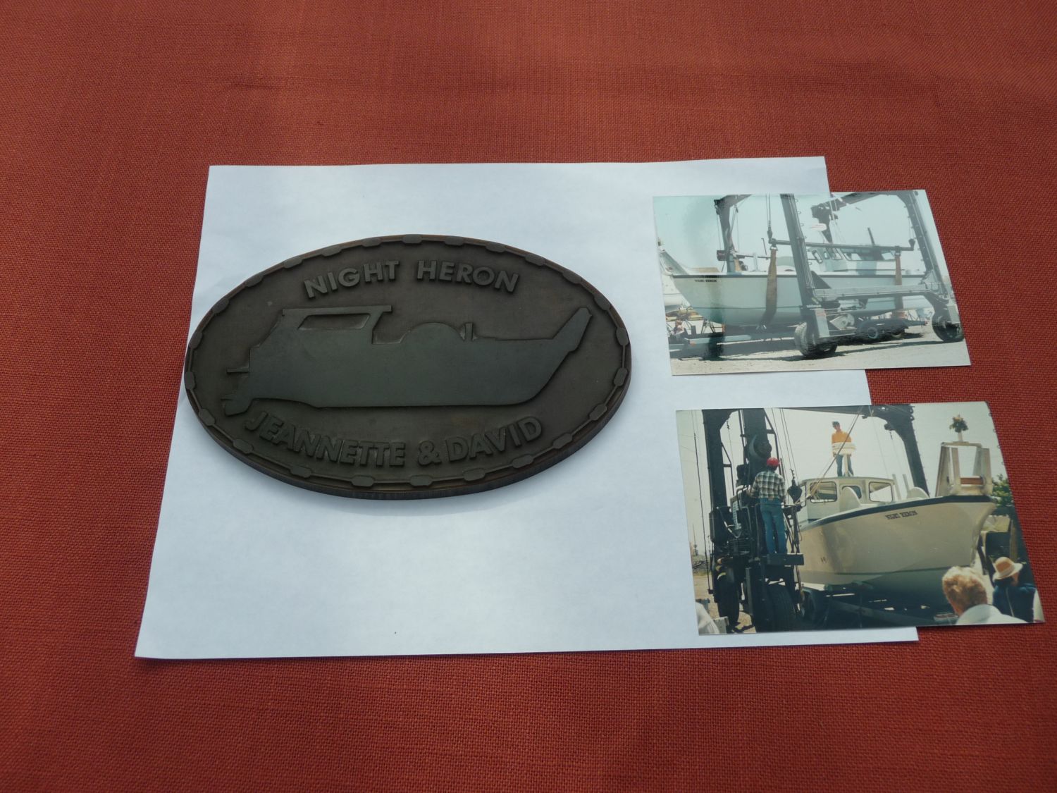

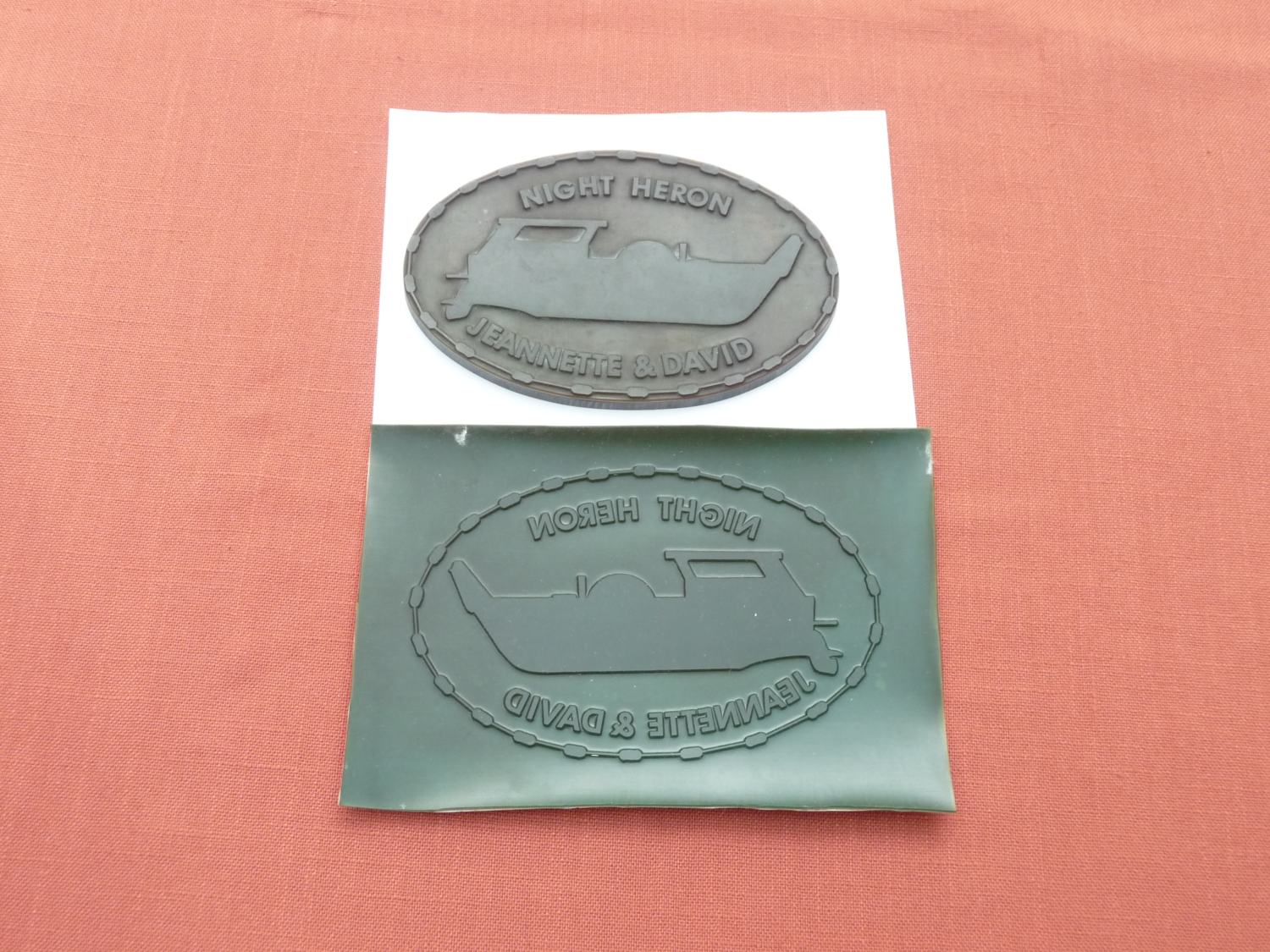

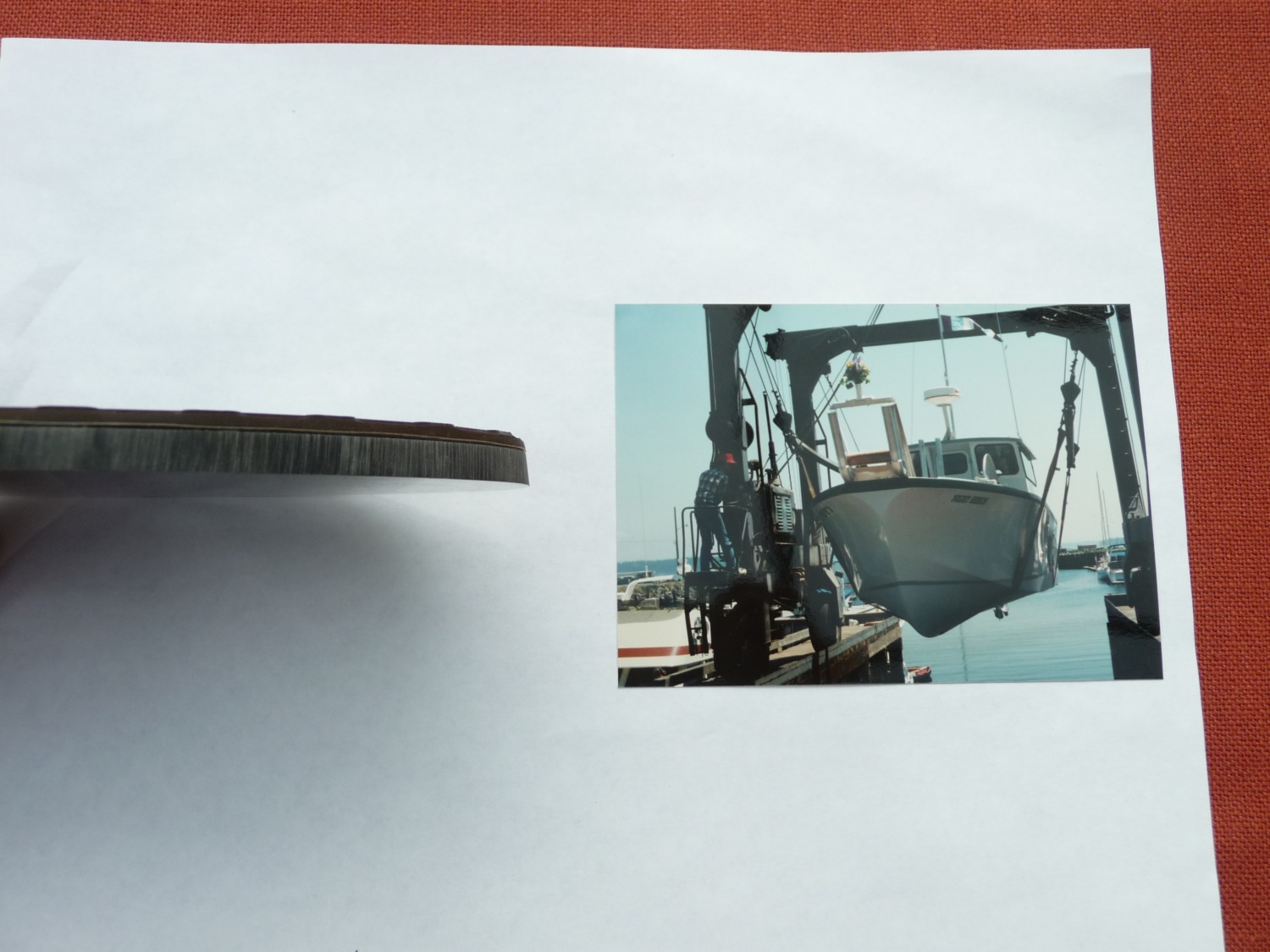

                • Wiley
                  • Mar 2008
                  • 804
                  Re: Name Plate
                  chidding,
                  Here's some photos of what I did. Unfortunately I cannot find any photos of the plaques installed but I added some photos of the boat at her launching. They were not finished in time for the launch. This was back in 1989 and the pattern was the photopolymer cut mounted upon a piece of plexiglass. I added a photo of the edge view so you can see the pattern needs to be beveled on the edge to have some relief so it can be easily removed from the sand.
                  These were cast in sand and then gently belt sanded to flat the top surface. This was before I became a hobby printer and so I was not aware of the detail one can actually get using photopolymer. The detail limit is determined by the medium (sand) and the skill level of the person making the sand cast.
                  Photopolymer cuts cost about 50 cents a square inch unmounted (figured to the nearest rectangular shape). If you go this route be sure to make clear to the maker of the cuts what you will be using them for. I have included a photo of a right reading and wrong reading cut. In spite of lengthy discussion with the cut maker he still made the cut wrong reading, then realized his mistake and remade it before I picked it up. All you would need to supply to the maker is a black and white positive of what you want. He will make the negative etc.
                  Another idea if you know anyone into ceramics is that you could have the photopolymer cut made wrong reading (as if it were to be used as a stamp like they usually are used) and then impress this into a sheet of ceramic clay. Simply roll out the clay as if you were making cookies and then lay the photopolymer sheet upon the clay and gently roll it in with a rolling pin; remove dry and have it fired. That is one way alot of the hobby ceramics people make those cute signs that one sees for the garden. If you go this route you want the clay as dry as possible and still workable otherwise it will distort when drying.
                  You will notice the pattern says "Jeannette and David" I took the screen name Wiley when I joined three years ago because there were lots of David's on the Forum.
                  Hope this helps,
                  Wiley
