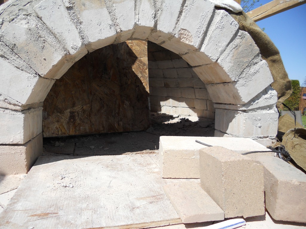

Starting a 42 pompeii

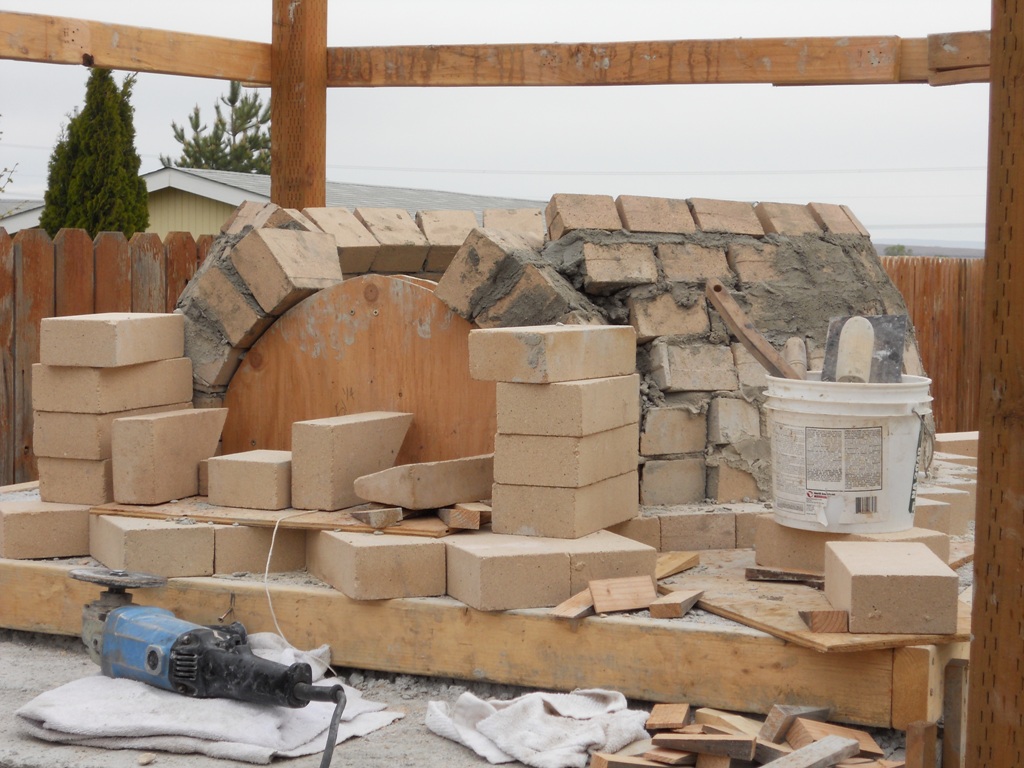

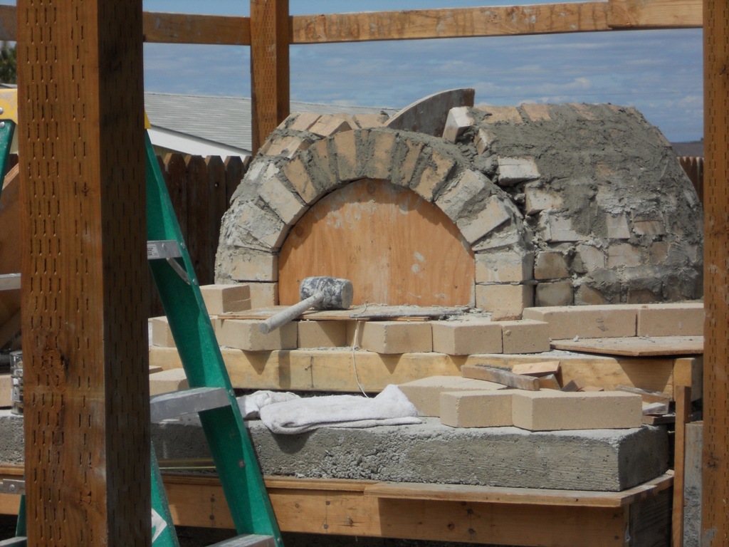

3 PhotosMillwrights can fix anything but the break of day and the crack of doom. We ought to be able to build an oven. -

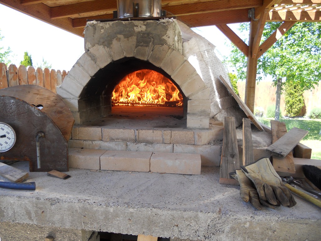

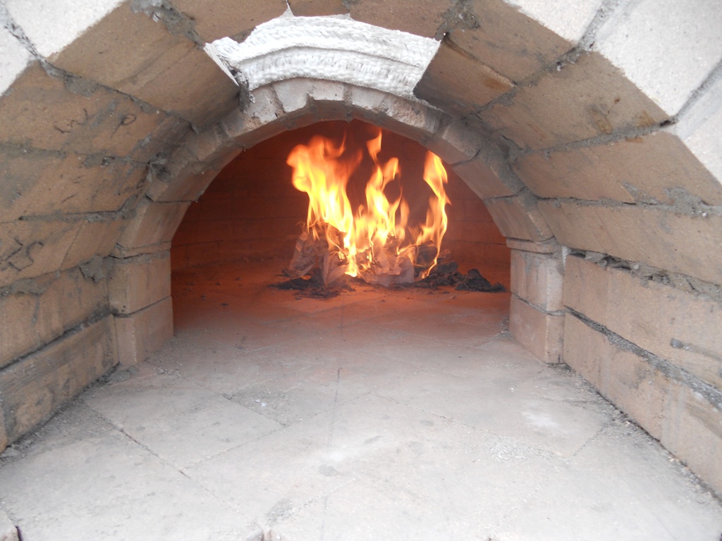

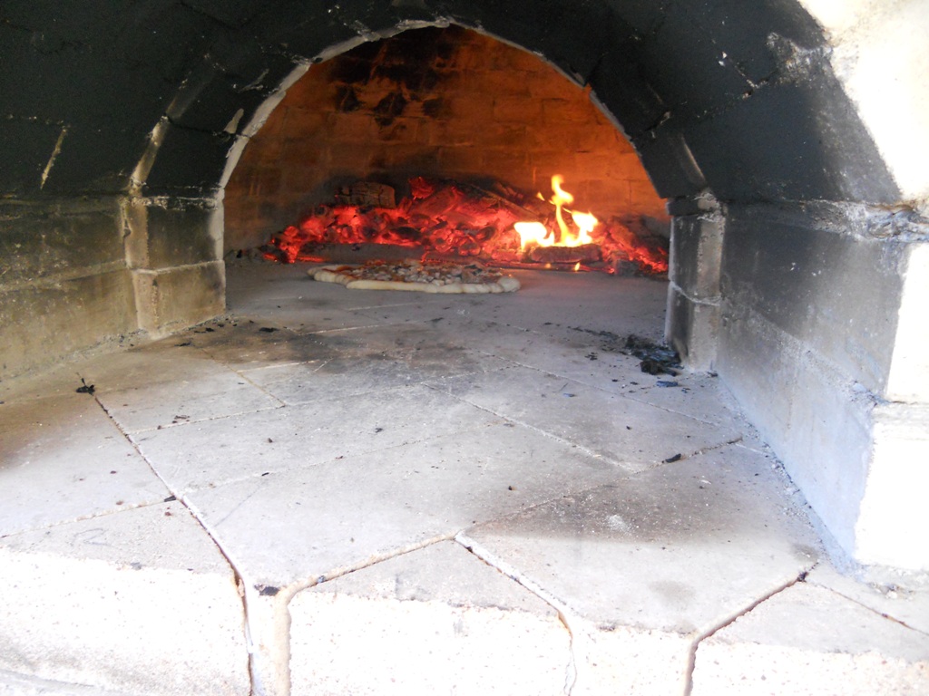

Finally the first fire. Lots more to do after this but I am starting to dry out the oven. I found a couple of cracks on the outside but no smoke coming out any where. I am working on everything around it now especially the roof I have to get the mostly finished so I can insulate. I try to do a little bit everyday. It won't be long before pizza and bread.
boiler bob1 PhotoMillwrights can fix anything but the break of day and the crack of doom. We ought to be able to build an oven.Comment

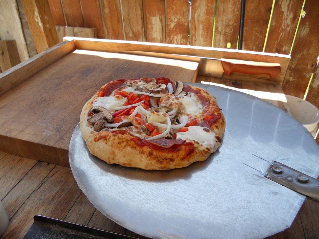

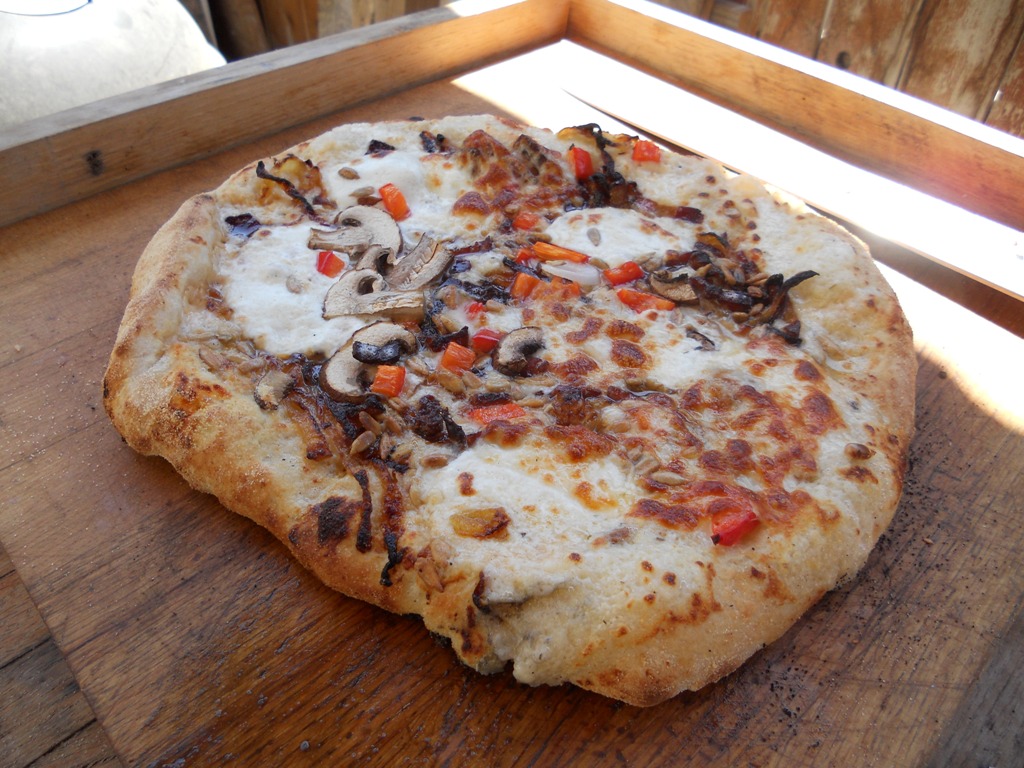

I have made a few pizzas we have done about 30-35 pizzas so far plus bread and rib roast. Everything has turned out better than expected. There is a steep learning curve about firing the oven. the key is to get good clean wood. and get it going quick so it doesnt smoke and bother the neighbors.
