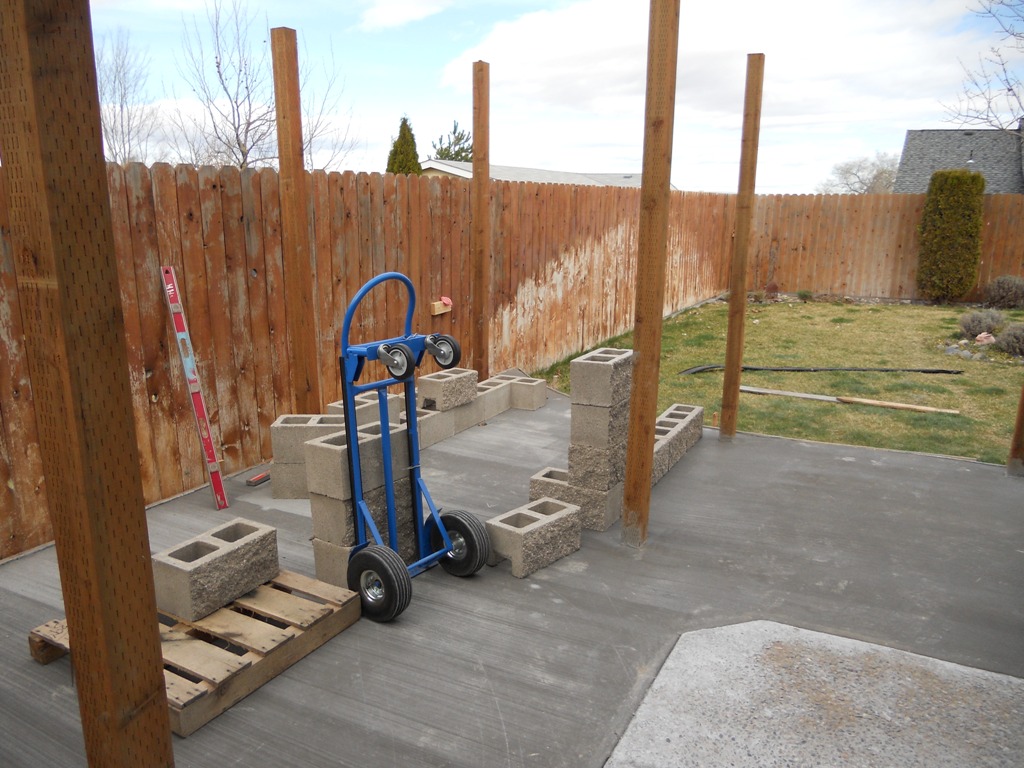

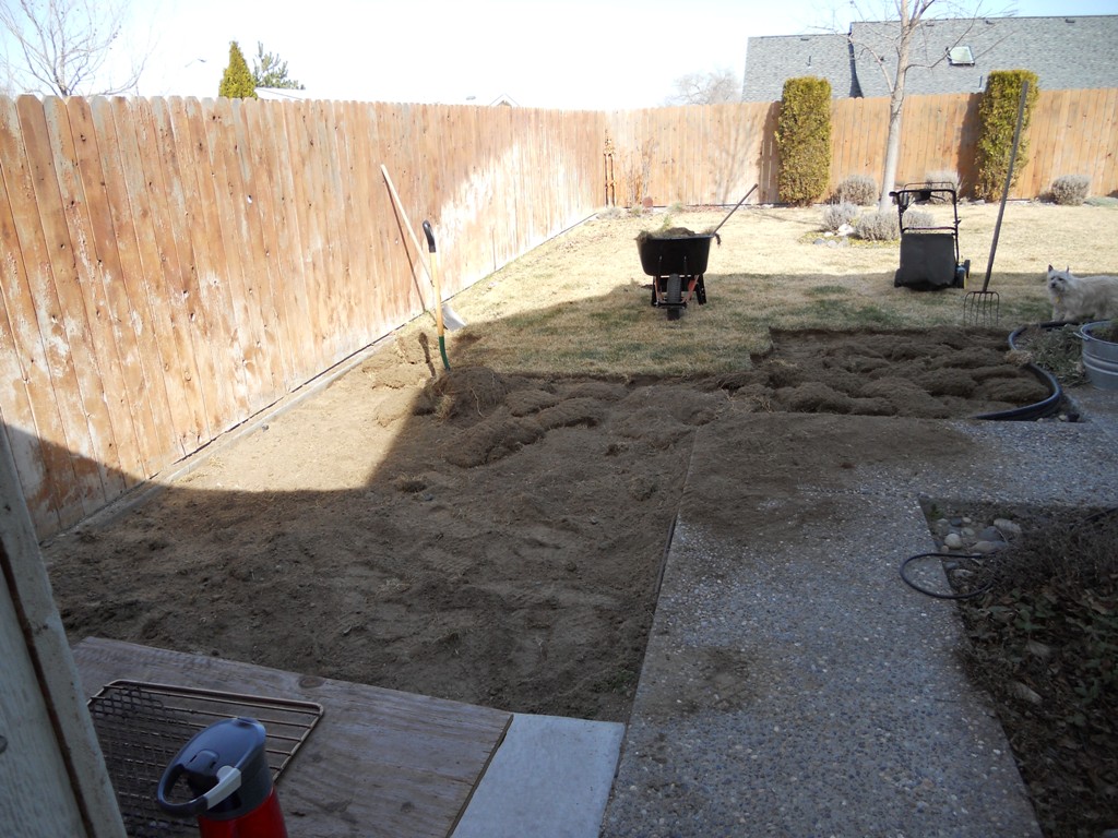

The slab got poured the other day so I started lining out the block today. Have to work over the weekend. so will start mortaring on Monday. I have been reading the forum for three or four months now and I am as ready as i will ever be. It took quite awhile to find sources for all of the material. I got most everything lined up. Reminder to all the price of everything is going up because of fuel prices. Thank you all I will post pics. as I go along.

I am going to make it 5 blocks high and leave it open at both ends. I will pour a lintel over each opening. I think I will use home brew mortar and perlecrete under the floor.Millwrights can fix anything but the break of day and the crack of doom. We ought to be able to build an oven.Comment

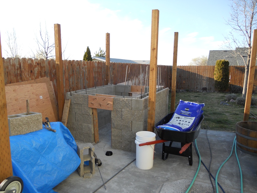

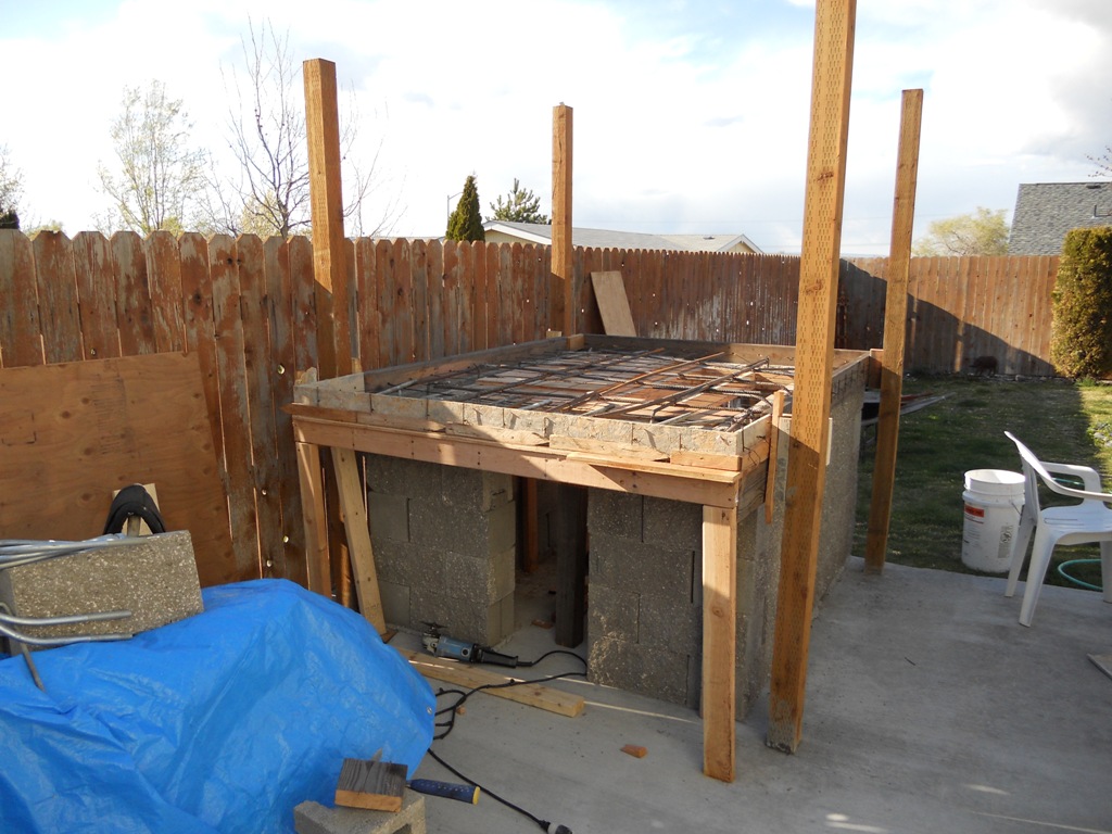

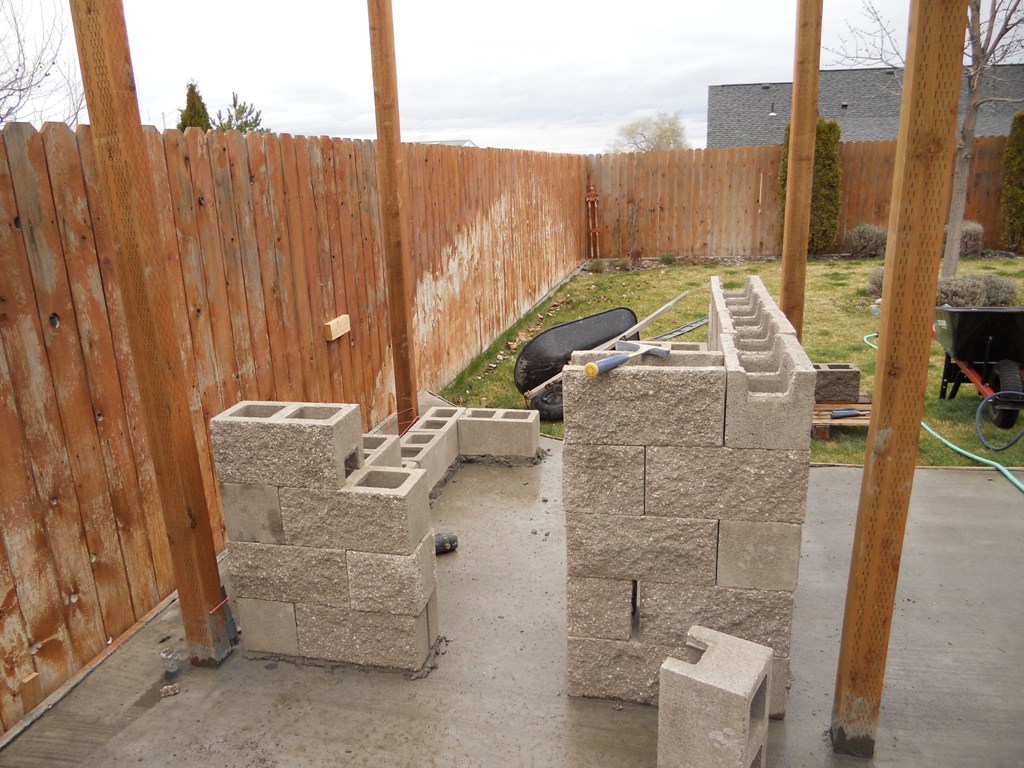

Re: Starting a 42 pompeii
Thanks for the pics. I will Download a pic as soon as I can. I got the blocks all stacked and am ready to pour the voids. Should I leave a foot of rebar out so I can bend it into the hearth slab? We are having crappy weather wind and rain, so I work when I can. I think oven builders are a committed bunch, ah, for the love of pizza.Millwrights can fix anything but the break of day and the crack of doom. We ought to be able to build an oven.Comment
3 PhotosMillwrights can fix anything but the break of day and the crack of doom. We ought to be able to build an oven.Comment
It looks like you are golden in your planning for the rebar. Just bend it over and wire it to the horizontal rebar for the hearth and you'll have a strong and unified perch for the ovenThanks for the pics. I will Download a pic as soon as I can. I got the blocks all stacked and am ready to pour the voids. Should I leave a foot of rebar out so I can bend it into the hearth slab? We are having crappy weather wind and rain, so I work when I can. I think oven builders are a committed bunch, ah, for the love of pizza.
