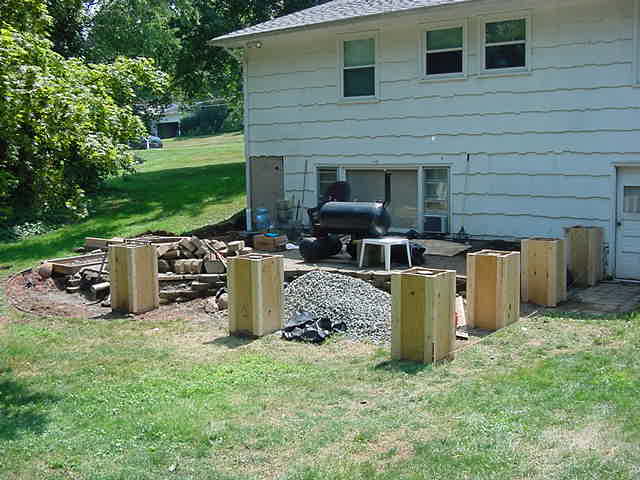

    Ok so I've been trolling this forum for months now. I've also been researching and reading as much as I could about WFO's. I actually tried to hire 2 or 3 masons to build it for me but none ever returned phone calls. Go figure. I am quite handy. I build decks, patios, sheds, garages whatever but masonry (NO EXPERIENCE AT ALL!)
    After viewing numerous pics on this forums, reading the FB build instructions and watching some youtube videos I decided to give it a shot. Many thanks go out to this forum and particularly ken4pizza's youtube video on dome construction. I decided to remodel my entire patio to include a new firepit, my existing meatsmoker, a brick oven, and side counters. Here's the progress pictures...

    That is a good start on a BIG project
    There is enough help here on Fornobravo.com to boost you over those tough spots that will come up. Keep up the good work!
    What insulation are you planning for the floor of the oven?

        The hearth and floor are already complete. I followed the FB instructions and did a 3.5" remesh structural with a 4" vermiculite/portland insluting layer. Hopefully it is enough.

        I bought two rolls (50SF each) of 1" thick fiber blanket for the outside. I was going to coat over that with a 2" layer of vermicrete. Do you think this is enough? Also wont the weight of the vermicrete compress the insulation thereby rendering it less effective?

              Sounds like your insulation plan is great!
              I wouldn't worry too much about the touch up work unless you want to do it for aesthetics. Once you insulate, you'll be in good shape.
