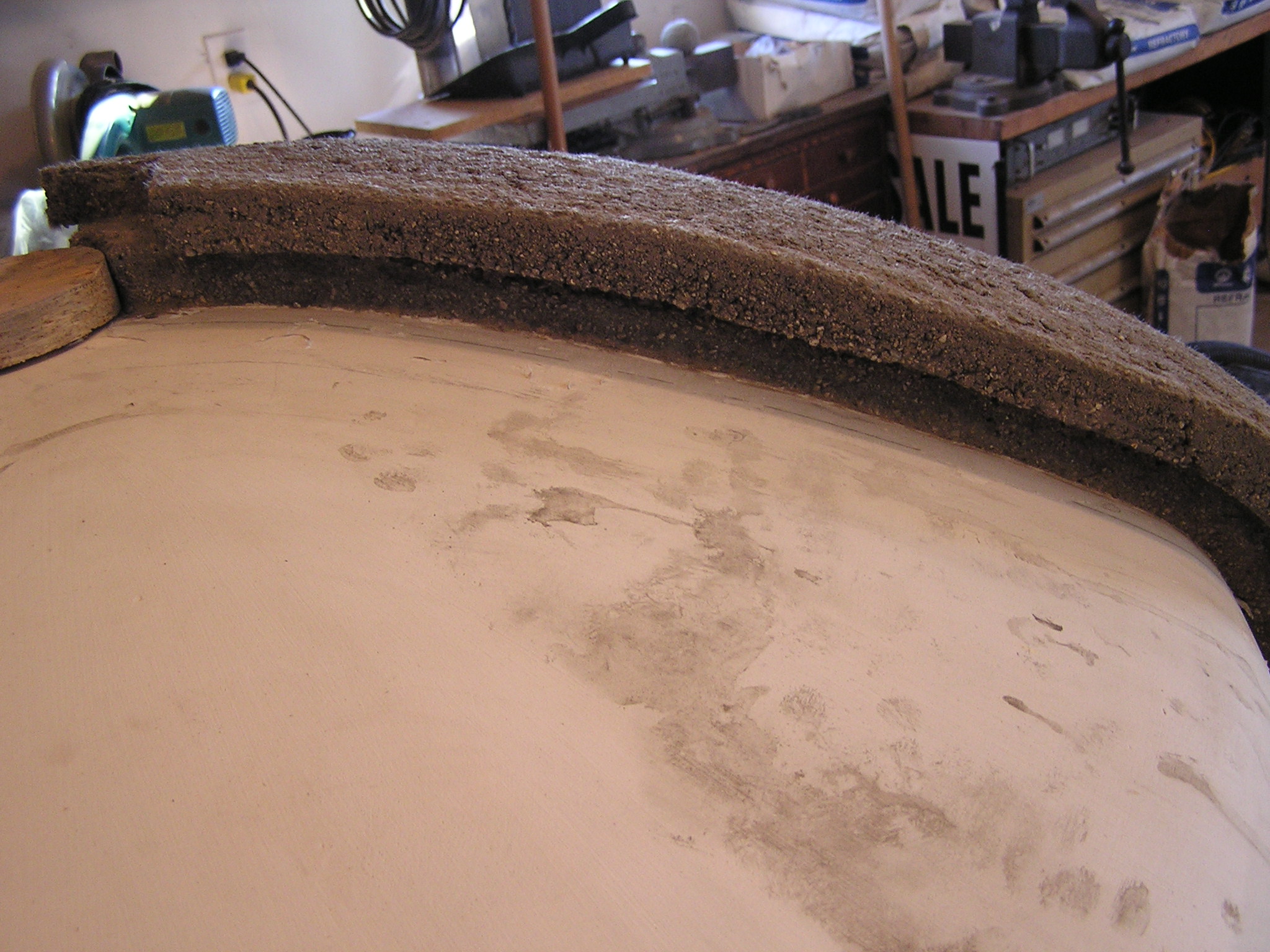

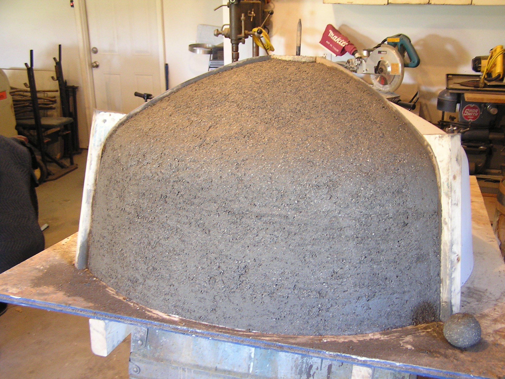

    well there were no comments on my mold, maybe the actual oven will get some
    showing the interlocking of the quarters
    ready for next quarter
    the first and secnd quarter of the dome cast 2 inches thick, high density refractory 130 lbs per cubic foot

        Re: casting the pizza oven
        actually I set the first piece in place, wife balanced it, placed second one held itself up at that point. placed third and fourth piece wiggled it around and it all came together. the first piece was the entry so it almost was balanced

                      I know this is an old thread but this mold is amazing. Im hoping Iron pony will respond. Im wondering (well Im wondering a lot of things about this casting but right no im wondering what the material is that was used to make the revel on the sections. I mean the thin piece is either luan or Masonite but Im wondering about the thicker piece attached to it. If any one knows I would greatly appreciate it. I believe this will be the mold system I use it seem perfect for my needs.
                      Thank you

                        I did my casting couple of years ago in a very similar fashion. I used a styrofoam sheet for the "revel". Cut it to the size and since it's bendable you can just glue it to the form.

                          Thanks Tiggi I was so frustrated with this site after posting that I have not been back till now. I am ready to build the form its going to be a duplicate of Iron Pony's as far as I can tell its the perfect from. It would be great if you could share any changes you made to yours and if they were good decisions or not. You can just PM me for now I want to start a build thread but just cant do it today. Thanks for your reply on the revel.
