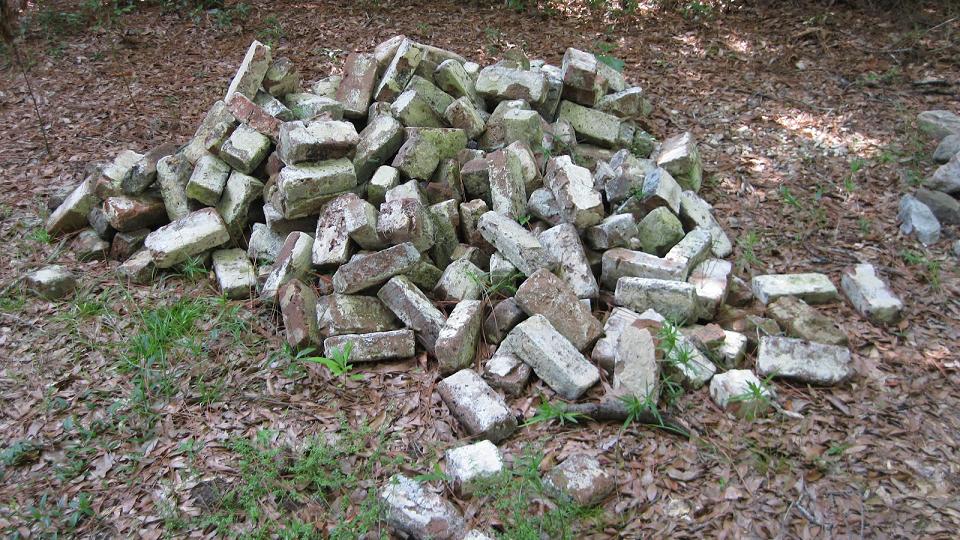

  • V-wiz
    replied
    Re: 42" Brick Oven & Grill in Los Angeles.
    Top layer done
    http://i46.tinypic.com/29e3f50.jpg
    Starting the red bricks/chimney
    Inside the chimney, yes it was cleaned up.
    And here is the chimney, i plan on installing a granite counter/shelf in front of the entry, i have lots of left over granite from my kitchen remodel, so these will go to good use.

  • V-wiz
    replied
    Originally posted by stonecutter View Post
    Those are nice! Are they antique? I used handmade, antique reclaimed brick for the pointed vault on my current build. Here is a pic..
    [ATTACH]34522[/ATTACH]
    They are very irregular, no two are alike in length,width and thickness. Even the hardness varied brick to brick. It was almost like doing stonework..almost.
    Those are nice..
    All the bricks i have are antique. Most vary in size but im not sure if they are hand made.
    These bricks were removed from a fireplace built in the 40's.
    These bricks are Simon Bricks, they were made in 1903. They were removed from a house 25 years ago and it was originally off a house built in 1905.
    There are a mixture of bricks here, some are the simons, some on the left are unknown and some are the ones i cleaned up.

  • V-wiz
    replied
    Spent some time the other day cleaning up the re purposed/vintage bricks i picked up for free. They have so much character. I had to remove the mortar and sand, using a hammer, Spackle and wire brush. You can see all the mortar and sand ive removed.
