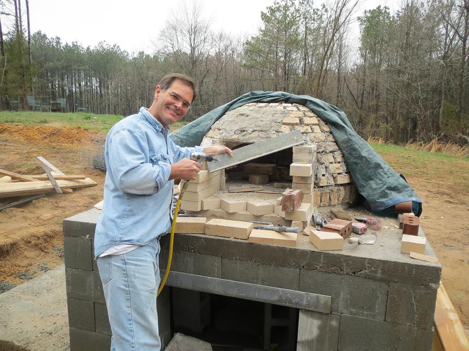

            My daddy always taught me, he said "mikey, never force anything, just get a bigger hammer"
            Well, I have never ordered pizza with zinc fumes on it at the pizzeria, so I figured I wouldn't offer it on my menu either.

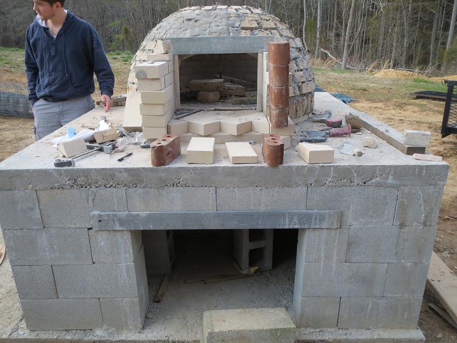

            Harbor freight has a pneumatic hammer with the attachments. My brother, who is the "toolman", just happened to have one in stock. Go figure. He has everything. AND, it has never been used!!! Perfect for removing that big ass piece of galvanized angle iron without destroying my baby.

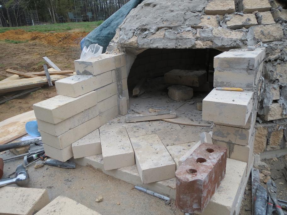

            I hooked it up to my air compressor and within minutes, I have a new hole that is unsupported.
Name:	get a big freaking hammer.jpg
            What do I do now, I need some serious help.......please?
Name:	no support.jpg
            I'm out there, and I'm loving it! (that's a Seinfeld tv show reference to going camando for those that don't know )

              You probably need to build an arch to support the opening, also, your little reveal pieces will just fall off over time like they have now.

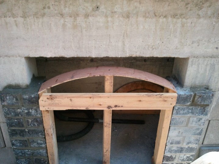

                I took a pic of a cut out for the arch, with a height of 12.5". Can I build an arch that is that thin at the top, or do I need to make the opening smaller? What is the thinnist keystone I can have at the center of the arch?

                  You could always cast the arch.

                    Casting would be a good idea, but you should be o.k. if you go with firebrick. Don't forget to cut your form a little less than the total height of your finished arch, then use wedges to raise up the form. When you are done with the arch,pull the wedges out, the form drops, and you have an arch.

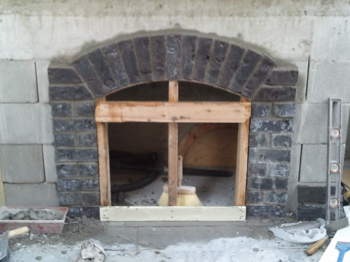

                      You could try something like what I did with my firewood storage area. I built an axed arch as a decorative finish that had to fit into a square opening, and was surprised by how sturdy it was, even using voissoirs (love these brickie terms!)

                      You could do the same with the bricks on their long side. Cut to fit the square shape from the back ~2-3 inches of each brick to fit into your oven opening, but have the strong part of the arch built with the rest.
                      kind of convoluted, I hope it makes sense.
