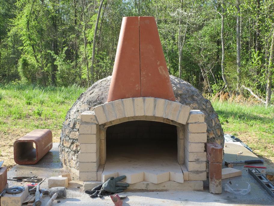

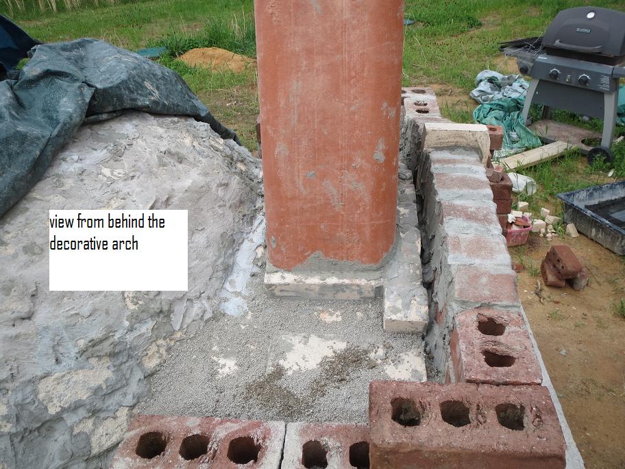

        Here are some photos of where I am at, having completed the decorative arch and filled the sides with v crete to help support/buttress the vent archs.
        Here are some side views to orient things better
Name:	inner and outer arch view.jpg
ID:	294331Click image for larger version
Name:	suggestions needed to finish.jpg
        As you can see, I am stumped on how to build the chimney.
        Do I start on the inner vent wall and go up, or continue up on the outside decorative wall? (Wont that look too big and wide?)
        I also had a thought of getting the next larger flue size, inserting that over the flue I already have, and just fill the space between the two with vcrete as an insulator. Any thoughts?

          #109
          Re: 42" build in Virginia
          Stay on the outside brickwork, you could step each course in if you feel it will be too big.
          Step each side in but leave the front and back flush, as you step in go until you just cover the hole in the brick (measure each side to make them look the same).
          Step it in until you think its right and then go flush for the rest of the chimney, dont forget to make sure it works full bricks before going flush upwards as cuts in the middle of a chimney look ugly.

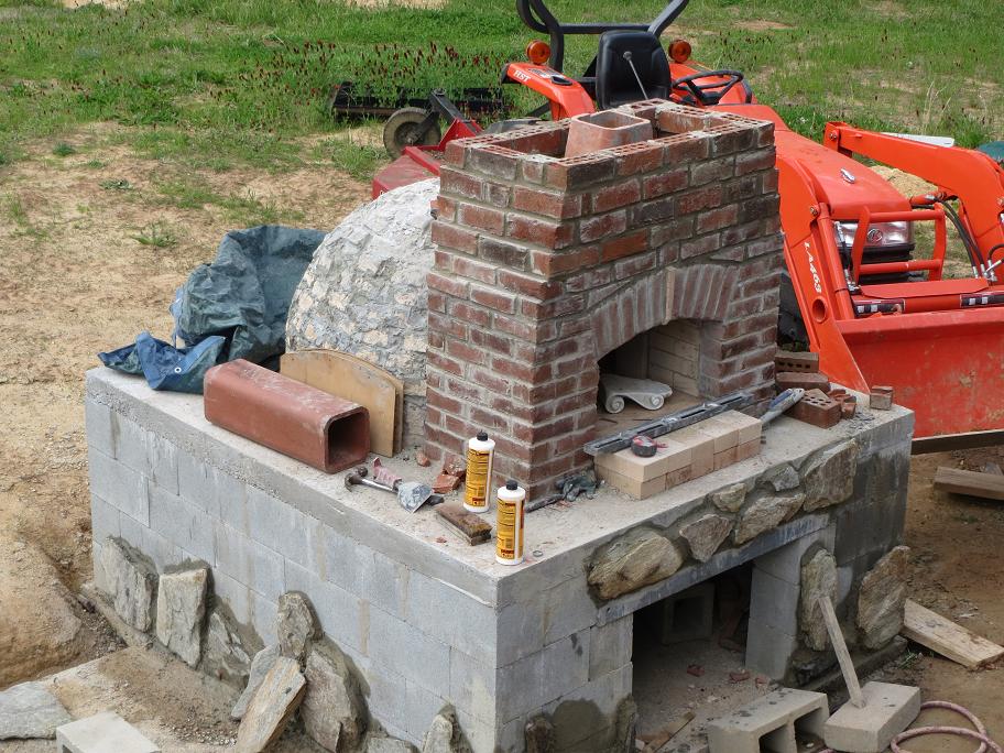

              Well, I had a busy day. I added a couple courses of chimney, and now I'm trying to locate some help on trying to seal off the top. Do you think I need to go higher and add another terracotta flue?
Name:	how to top offf.jpg
              sorry about the crappy brick work. I started out with one size brick, and then ran out and had to switch to another. both were from a stack that was leftover on my property.

                #112
                Bigger is usually better. I went up 24 inches and it draws pretty well. How high is yours?
                        I am somewhat perplexed on how to close off the top of the chimney. I was thinking of filling the space with v-crete,then a paver brick over the top course of the chimney, and fill the top with concrete.

                          #117
                          This is how I did it - post 155. You can see the flue under the cover. I recall filling the void ( between liner and brick) with vermiculite/portland until the top. I capped it off w/ high heat mortar.
