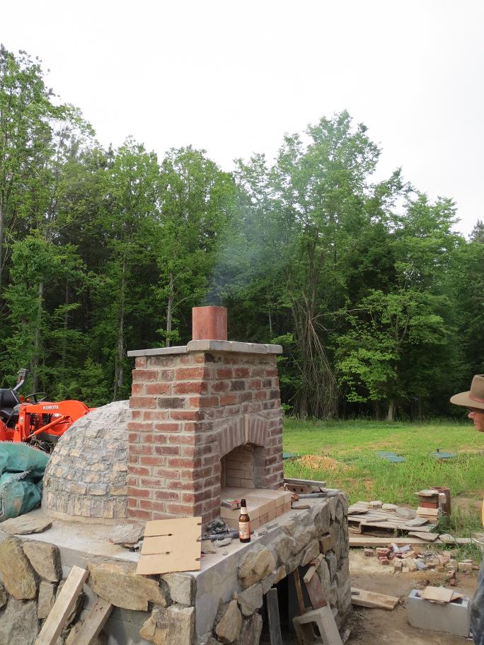

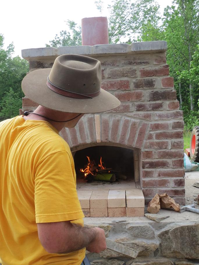

                    Latest update. I spent the weekend with curing fires while I was finishing up some rock veneer.
                    I still need to do some tuck pointing but it was nice to get the fires going. On the third day, I had the oven up to about 400 F, but it was a long slow burn rather than a rapid temp increase.
                    My question, is it better at this stage to have longer more even fires or continue to hit the temp and let it cool. My dome is looking good, no cracks to note of, and the top 2/3's is looking 'whiter' in regards to the mortar. Is that what happens when the oven cures?
                    I hope to get some photos up tonight.

                      finally some progress pics.
                      Started the curing with small fires. By the fourth fire. The wife wanted to try some bread. I said "what the hay, throw it in there and see what happens."
                      pretty cool.
ID:	294750;Click image for larger version
Name:	first fire smoke.jpg
ID:	294751;Click image for larger version
Name:	fourth fire wife wants to bake bread.jpg
                      oh yeah.....
Name:	four months of work for a loaf of bread.jpg
