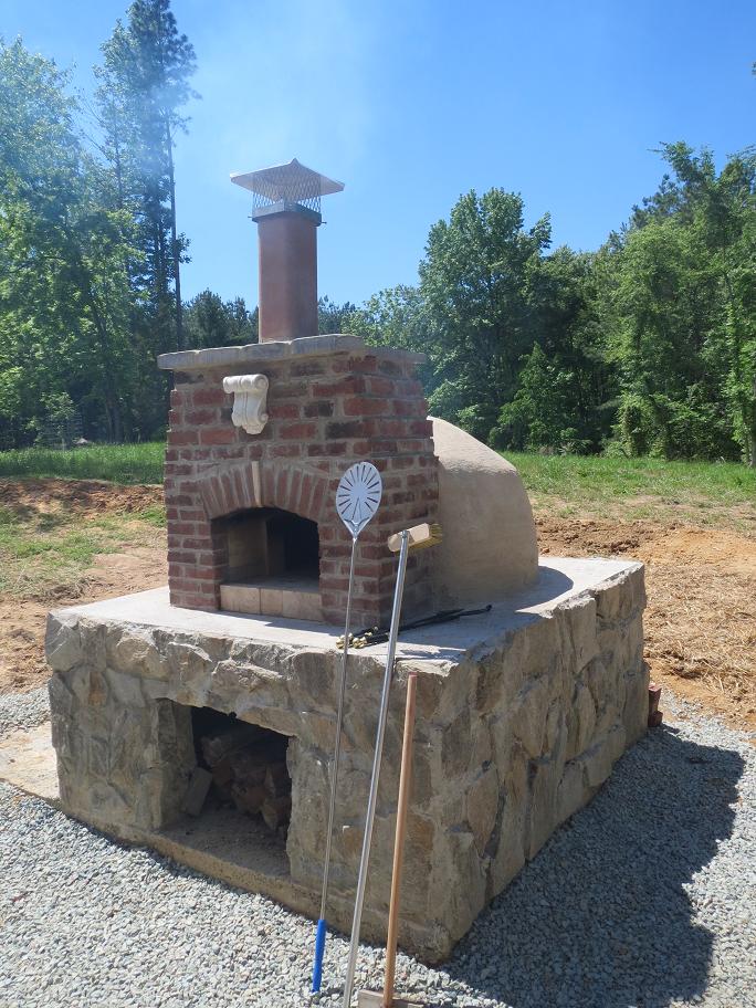

      I elected for stucco. Originally was going to build a house, but then decided that stucco would be easier to complete and get done so I could begin using the oven. I might decide to build a house later, but I do like the look of the oven at this time.Click image for larger version
Name:	right side firing.jpg
      I wish that I would have done some vermiculite over the blankets to insure a rounded dome, but I ended up using more stucco to fill things in.
      The different layers were all different colors that I tried out. You can really do some nice things witht stucco, and it is very forgiving. Pick your favorite color and mix the stain into the concrete stucco.
      I have seen some of the builds with fancy tiles and mosaics, truly impressive.
      After a year or two of pizza's, and if I get bored, I might come back and do something like that as well

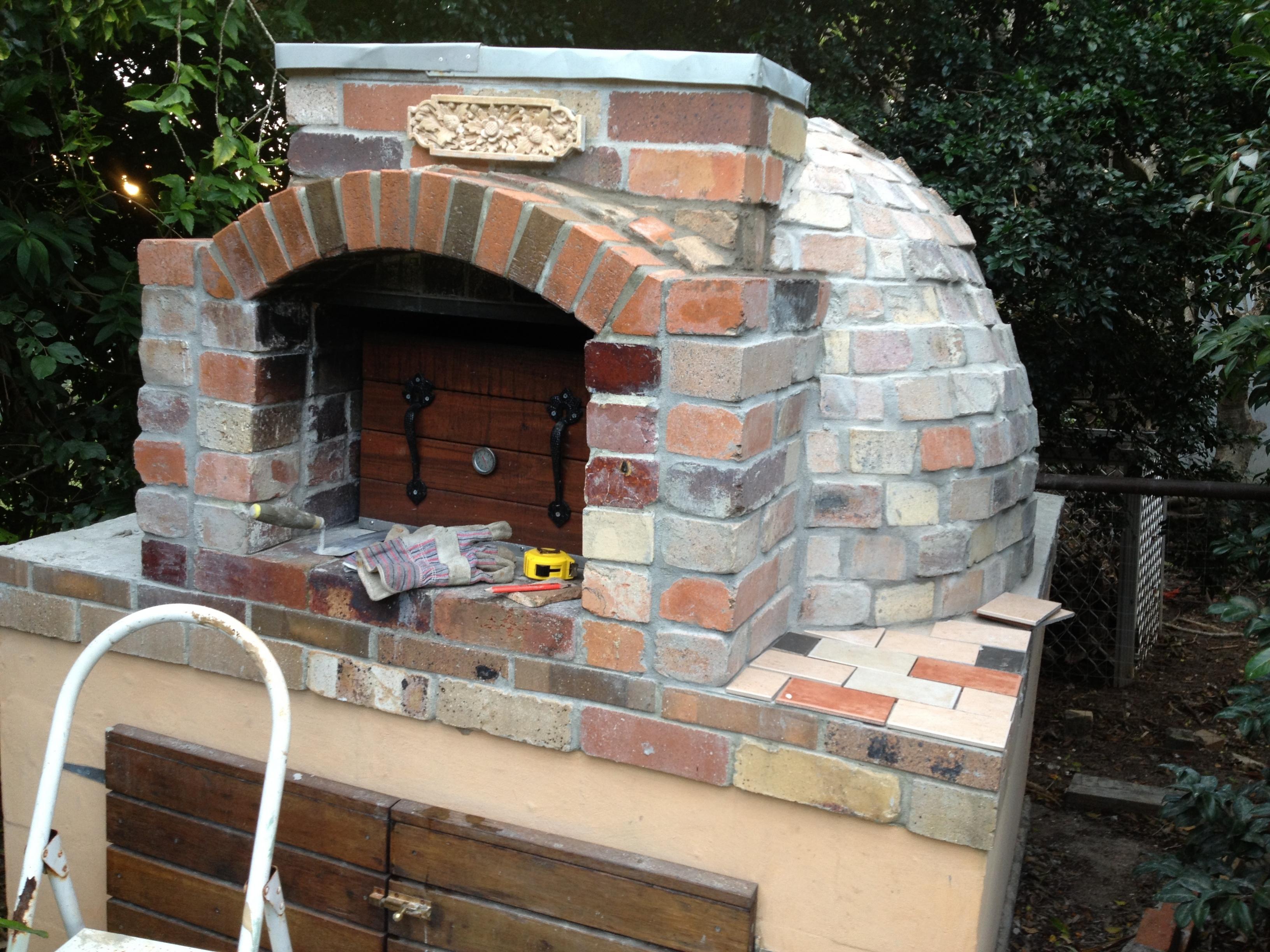

        Gudday
        I got bored with the look and after seeing the effect that V-wiz did with cutting up his own brick veneer I decided to do my own.
        All the bricks are mismatched and all the cuts are with a brick bulster but I'm liking the effect. Still to be cleaned of properly of the lime scale and sealed.
        Also check out Gulfs build he has his with saw cut brick veneer looks great
