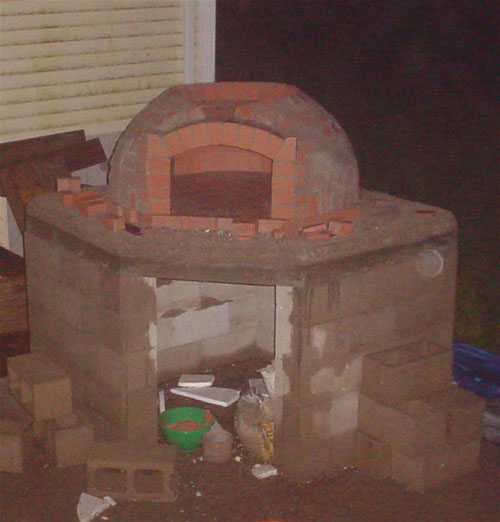

    OK, so I probably should have made the block stand & hearth bigger, but the boss was not gona have it. I was wondering if I could still squeeeeeeeze a 42" in the space I have. The issue becomes space in the front - the landing zone. Right now a 42" oven (on center) gets me pretty close to the front apron. I could squeeze a couple of extra inches out by centering the oven a bit back (but then of course i lose some insullation on the sides. I will go with the smaller oven if needed of course, but my "Toolman Tim" side is grunting "BIGGER!!" at me.
    The pictures are of a dry run 42" internal diameter.

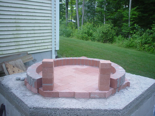

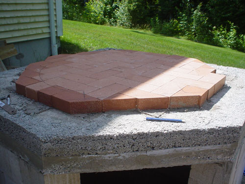

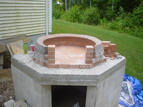

      Soldiers done

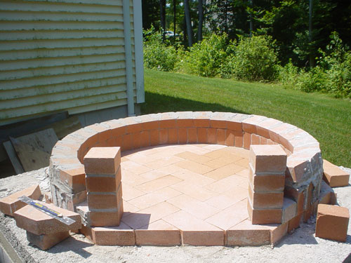

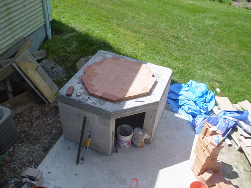

      Well I was on call for July 4, and it was a thankfully quiet day. I had a chance to do some brickwork. I have now completed the soldier course. I decided ultimately to slightly decrease oven size to a shade above 40" - I will also do an extended apron after the dome and vent are complete (inspired by Balty's fine work).
      Two shots of the cooking floor:
      Soldier course finished - starting to work on the oven opening. I am going simple here - squared off with the angle iron on top. I'll do an arch opening on the facade.

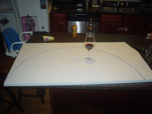

      Finally, I did some work on making my styrofoam forms. I struggled with how to cut the board without making a complete mess and discovered that the old cheap Ginzu steak knife worked best! The glass of wine is optional.

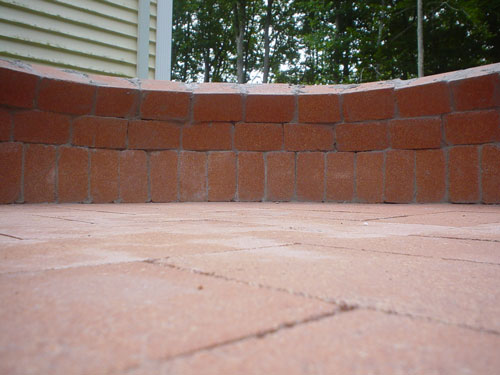

          Dome progress
          Made a bit of progress today - actually got halfway through the 4th course when the rains came. I'll definitely need that 3rd bag of Heat Stop (I bought two) - I'm already a third of the way through the second bag. Contrary to some folk's experience I've heard, this stuff is lump free and in my limited mortar experience, works well.
ID:	267308 Second course
ID:	267307 Third course
ID:	267309 Closeup of floor and three courses.

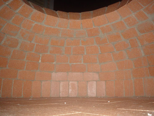

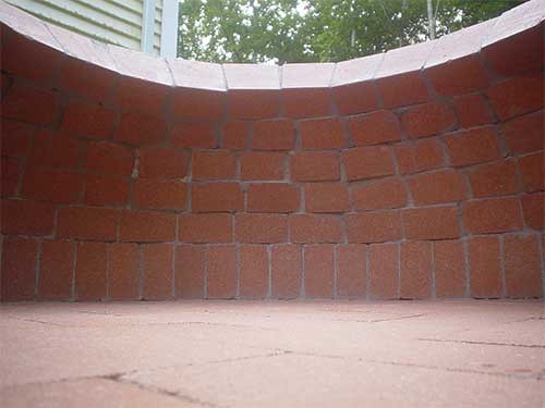

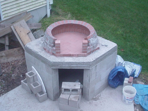

                  Fourth course
                  I got the fourth course done last night and cleaned up some of the mortar drips this morning. So far, so good!

                    #24
                    Re: Forno Tito
                    Looking good, nice work. Watch your head joints (vertical joints) though I see a lot of them lining up with each other. The joints are the weakest link in masonry, having them line up is like an on open door for the crack monster who will eventually visit the oven. If you keep them staggered its much stronger. I'm not saying tear it down but keep this in mind as you continue.
                    I don't know how much the cladding helps "hold" things together Id be interested in those that have built the oven and didn't stager the joints (in places) how its holding up. Please comment if you can.
                    Listen, I'm a pro and I know its hard to remember all the "rules" and lay the darn bricks Hey this is oven dome build is a difficult project for a first time mason and it has its own set of complex issues. So anyone reading this please don't take offense. I have said it before and will again the ovens you guys have built on this site are very impressive and the work very nice . Its no lie, there are a lot of guys out here doing masonry for a living who's work is...lets put it this way you wouldn't want it in your backyard. Ill post some pics..I just don't know where would be the appropriate area? Ill figure it out it will be a major ego boost for those doubting your skills...

                      Re: Forno Tito
                      I think it is looking great. I cut some bricks down to avoid those vertical joints as I went around. I think that is good advice from Uno.

                        Re: Forno Tito
                        Uno -
                        No offense taken at all. I appreciate any and all advice. I too noticed the dreaded "line-ups" when I went to do some clean up this morning, and resolved to be more careful with the alignment. Please keep the advice coming!

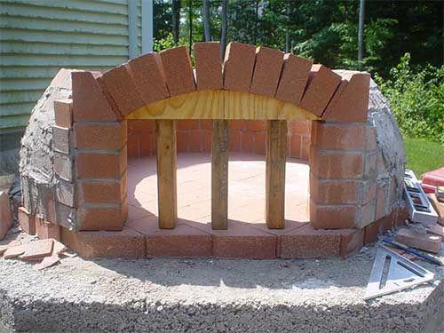

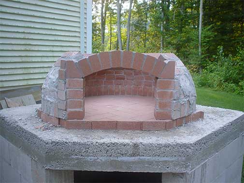

                              More Progress
                              Made a bit more progress this weekend. I put down the 5th & 6th courses and worked on the entry arch. I was originally going to go with angle iron, but ambition (and the fine work of others on this forum) inspired me to go for the arch. My current struggle (and an all too familiar one it seems) is getting the arch tied into the dome. I see my way, but it will be a lot of cuts!

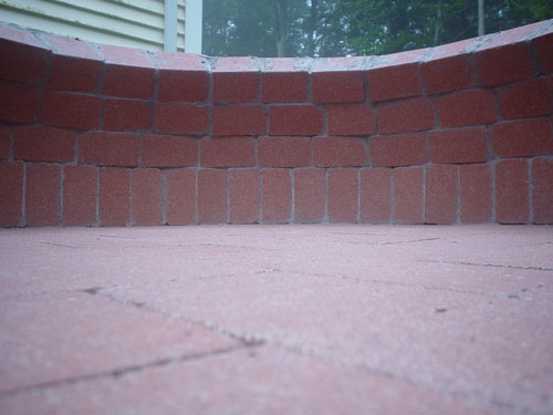

                                Courses 7 & 8
                                Been busy at work, so I have not made as much progress as i would like. I've been able to get courses 7 & 8 up. Picked up my fourth bag of Heat Stop today, but further brickwork must wait - I'm going on a dive trip tomorrow!
                                Anyway, the top of the dome (I'm measuring 4 more courses) is now in sight.
ID:	267357 hopefully better at staggering those head joints (harder to do than it seems with tapers)
