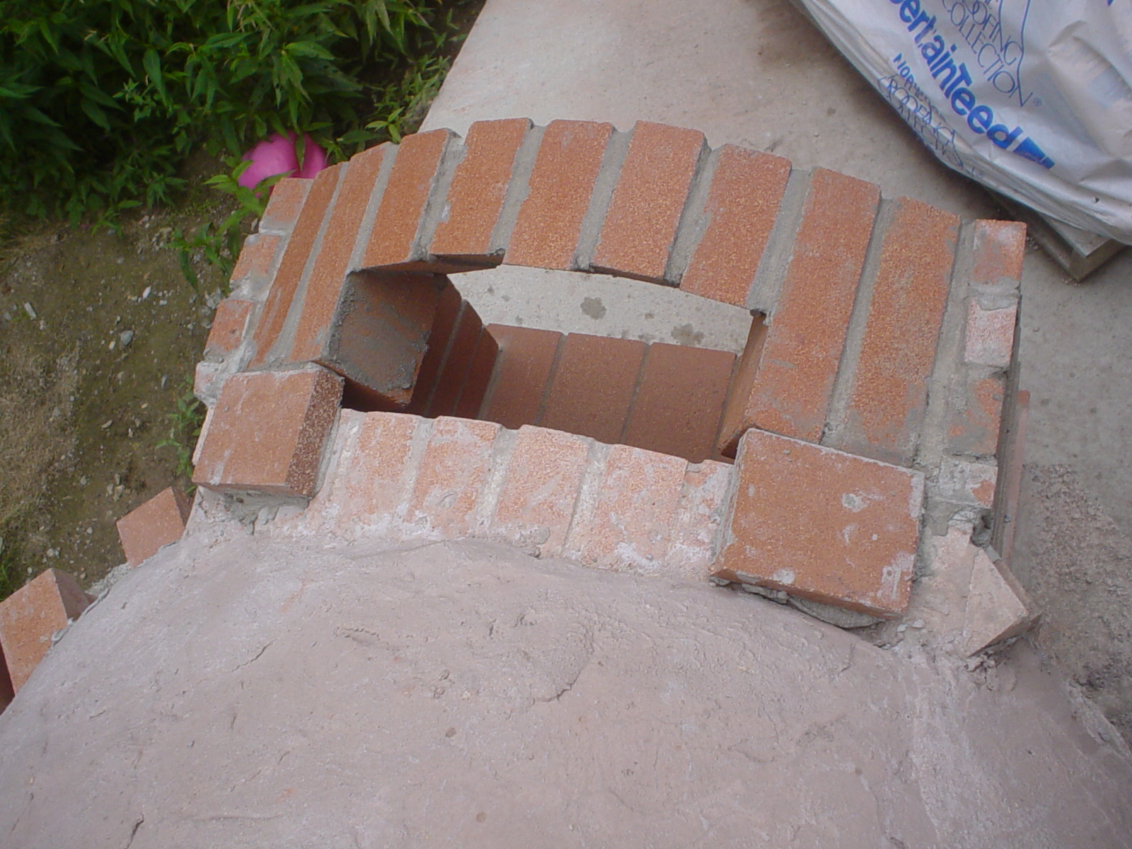

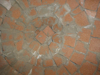

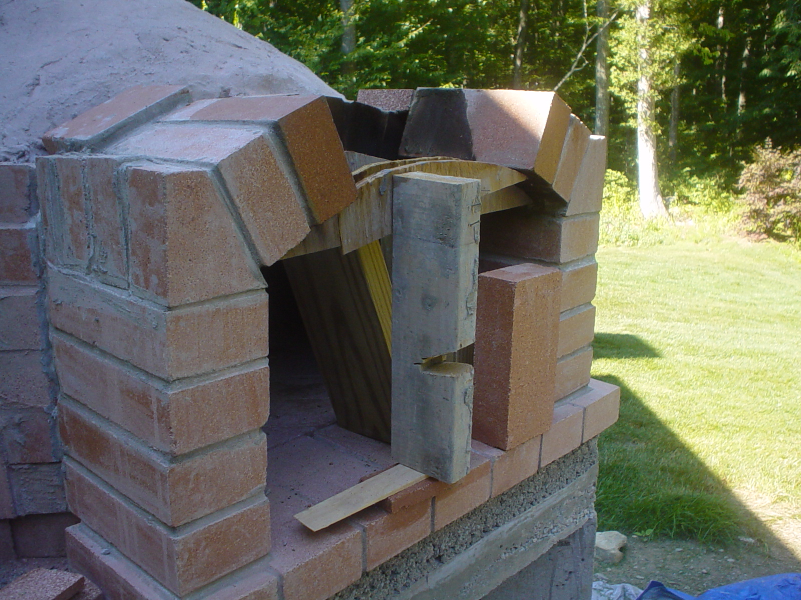

    Been a while since I posted, but I have been (slowly) getting work done on the oven. I have actually finished the dome itself (not pretty, but it feels stable as a rock), and I got a set of FB pizza peels from my wife for my birthday. Soon I hope to graduate from "digital camera pizza" to the real thing!
ID:	267504 I have also started the front landing. I am planning on a second arch attached to the oven opening with a 3/4" reveal for a door. The vent will be built into the arch by cutting the middle bricks. I've yet to decide between masonry chimney and duratech. Masonry is cheaper, but the duratech would certainly be less of a weight load on my arch...
    Either way, I am figuring about 24" of chimney - sound right?

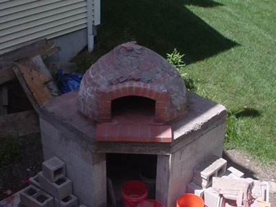

ID:	267505 As you can see, the top of my dome ain't exactly pretty. I had a hard time cleaning drips with the styrofoam boards in place. I was working on making it pretty when my wife pointed out that nobody but me will care, and she wants pizza! So it will remain "rustic."

      excellent...i cant wait to see how you finish out the landing and the chimney. Again, thanks for posting the progress!

        Looks good. The dome will perform well. I would use duratech for convenience and to mitigate concerns about weight on your arch. With your corner installation you have less room to buttress the sides of the vent area to provide support for the arch. If you are set on a masonry chimney you could span angle iron across the vent above the arches to distribute the weight more directly on the pad below. A 24" chimney should function fine.

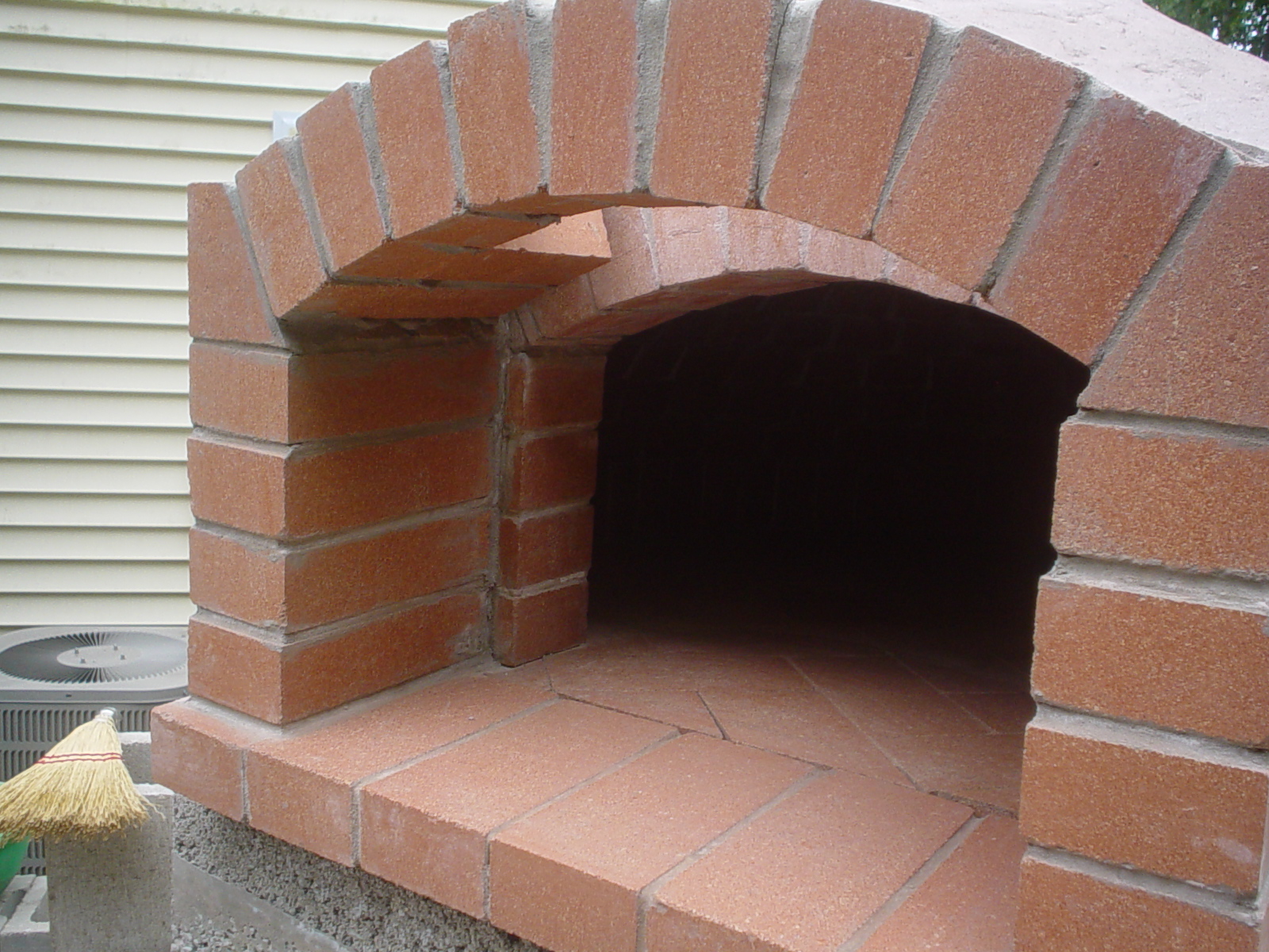

          Got the Duratech today, and finished the opening arch. The vent is a space I fashioned between the two arches by cutting the middle 5 bricks of the arch roughly in half on an angle. It measures about 5" by 12" - pictures too follow (it got too dark).
          After this, it will be time to start on the enclosure. My vermiculite is paradoxically hard but crumbly so I am thinking of cutting it away down to the concrete along the edges so the studs will have something solid to anchor into.

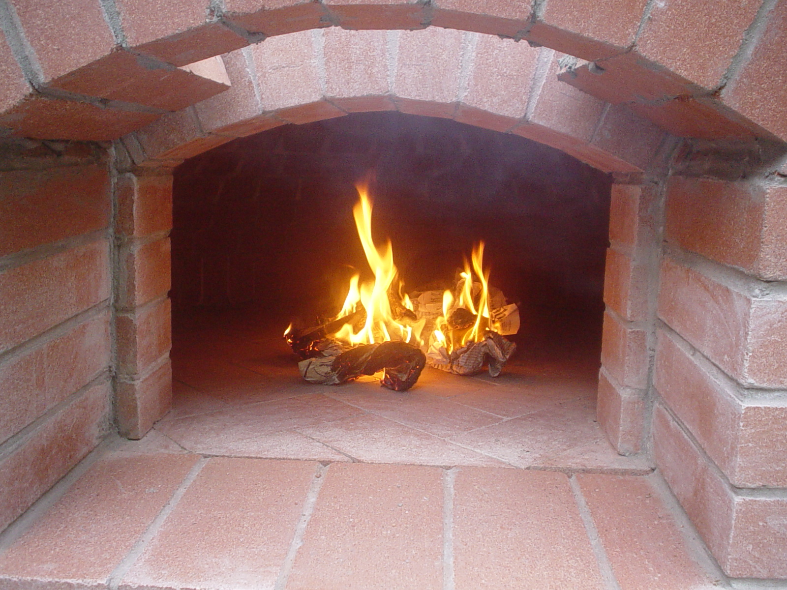

              First Fire!
              I think these pics are like the ones we show of our babies. Only those who have one truly appreciate the beauty.

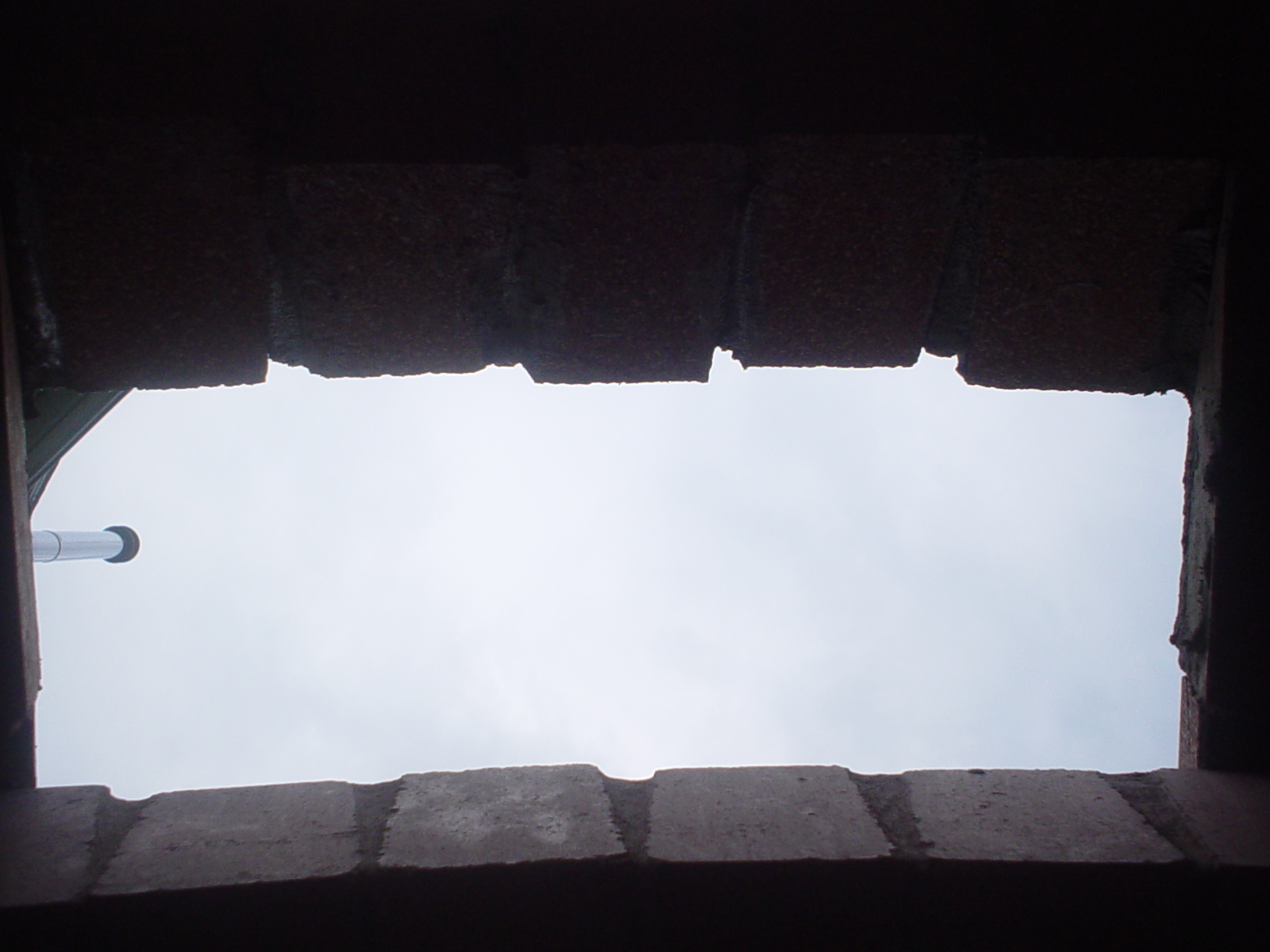

ID:	267535 Upper vent opening
ID:	267538 Inside vent opening. No that is not the chimney for the oven! That's the VERY VERY long Duratech we used for the basement wood stove. I really should own stock in that company.

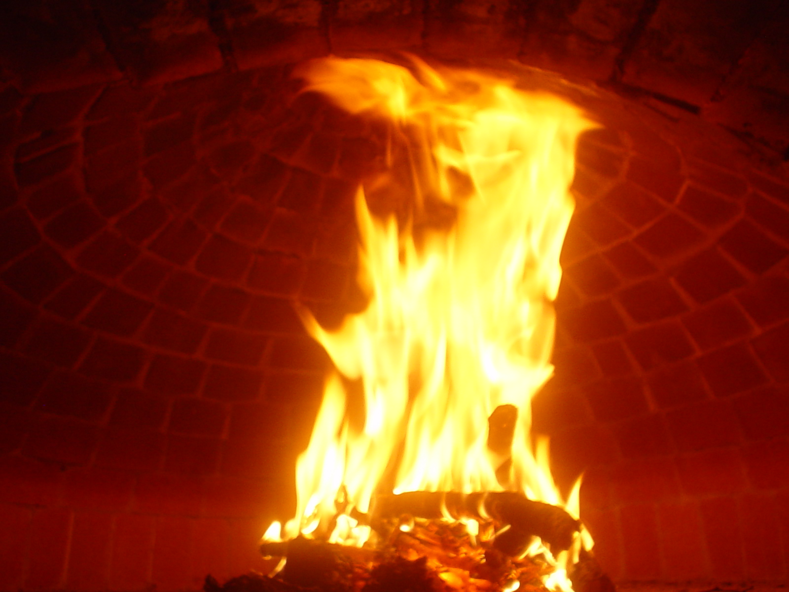

ID:	267536 Outer arch reveals the..uh...reveal
              I would say about 10-20% of the smoke came out the front, but that is without a chimney and in a never before fired oven. I think it will be OK.
                  [ATTACH]3334[/ATTACH] Upper vent opening
                  Joe,
                  Your oven looks great! I noticed in the Upper Vent Opening picture there is a small gap between the reveal arch and vent arch that you bridged with some splits. Is this by design? If so, why?
                  Thanks!
                    Thanks!
                    Ken
                    Sort of. I wanted the upper arch to "stick out" slightly from the columns. Just an aesthetic thing. It leaves a small channel that I am hoping will be like little smoke catchers and funnel it into the vent.
                        Excellent idea. Again, it looks great. Thanks!

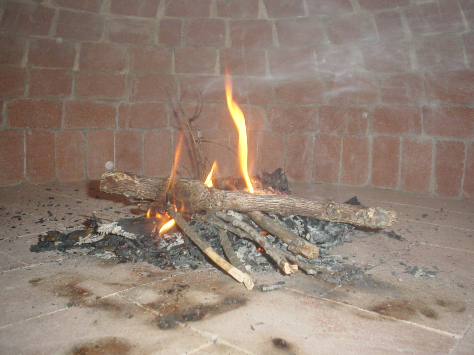

                          Started a second fire in the oven this morning, and will do another tonight. I am using the "Ernie Banks" method of oven curing (lets play two!)
                          Until my insulation arrives, I'll keep them down to a dull roar. Although the top of the dome did get warm on the outside this morning. I could still hold my hand on it, but the heat from the fire was definitely coming through!

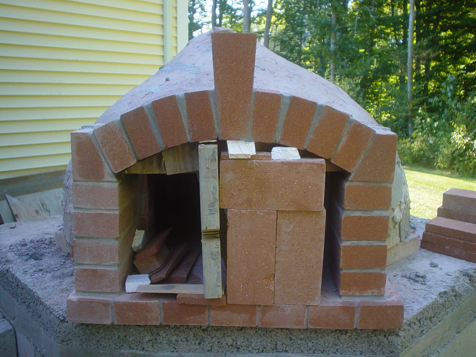

                            Forno Tito Disaster!!!
                            OK, maybe not quite a disaster, but a bit of a setback.
                            On Thursday morning, I went outside to check on the oven and wipe some soot off the face of the front arch that had gotten there from the fires. When I wiped I noticed that the entire center of the arch moved (the middle 5 bricks). Bummer!!!!
                            I toyed with simply re-mortaring them in as one piece, but decided to take them apart and rebuild it. When I chiseled my mortar off I noted that the centers of the mortar "pancakes" were still dark from moisture - not nearly fully cured. Lesson learned: let ALL the mortar (not just the dome) set up for a good week before firing up.
                            In addition, I thought I cheated on the mortar joints a bit and left them too wide, so perhaps there was too much shear stress on them? In any case, I decided to change the arch a bit and create more of a keystone in the middle by turning a brick on it's flat side and tapering the edges. Now the arch is as tight as the oven entry arch and (I hope) much more stable.
ID:	267591 The culprit. Too much, too soon.
ID:	267592 The soot in the low vent is quite visible here.
ID:	267593 You can see the middle of the mortar is still dark.
ID:	267594 The new arch! I think I actually like the look of this quite a bit better than the old one, so I will call this crisis an opportunity!
