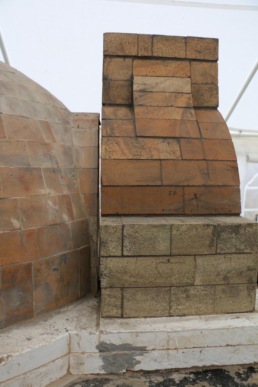

    Originally posted by jonv
    cnegrelli I dug out a photo that shows the break... it's only a small gap so its effectiveness is limited, but it does appear to help a fair bit.
    jonv,
    Just curious if the break results in smoke escaping prior to going up the flue?
    Marc
    • jonv
      • May 2015
      • 255
      #197
      Hi Marc. There is nowhere for the smoke to go. The gap is filled with ceramic fibre rope and even if it were not, the outer shell completely encloses the oven.

                              I see that you have left a thermal gap between the dome apex and the chimney/flue chamber, is this to avoid absorbing any movements from the variations temperature between two spaces?
                              Did you use in total 100mm of ceramic thermal blanket and 100mm of vermiculite?
                              • jonv
                                • May 2015
                                • 255
                                #210
                                The gap is there primarily to reduce conduction.
                                I didn’t use any vermiculite, just 100mm of ceramic fibre.
