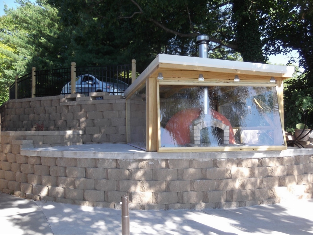

          #19
          Finally put together the cover for the oven....I think it's done. Wanted something that would keep the oven dry but not hide the oven when it's not in use.....does anybody see any downside to this design? The front is hinged so your able to lift it and support it so it creates a roof area over the front of the oven...just in case there is a little rain while your cooking.
          We've used the oven quite a bit but not since the enclosure is completely done. Monday having about 20 people over for pizza...we'll see how things go.
          Thanks to all for the many ideas that were incorporated into this.....like the concrete boarder around the oven to run any moisture from the platform away from the oven. Just one of the many helpful suggestions.
