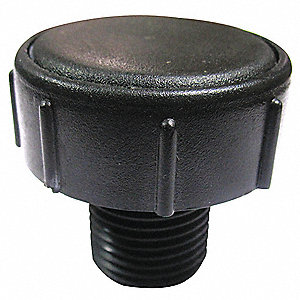

            Also consider a vent on the apex of the dome when you start doing the stucco or vcrete or both. Dome shape looks good and uniform. Click image for larger version

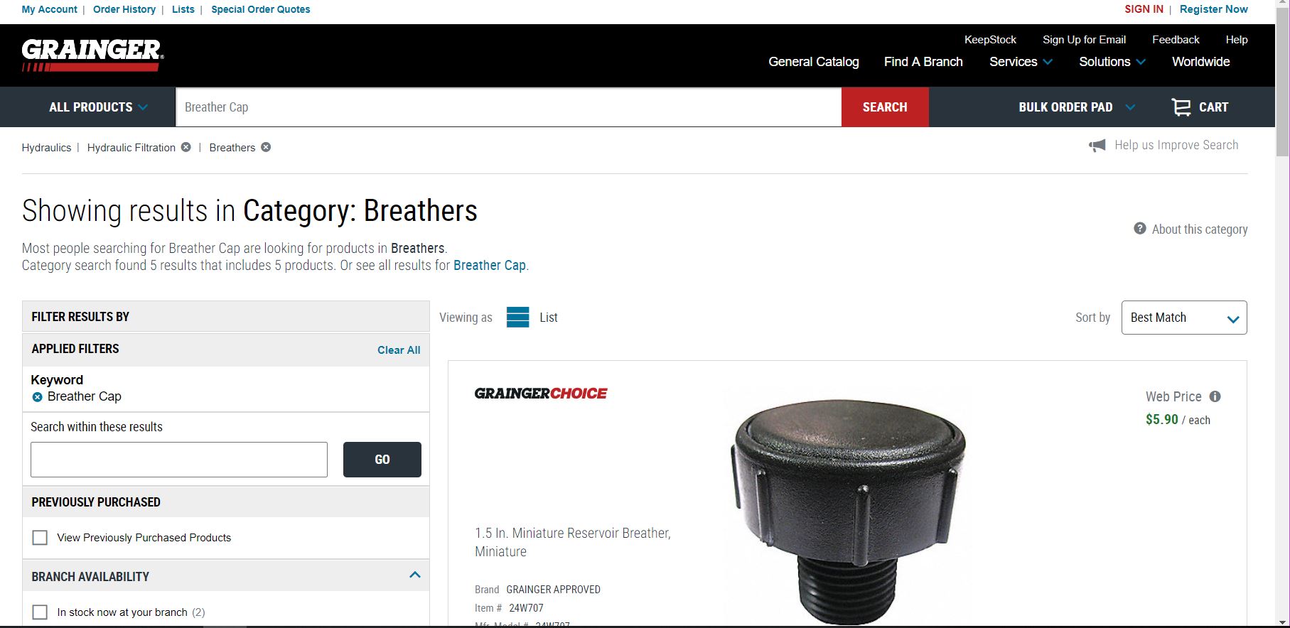

              Russell, what is that? Where do I get one? I am planning to vent the dome and fabricating a copper cover.
                • 5263
                Napa or any auto parts store. It is a breather vent cap. 1/2" npt. Abt 7 bucks.
