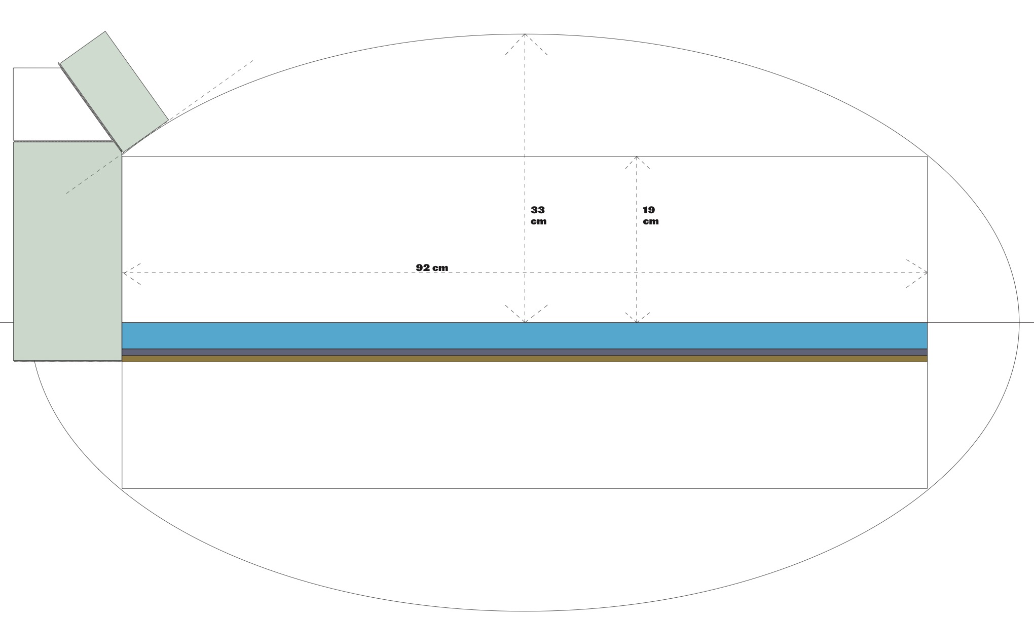

                Here is the plan for the dome and some numbers:

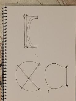

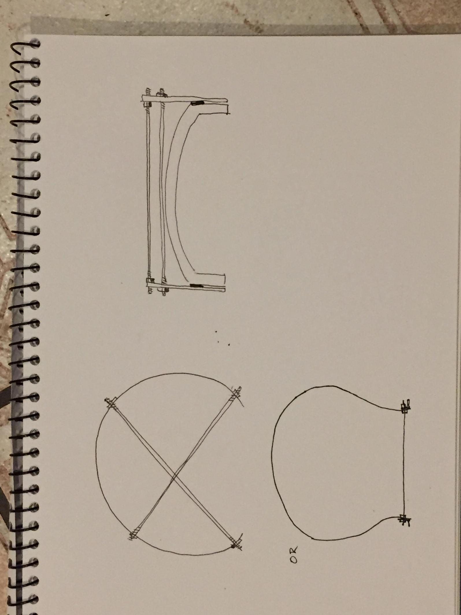

                  Getting a steel band all the way around the dome presents problems because the oven door is in the way. Some builders have overcome this problem by anchoring the band into the supporting slab at the sides of the oven door. Another solution is here on attachment.It requires at least two pairs of threaded rods. Other solutions like buttressing are also possibilities. IMG_0461.jpg

                      Sorry about the last pic. Here are a couple of solutions I've seen. Click image for larger version

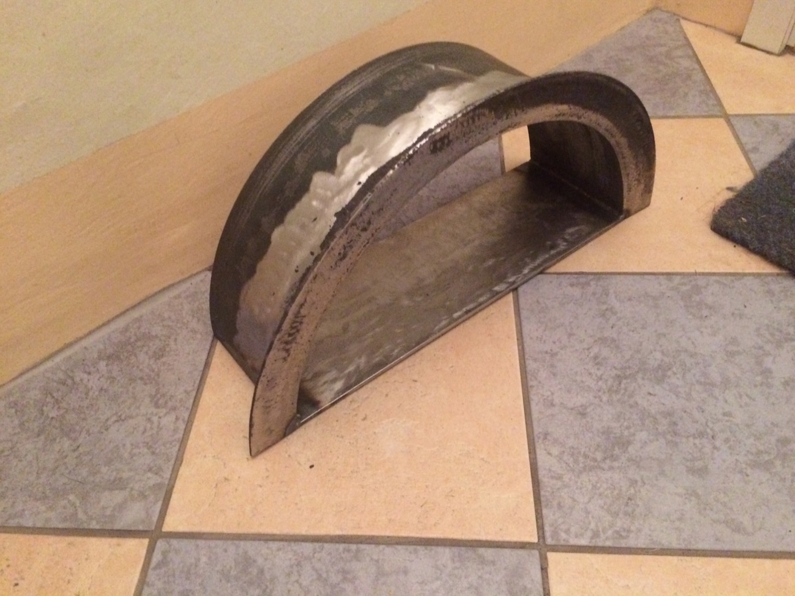

                        door! Thursday I will go on building
Name:
                          Nicely fabricated arch. I notice there is not a reveal on the arch for a door to seal against, what does your door design look like?
