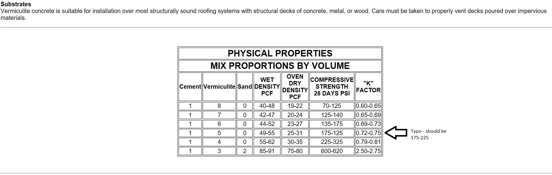

                Thank you very much for all the tips and suggestions. Thermal Gold 12 is expensive for my budget. Could I use a layer of sand? 1" or so? Sand has a high melting temp and doesnt transfer heat very well.
                  If high tech insulation if out of your budget then look at a p or vcrete, 5 to 1 under floor and 8-10 to 1 on dome, min 4" under floor and dome. Usually need to go to a masonry supplier for perlite/vermiculite. relatively cheap. You can get portland at any big box store.
Name:	Vcrete K values.JPG
