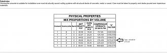

                  If high tech insulation if out of your budget then look at a p or vcrete, 5 to 1 under floor and 8-10 to 1 on dome, min 4" under floor and dome. Usually need to go to a masonry supplier for perlite/vermiculite. relatively cheap. You can get portland at any big box store.
Name:	Vcrete K values.JPG
                  Would adding more V to make a ratio of 3/1 provide even more insulation? Im looking at your attached chart and looks like the K factor goes up the more V you add. Heck why not use almost all V?
                  Many thanks, your build is awesome.
                    #24
                    I think you don't understand "K" or thermal transfer. The higher K value equates to higher transfer of heat through the given material. You want a lower K value. Sand in the 3 to 1 formula is one of factors in the high k value.​​
                      Sorry I had it reversed! Thanks for clearing up.
                      So the reason for a 8-10 to 1 on floor (as recommended for dome) is because will not be strong enough to handle weight?
