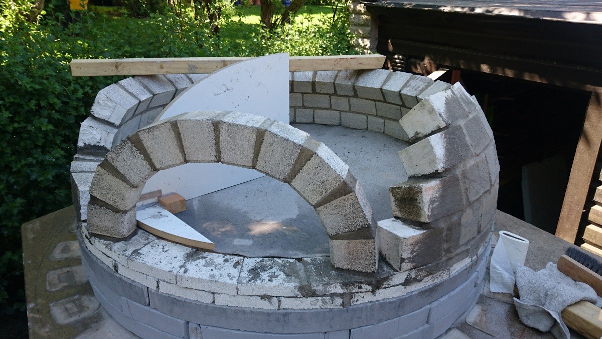

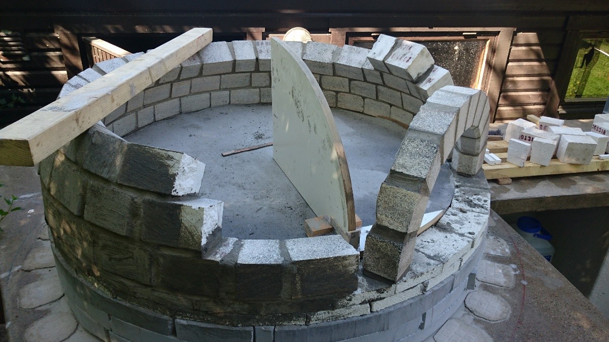

    Last blocks mortared in place today.
    • Petter
      • Feb 2020
      • 210
      Long time since last update. After some mock-up testing, I ended up with a 40" deck instead. The dome shape is a super ellipse with the factor Pi/sqrt(2). 14" dome height. 8" high door, 18" wide. The super ellipse is equal to a 36" normal ellipse with 9" soldiers as dome shape. Instead of soldiers, I decided to let the math give me a nice curvature and strong transition from vertical to horizontal.
      I like the look of a classic dome with laying bricks in every course but wanted the flat dome from the Neapolitan ovens. Hence the super ellipse.

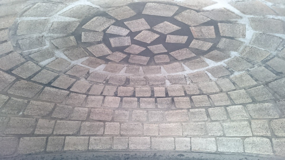

      I had to increase the grain size in the mortar as the joints were getting larger. It explain the difference in color.

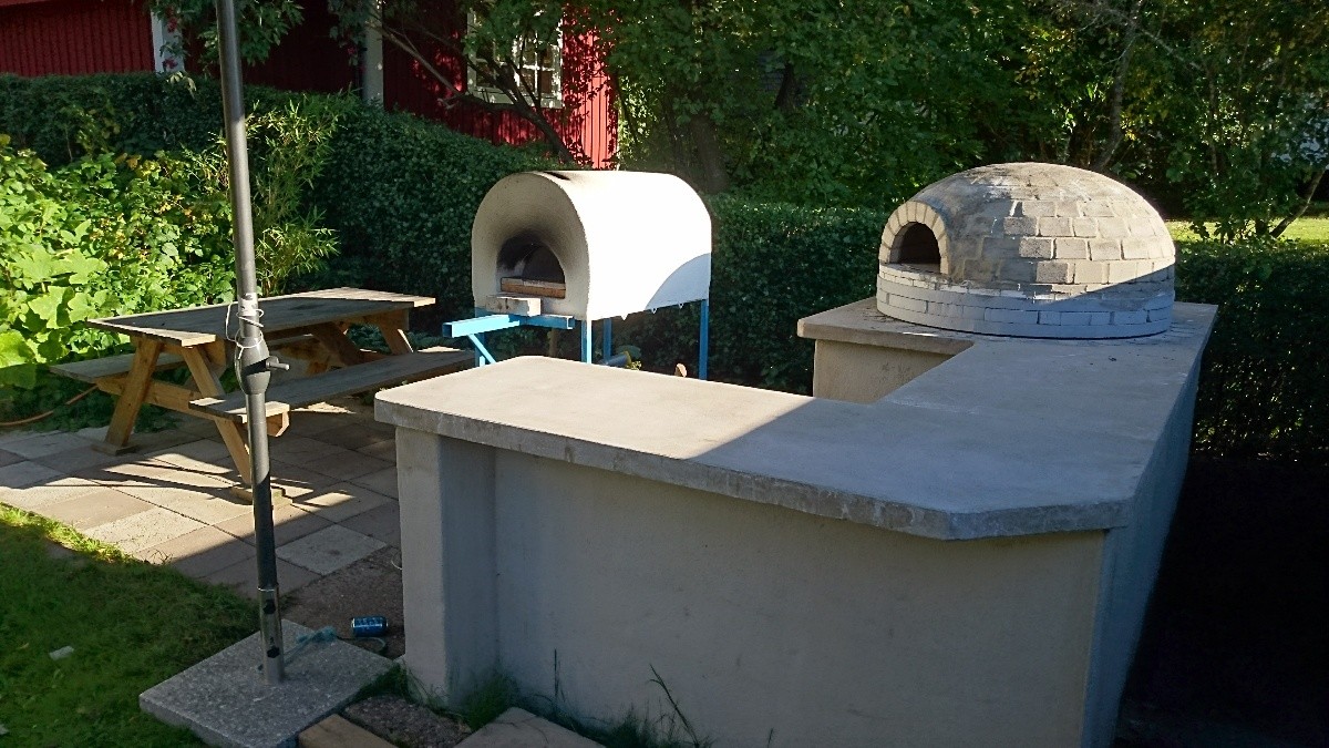

      It was a bit trickey in the end since I used pre-tapered bricks and a sheet brick guide. Though it looked centered from the outside, an offset appeared on the inside. Hmmm. Let say it ads personality to the dome :-) I'm pleased after all. My very first masonsry project stands by it self!
      Click image for larger version  Name:	_20210904_214836.JPG Views:	0 Size:	266.7 KB ID:	441430
      Now, I have some thinking to do about the flue gallery.
      /Petter
