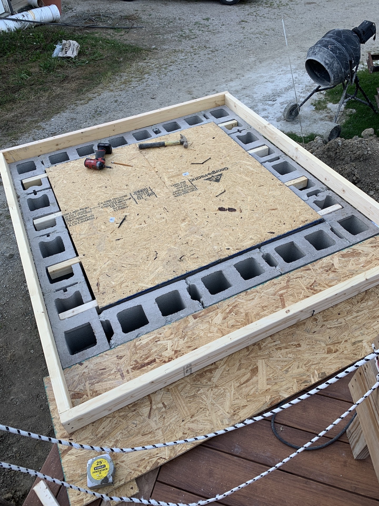

              • #8
ID:	429789 2x4 to hold osb cut into top cinder block for holding concrete floor.

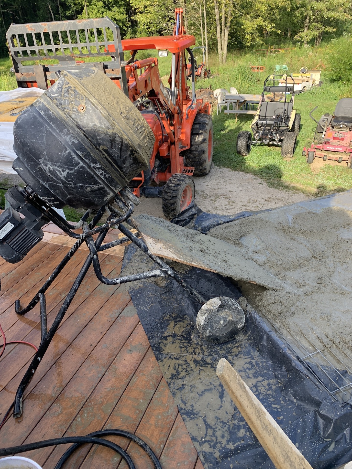

                • #9
ID:	429804 Pouring the concrete floor with small mixer. Note the bags of concrete on pallet!

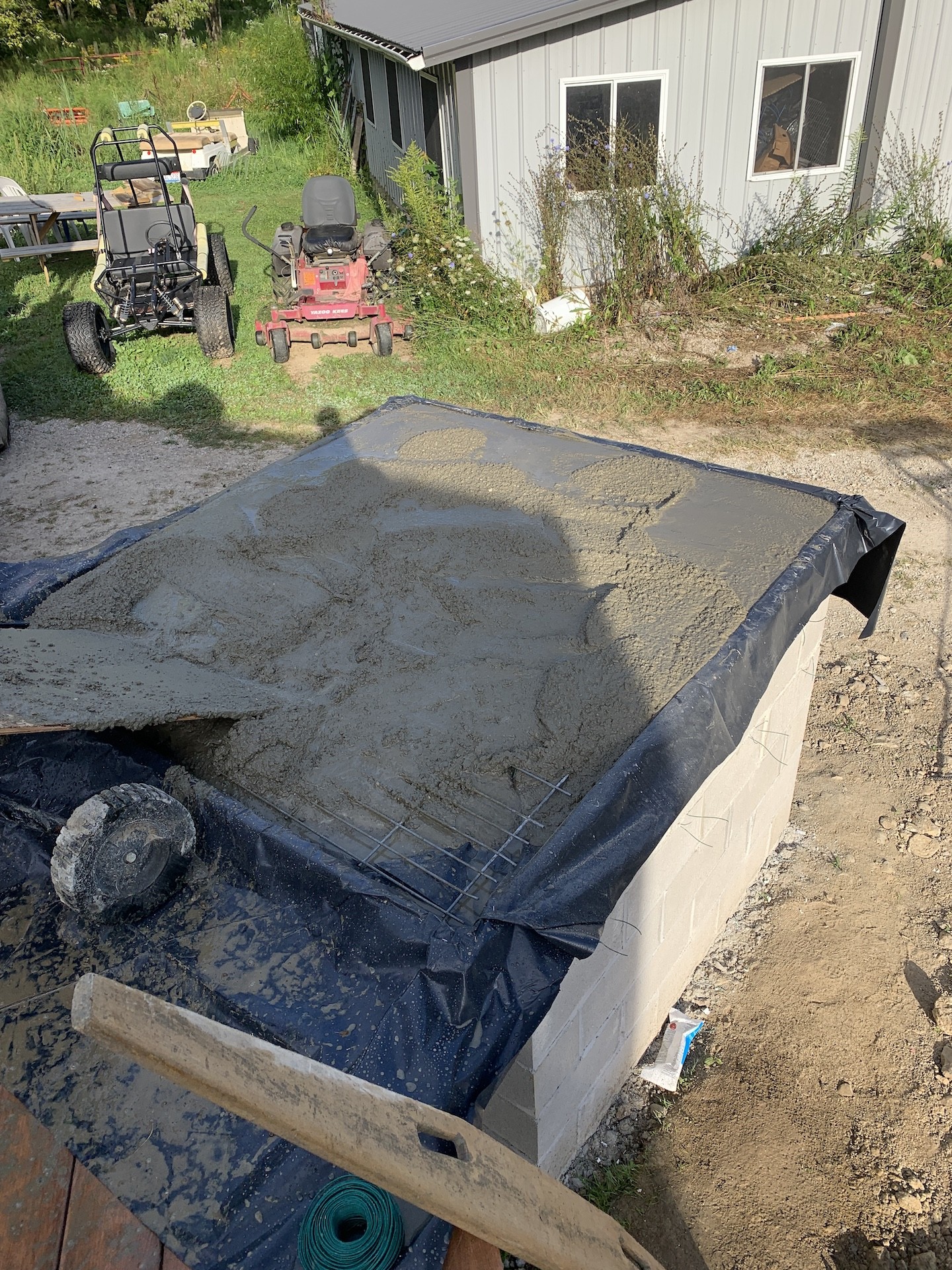

                  • #10
ID:	429805 Almost to the top

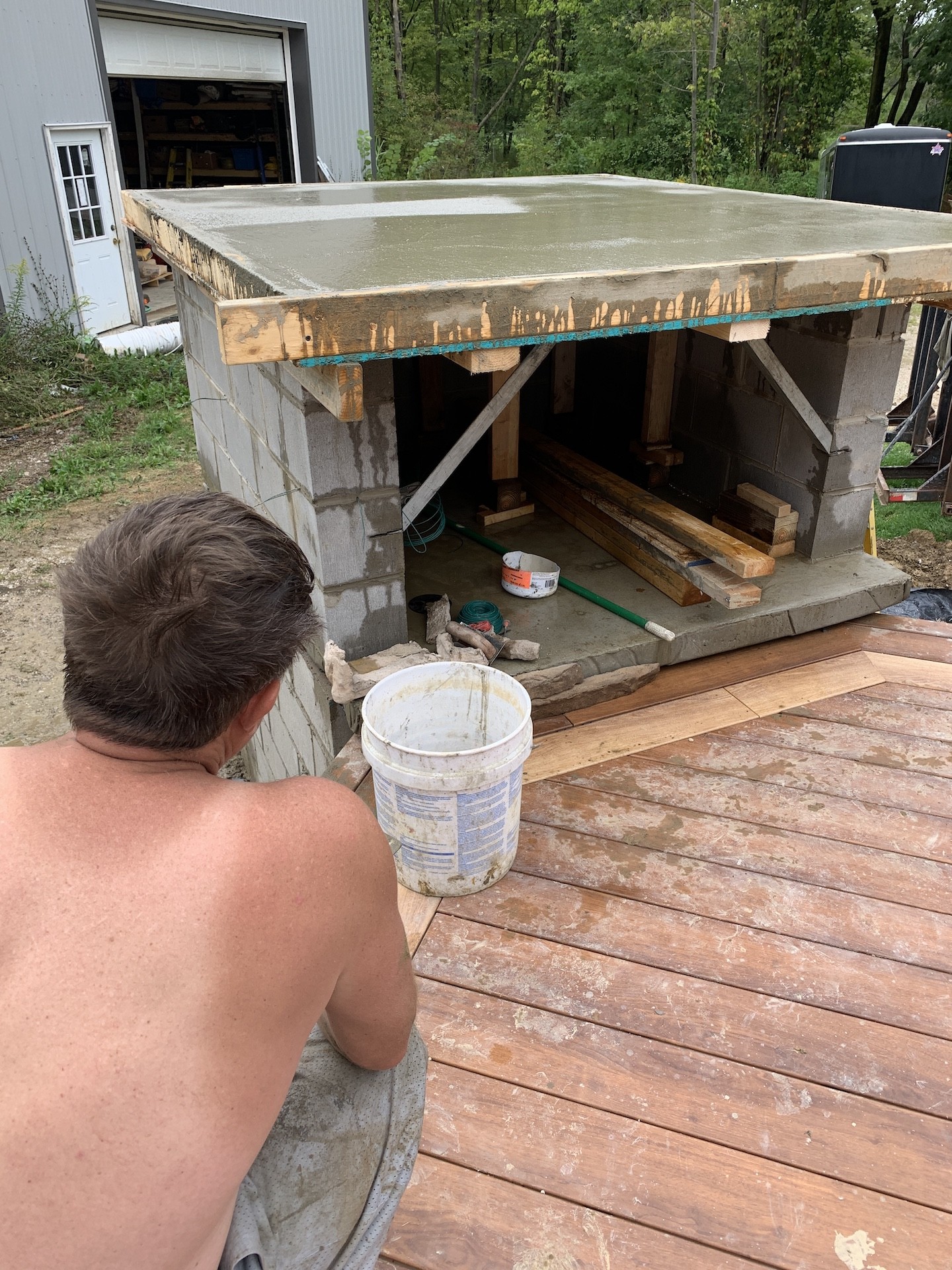

                    • #11
ID:	429811 Floor to Pizza Oven with wood storage are below. First Layer regular concrete and reinforcing steel.

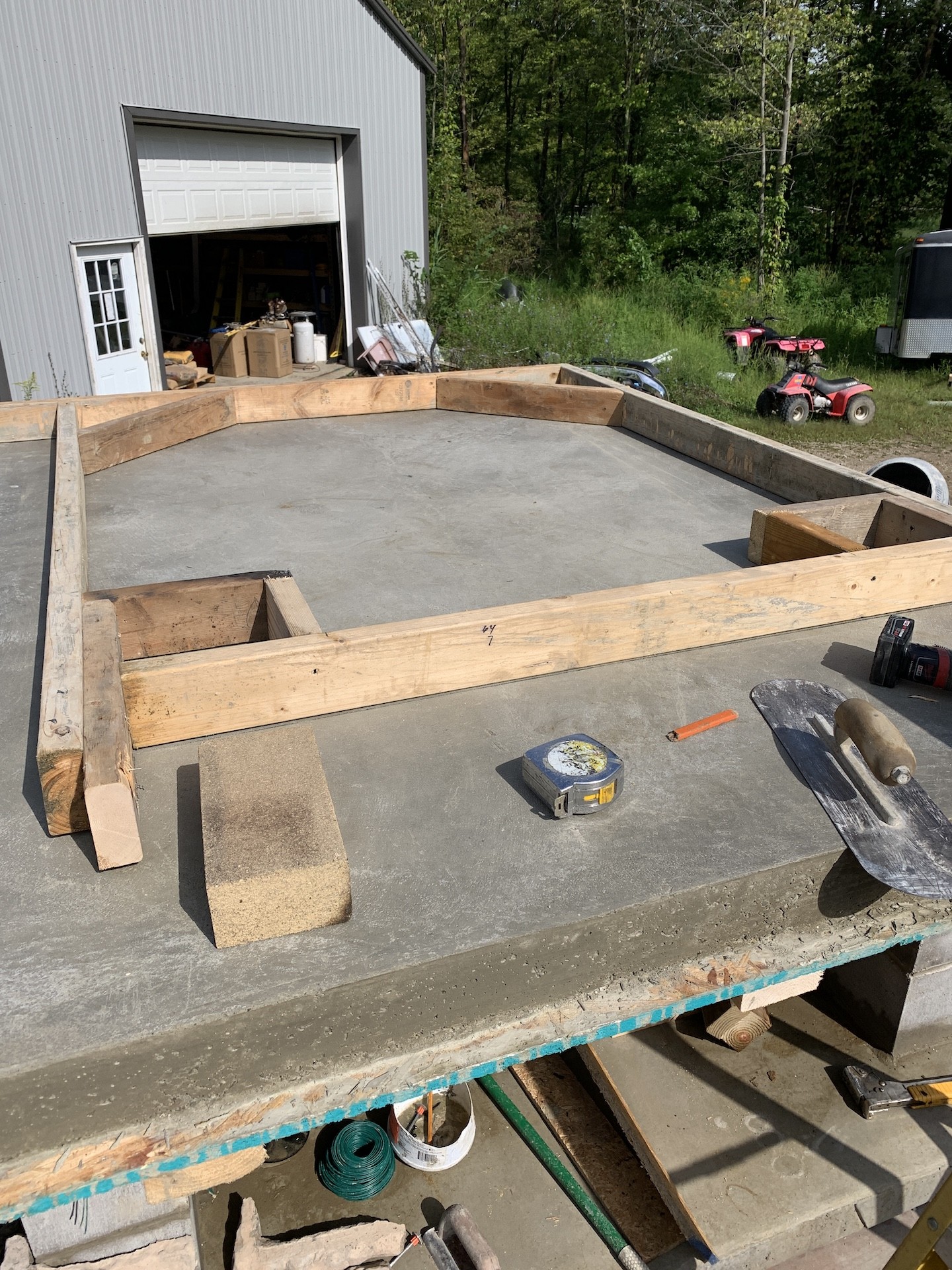

                      • #12
ID:	429807 Finishing the floor for the oven.

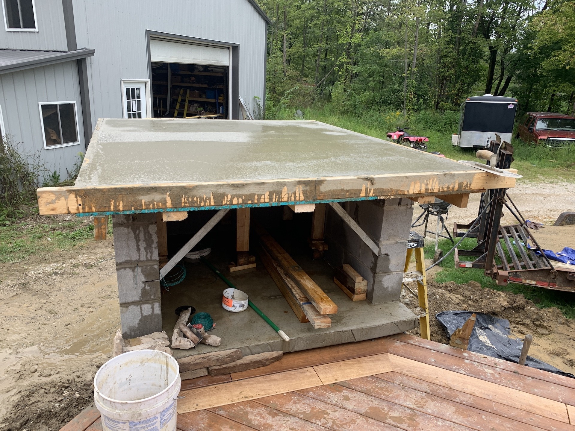

                          • #14
ID:	429809 Watching cement dry is like watching water boil. It takes for ever
