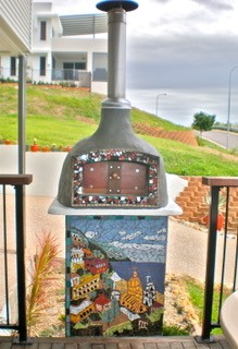

    I don’t think you should alter it. Many builders are of the belief that the 63% door height to internal height is most important. My experience with altering this ratio has led me to believe that considerable departure from that ratio makes no measurable difference.
    A customer of mine requested a taller oven (mine are only 21” internal hemisphere). I cast a 2” high ring around the base and mortared the 21” diameter castings on top, raising the internal height by 2” as well as raising the oven mouth by the same amount. I was pretty uncertain what to expect, having altered the internal volume considerably as well as changing the door to height ratio. I was surprised to find that there was no difference in firing characteristics or oven performance compared to an unmodified oven. They did a stunning mosaic of Positano on the front by the way.

      Thanks for your feedback. I believe I will just leave it as is. I will be covering the dome with insulating blankets then adding a housing around it. If for some reason it doesn't work as well with this dome height, worst case scenario is just having to remove the roof and blanket to redo that section of the dome.

        BTW, that is a stunning mosaic on that oven.
