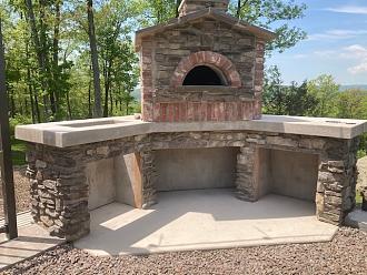

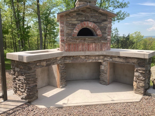

    i am building an garden kitchen with a pizza oven.
    Some photo’s here to let you see the progress.
    let me know what you think!
      Is the dome wall sitting on the concrete hearth or the fire brick floor. Ideally the dome walls should be isolated from the concrete hearth. If sitting on the concrete hearth, the hearth will act as a heat sink. But it is what it is since the dome is done. You may want to consider drilling a couple weep holes from the bottom of the hearth to the CaSi board. Since the board and floor are recess any water will migrate to this area with no way out. Wet insulation is one of the most common issues with floors not heating up.
        Thank you for your feedback. I really appreciate you taking the time to look at my work.
        The dome is halfway on the concrete, i made a miscalculation there.
        there is one hole in the bottom of the hearth. It is for a chimney from a wood stove. I hope that this hole will be big enough to drain any water.

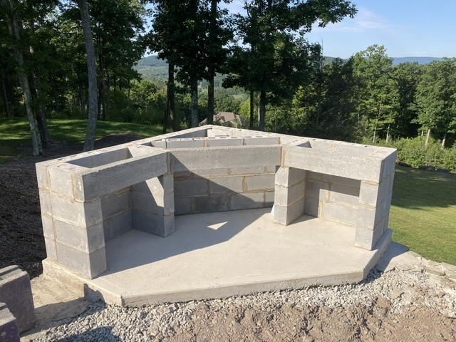

              I did something similar with concrete blocks because in Houston it’s to humid for anything else. Also L shaped.
