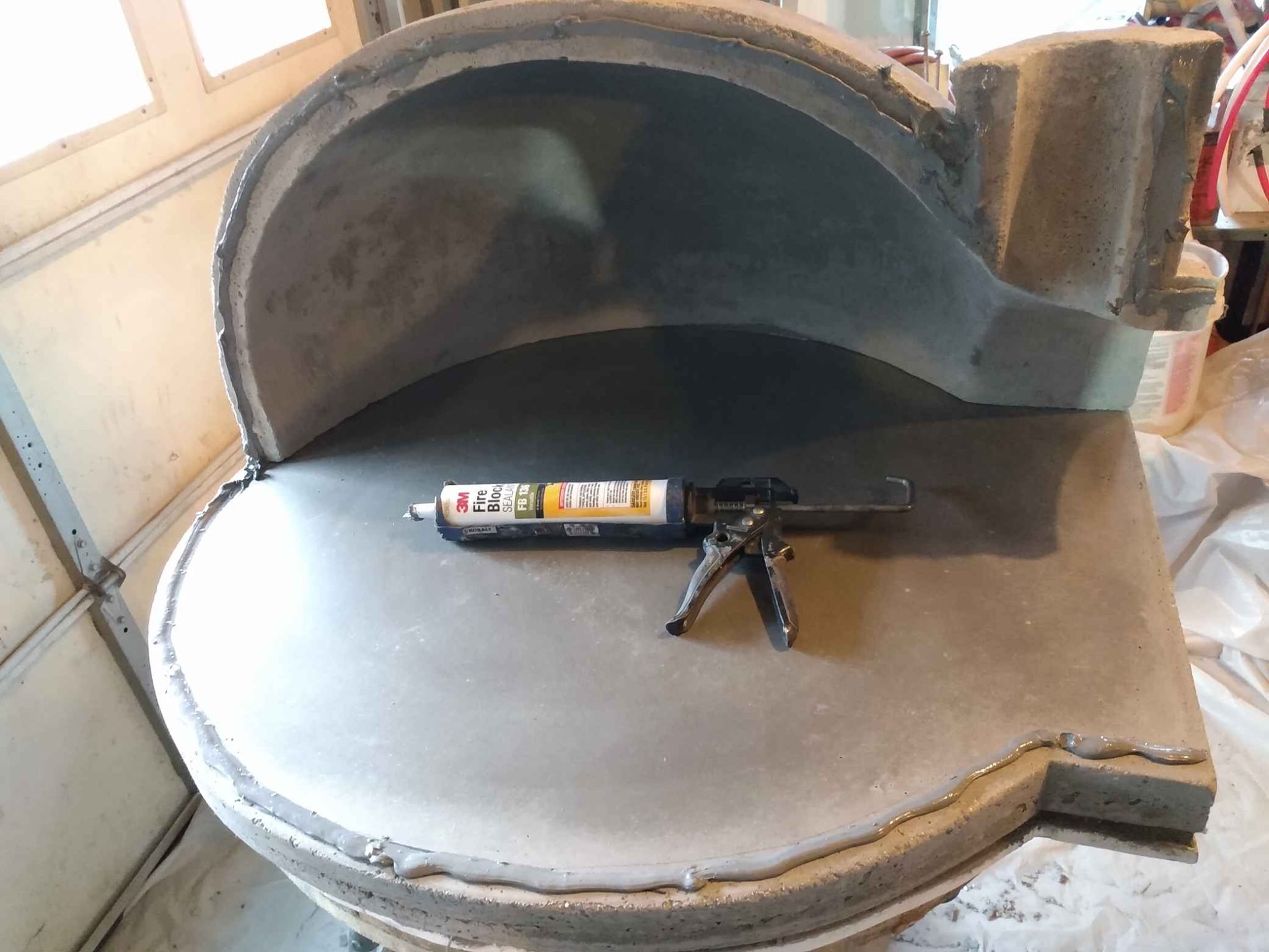

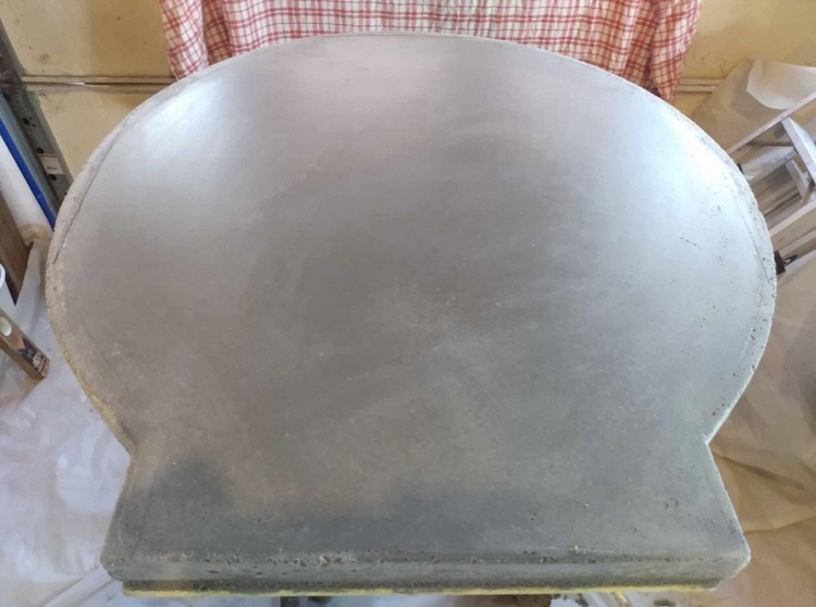

    Good morning everyone, my name is Dan and I’m on a quest to finish my backyard with a pizza oven as the centerpiece. A little bit of background first. I actually purchased a 3-piece cast concrete oven “kit” from a local gentleman who manufactures and sells them online. I know, it’s the easy way out, but I don’t have the time to learn how to build one and eventually screw it up. He has made and sold dozens of them, so I figured it was better to use his experience and only have to take credit for making it look good.
    I began a thread in this forum asking how to finish the outside, but was soon made aware there is A LOT more to making it work “correctly” than just gluing the pieces together and lighting a fire. I guess I jumped the gun quite a bit, so I’m here bowing my head and starting over. Here I am now to say hello, show everyone what my plans are and begging to ask questions about the new addition to the back yard. Currently I have the counter where the oven will live already built, so the most labor intensive part is already done. I’ve done block work in the past, so it was pretty easy. The poured concrete countertop was my first attempt, so it came out alright, not perfect, but fine for a rustic outdoor kitchen area. I’m hoping that the 3-piece kit is ready for pick up this weekend and the fun will soon begin.
    I will lay out a few questions that both friends and forum members have made me aware of and see what wisdom can be thrown my way.
    First, let me show you the oven that this gentleman builds and I will be using. Here is the description from his ad as well as a few pictures, “Three piece kit. Pieces can be moved by two or more strong people to get it set. Includes base and two piece dome. Base is made of UL food grade refractory cement. Dome is made of UL food grade insulated refractory cement. Inside cooking surface is 32 inches across, large enough for 2 pizzas at a time. It can be cooked in the way it is or finish it up with stucco, tile, brick or stone. I can finish one for you if that works for you.”

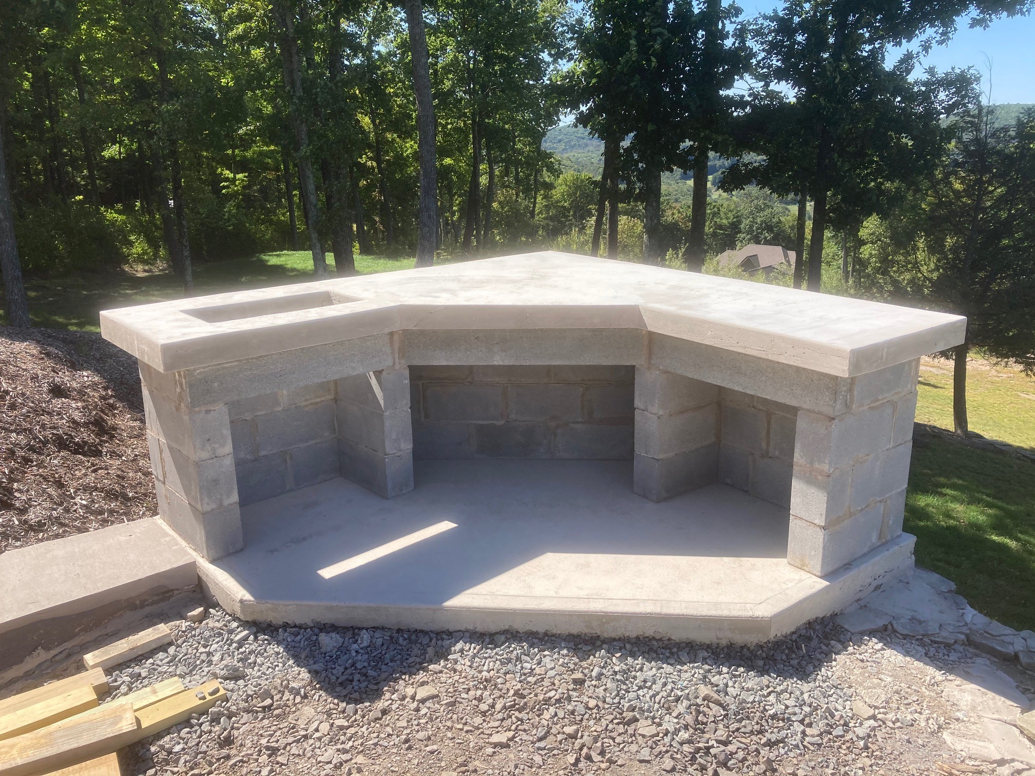

    This is the base and counter where the oven will be placed. A poured 4” concrete slab, 6” concrete block and a few lintels to span the openings. It’s a basic design but will work for wood storage for the oven and fire pit. The countertop is poured-in-place concrete that’s 3” thick with a 4-1/2” face. I made the opening on the left side for a drop-in stainless steel box that we will be able to fill with ice and store adult beverages and pizza toppings. I think it will work well for it’s intended purpose. When time allows the entire outside will be covered with natural fieldstone veneer, the same stone that we have used on the house, so it will all match.

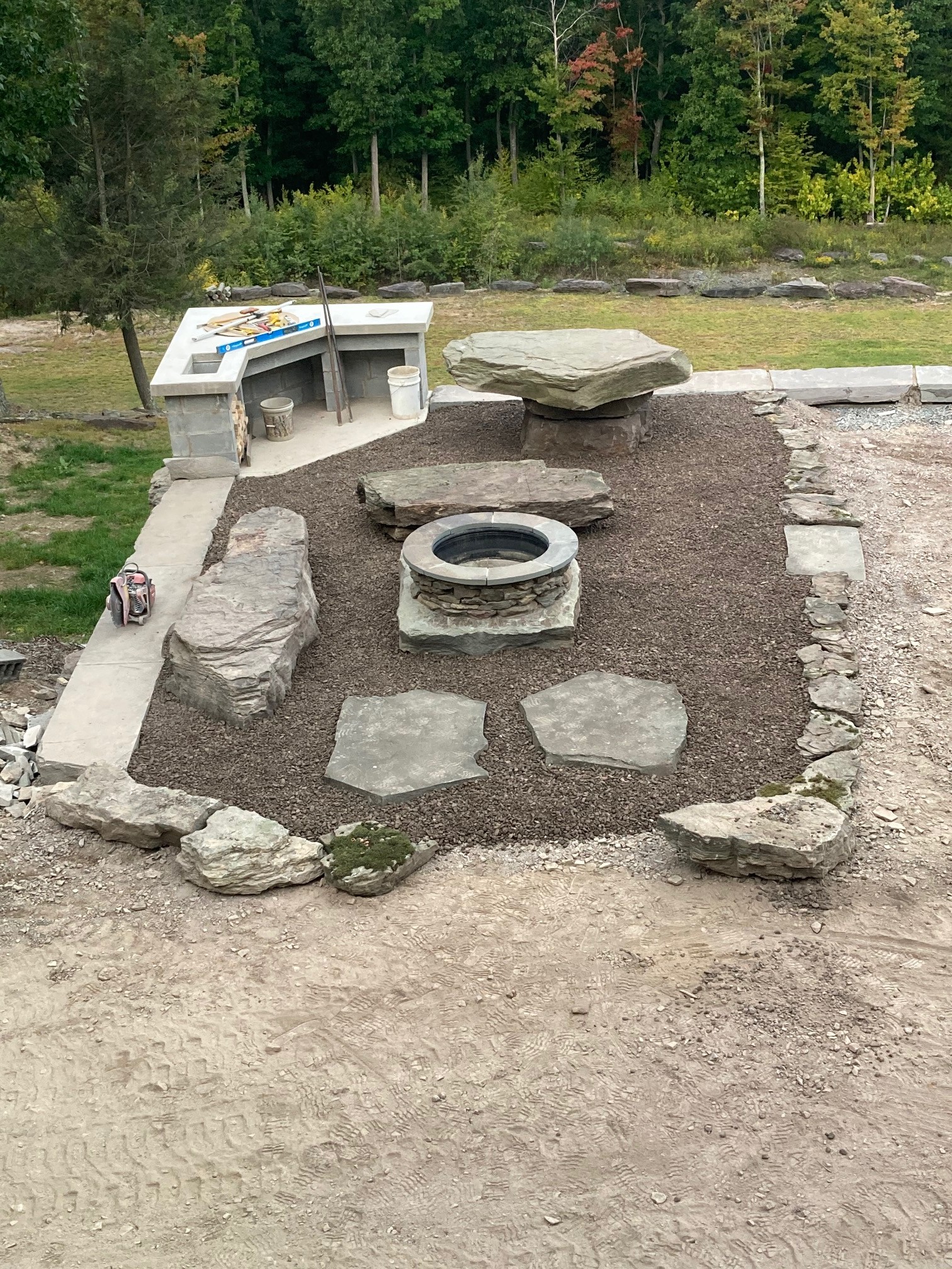

          I received a call from the oven builder and my unit is ready for pick-up. Hopefully I can find time to get there this weekend and grab it. I will post pictures when I get it home. Until then, the backyard area where the pizza oven will reside is getting closer to being done. I did it all with boulders, rocks and fieldstone that came from on the property.

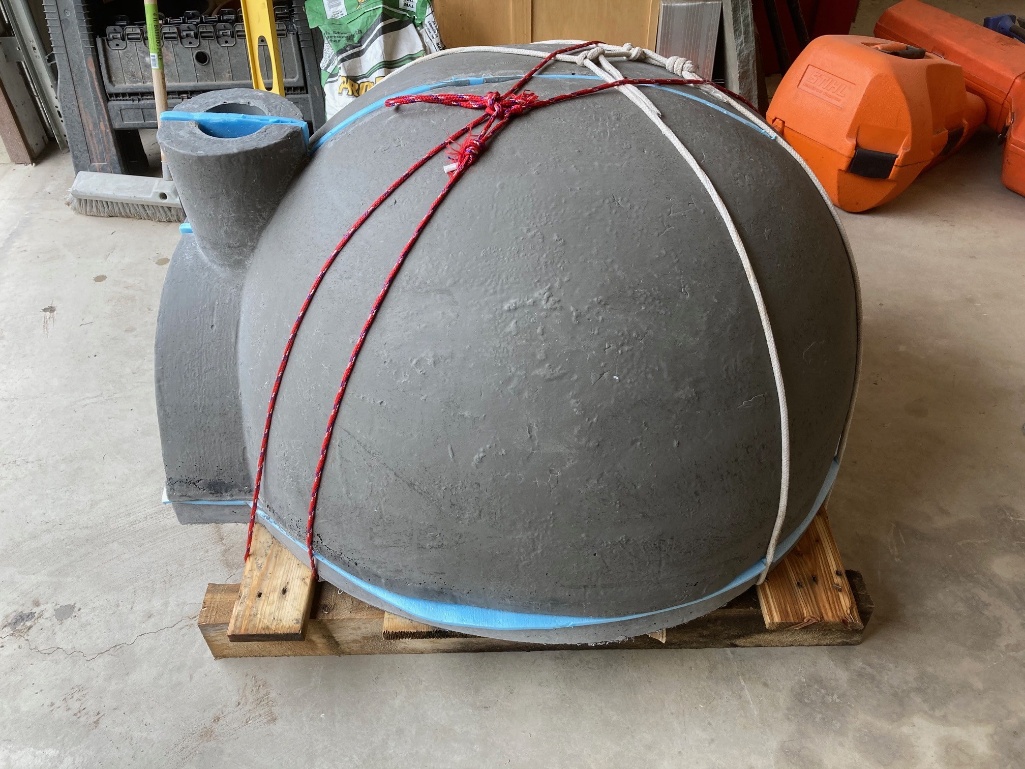

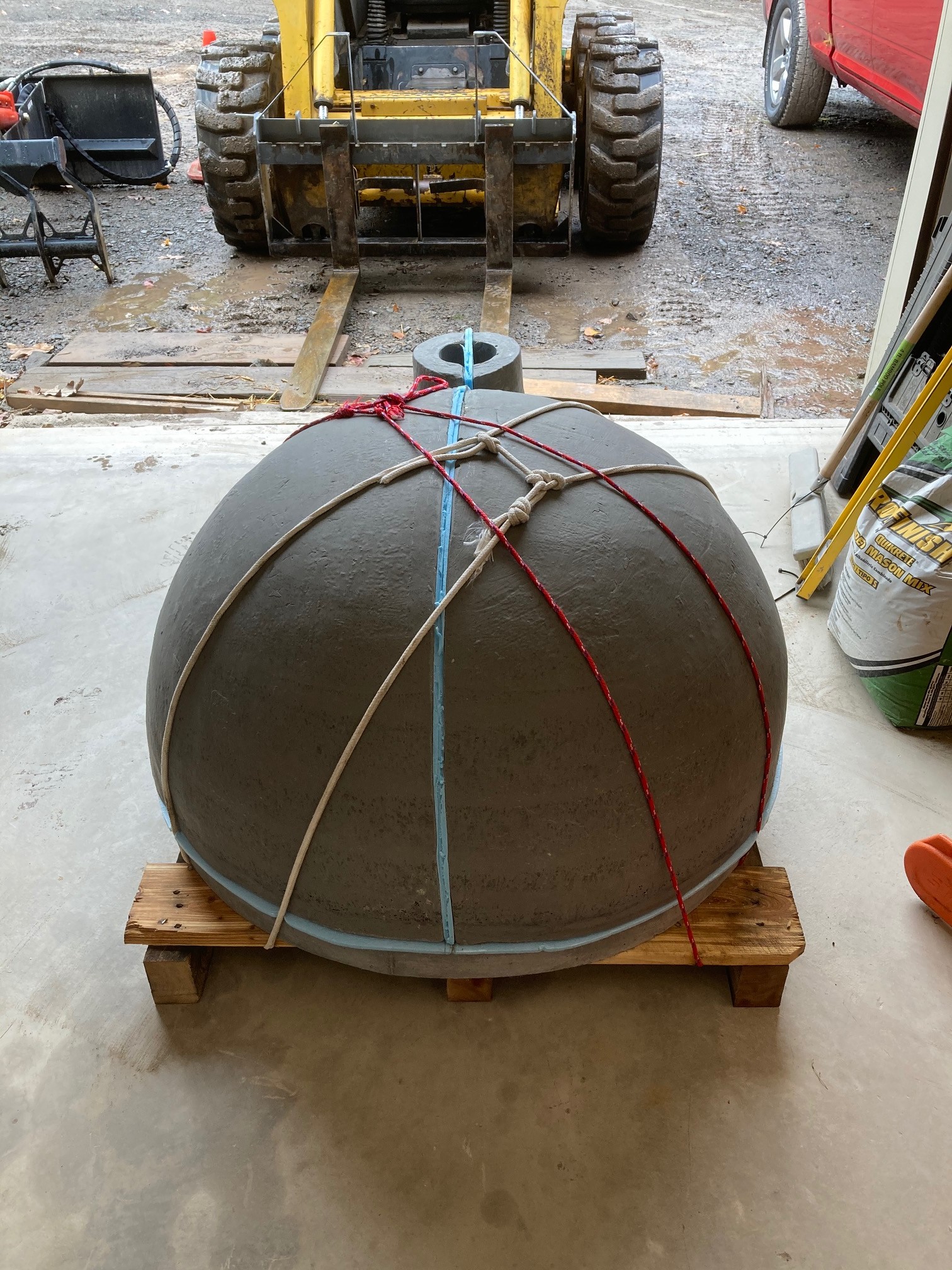

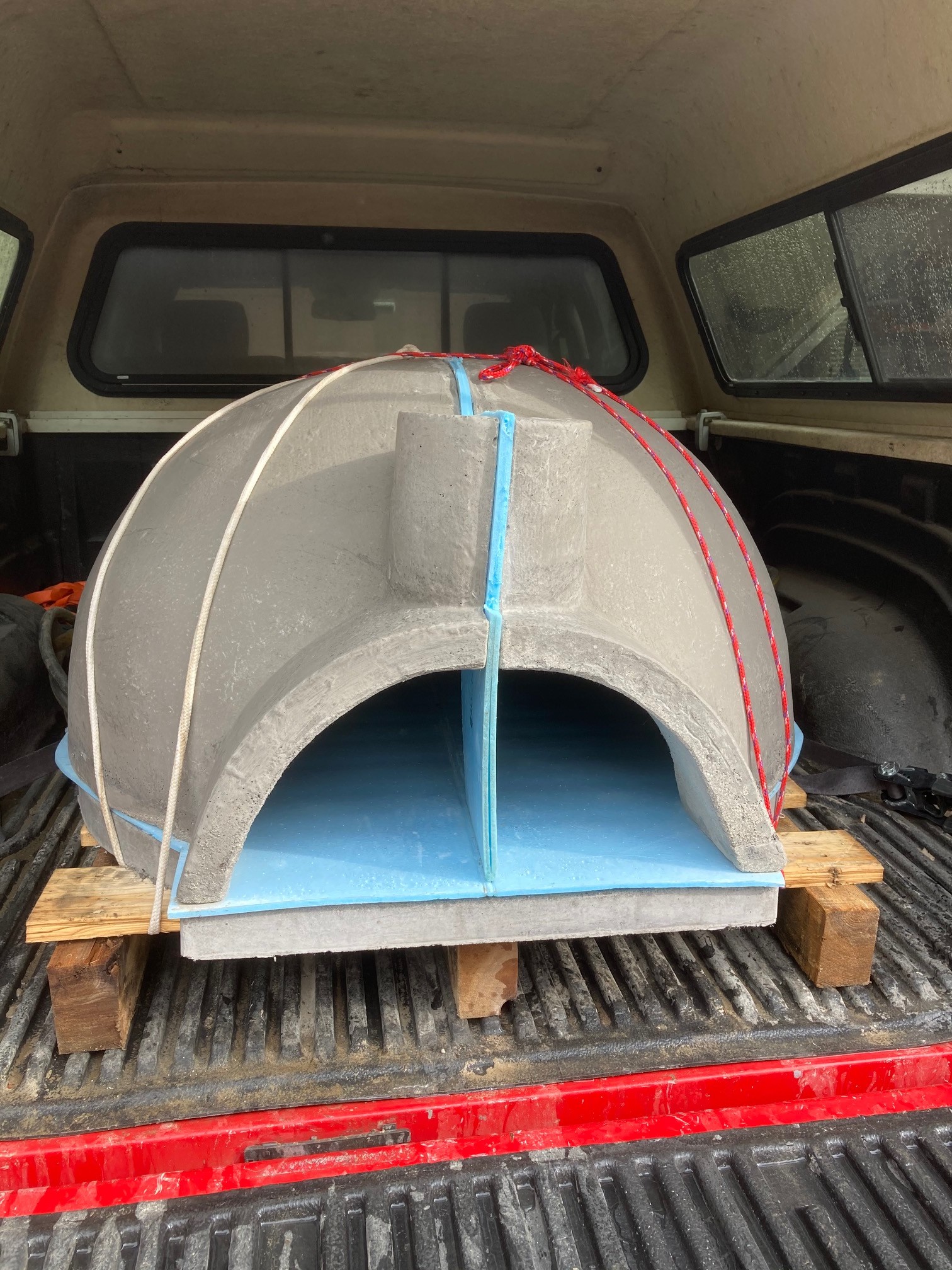

ID:	431581 Well, here are a few pictures of the oven that I picked up yesterday.Click image for larger version  Name:	CA73D10B-2795-4143-A766-84F240552E3A.jpeg Views:	0 Size:	755.4 KB ID:	431579

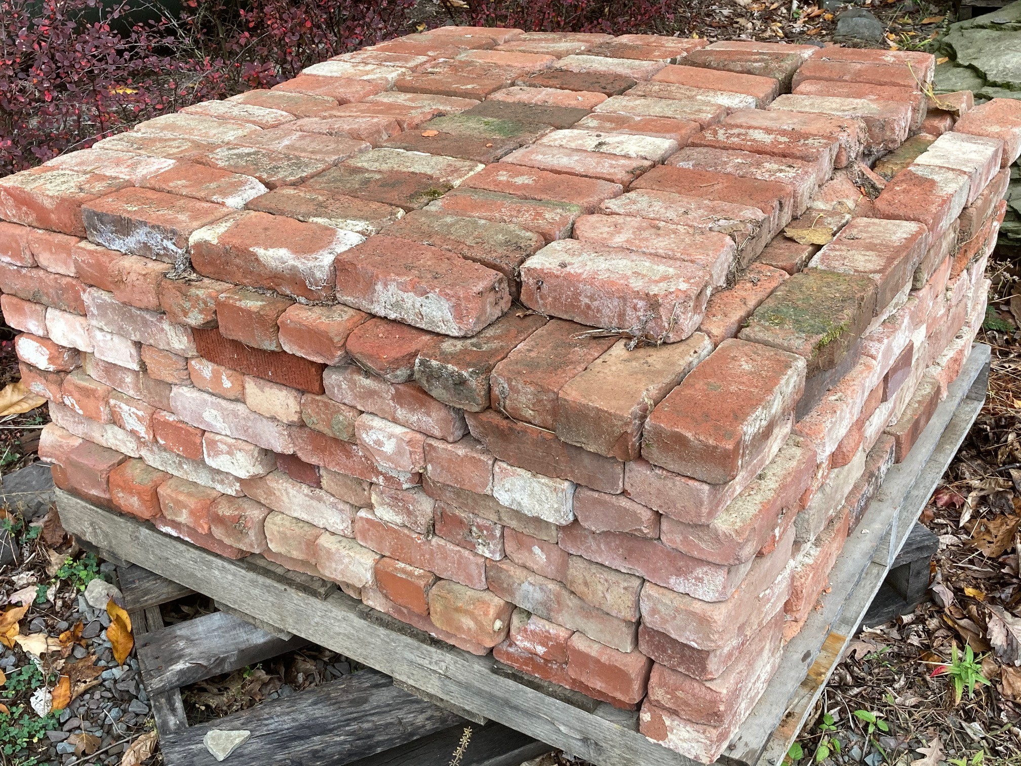

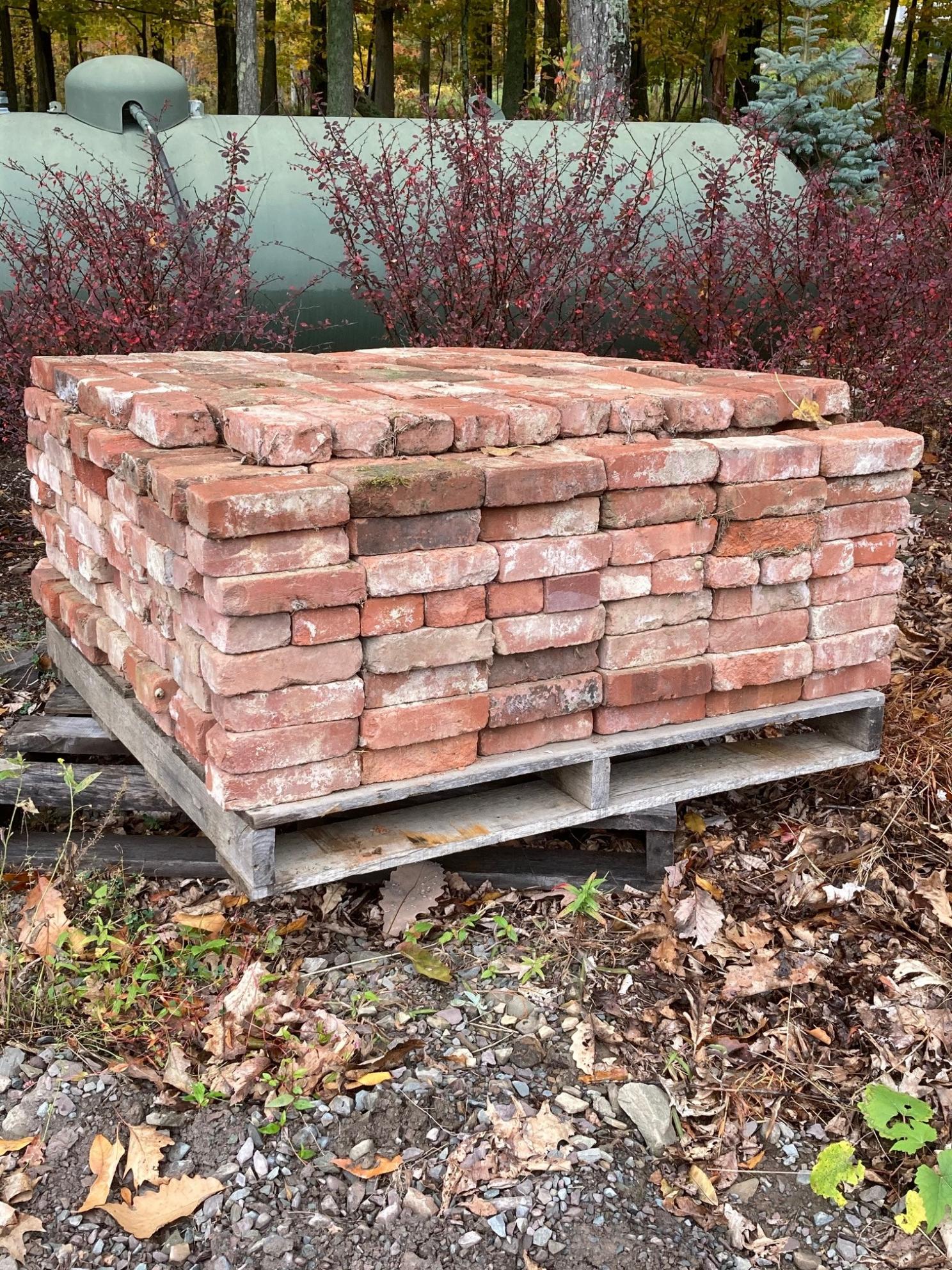

                Also, while talking to my better half about what she wants the finished oven to look like, I found out she isn’t crazy abou the “igloo” shape. We spent a bunch of time looking at pictures of outdoor pizza ovens and she is leaning toward a dog house or barrel design and with a traditional brick exterior. So, to surprise her tonight, today I was able to find and purchase approx 600 old bricks to use. They came from the Lehigh Valley Railroad shop in Sayre PA which was built in 1904, so they are well over 100 years old! Should make for a nice looking exterior once we finalize the design.
                Click image for larger version  Name:	9381F37B-2616-467A-A694-9A7568540E8D.jpeg Views:	0 Size:	1.33 MB ID:	431584

                  A question for the forum, please read.
                  After speaking at length with the guy who builds the ovens, he gave me a few options on using it. I can simply use it as-is on my counter if all I want to do is cook in it. If I want to do more extended cooking and retain heat, I can wrap it with a blanket and then an insulated layer over that. I’ve read numerous threads and still have a question for you since this is the cast oven forum. At this point, it looks like I will be building some sort of enclosure/dog house around the casting and want to add some sort of insulation around the dome, but I do not want to do a blanket. I need to build the enclosure(brick and stone) and since I’m certainly not a mason, it is going to take a week or so to complete it. Unfortunately it’s out in my back yard and at this time of the year heading into winter, it will be both cold and wet. Since it will be open to the elements, I have another idea but want to run it by you guys first. Can I use a perlite mixture right against and over the cast dome? My idea is to set the floor an begin building the walls up and over the dome. As I’m building, I want to fill the void between the dome and brick exterior with the perlite mixture. It should be somewhere between 2” and 4”(50mm-100mm) thick. In other words, all of the area between the casting and the dog house bricks will be totally filled with the perlite mixture. I’m trying to avoid the blanket being exposed to the elements for a week or better while I do the brick work, so I need to know how the oven might function without it.
                  Your thoughts? Will the perlite mix act as an insulating layer to help the casting retain long-term heat? I will build a form beneath the floor and pour a 2-3” layer of perlite mixture as well. Each evening when I finish, I can cover everything with a layer or roofing rubber to keep it dry from rain, but it will certainly absorb moisture just from the humidity in the air.

                      Hi Dan,
                      It is not optional to add insulation, but essential. If the exterior is not insulated the difference in the inside temperature and the outside will create enormous stresses on the casting and can lead to severe and sometimes sudden cracking. If no insulation is provided between the casting and your supporting slab, it will act as a heat sink and you'll lose het from the floor really fast. Adding insulation around the oven does not increase thermal mass but does greatly help retain heat. The usual under floor insulation is 2" of calais insulating board. The equivalent in cast vermicrete is 4" of 5:1 mix ie 5 parts vermiculite,1 part cement, 3 parts water by volume. If going this route the cast insulation slab requires two weeks of drying in the sun before building over it. Because the calais board is already dry you can build directly over it. This may be a better option for you although it's more expensive.
                      If you don't want to use blanket over the dome the space between the cast dome and enclosure walls can simply be filled with dry, loose perlite or vermiculite. The space should be a minimum of 4" and because the corners will be more than that, they can be filled with empty plastic bottles or fibreglass ceiling insulation.
                      Your oven does not have a rebate to fit a door for retained heat cooking and the flue exit is inside the oven chamber, so if you want to use it for retained heat cooking a shut off valve should be fitted to the flue pipe to prevent heat loss there.
