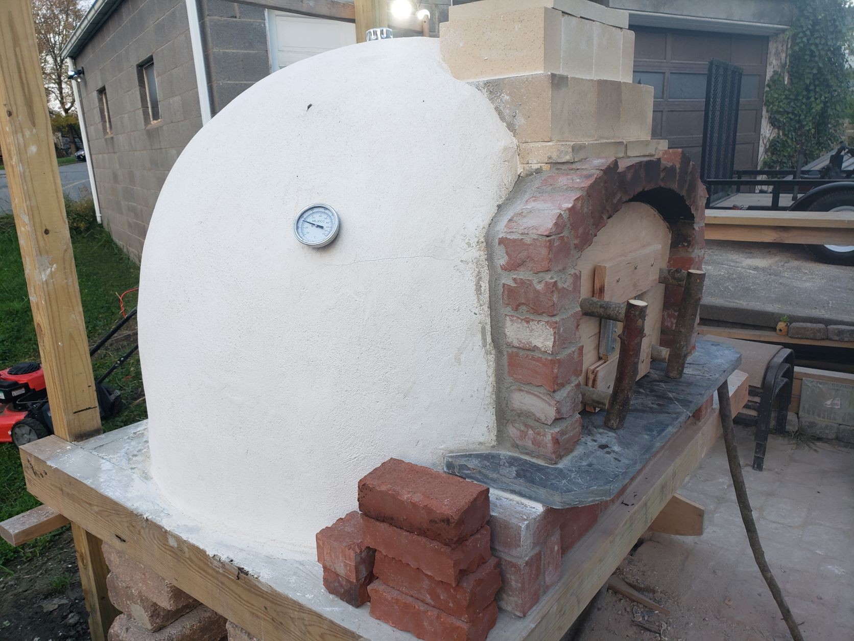

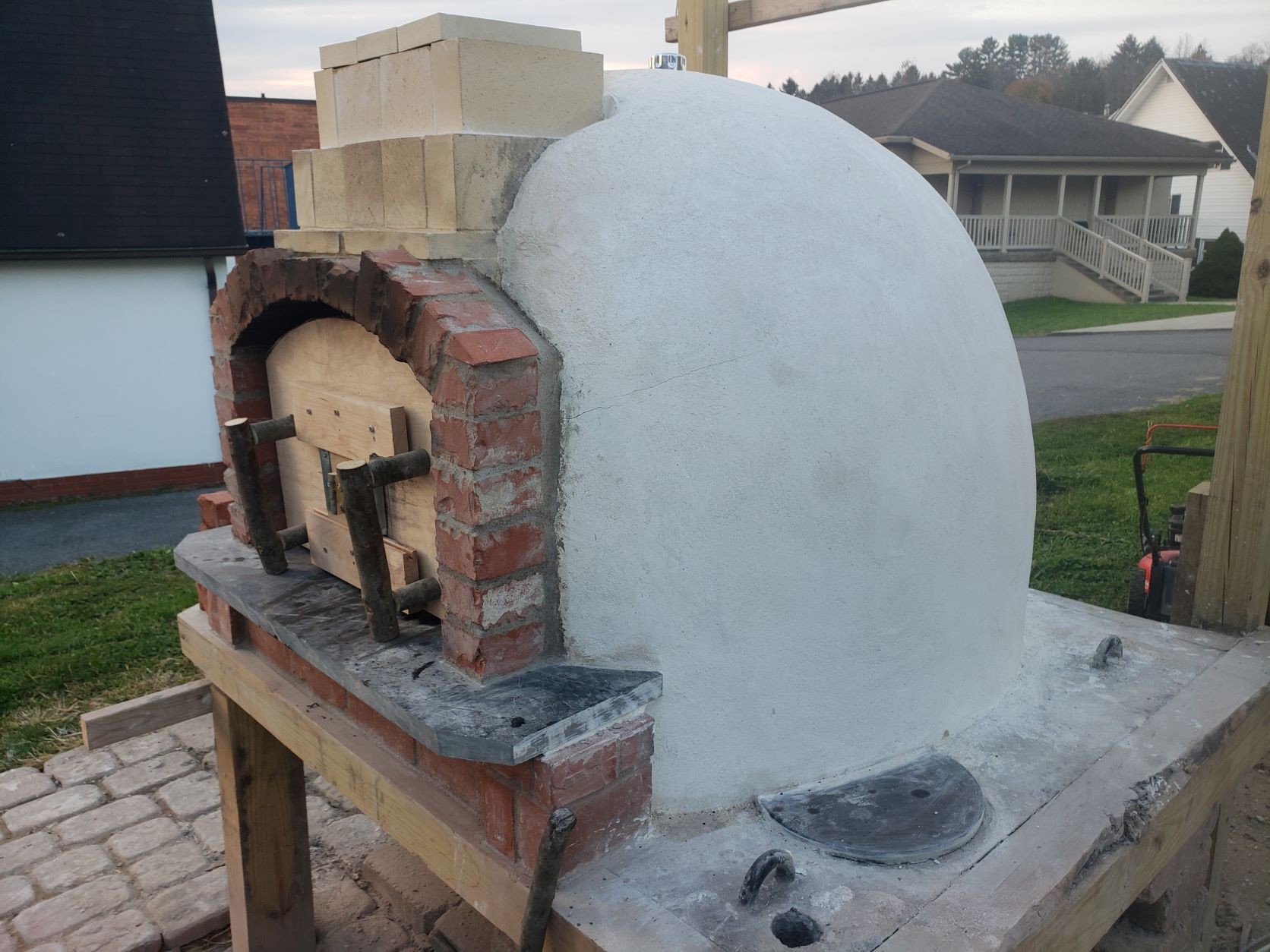

    I just Completed "Mountain Mama"
    5 months total build in backyard, rough patio to paved, foundation, then for the last 2.5 months it has been the oven and last 2 weeks curing and finishing.
    I still have final touches to do all around the structure, but she is fully operational and can reach 700+ degrees and has turned white on the interior brick.

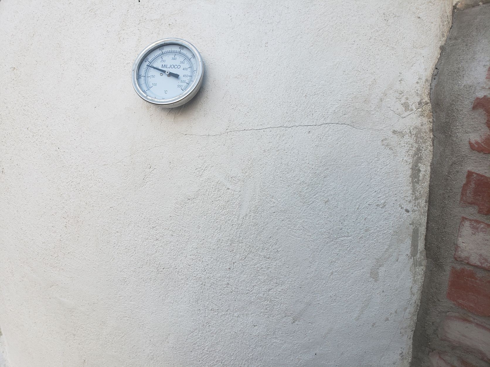

    I have two small hairline cracks in the dome on each side of the hearth half way up the dome. They are small and only become visible when the oven reaches + 500F/260C.

ID:	443047 Questions - Should I be concerned?
    Will the oven sealant i am going to apply before exterior paint help with this being visible? ( i know hairline cracks are common)
    there are two layers of chicken wire with 2.5+ inches of concrete for the dome.
    Recommendations on sealants and exterior paints?
    I have a 3 layer stucco with a homebrew mixed base coat, then scratch and brown, then Final coat stucco.
