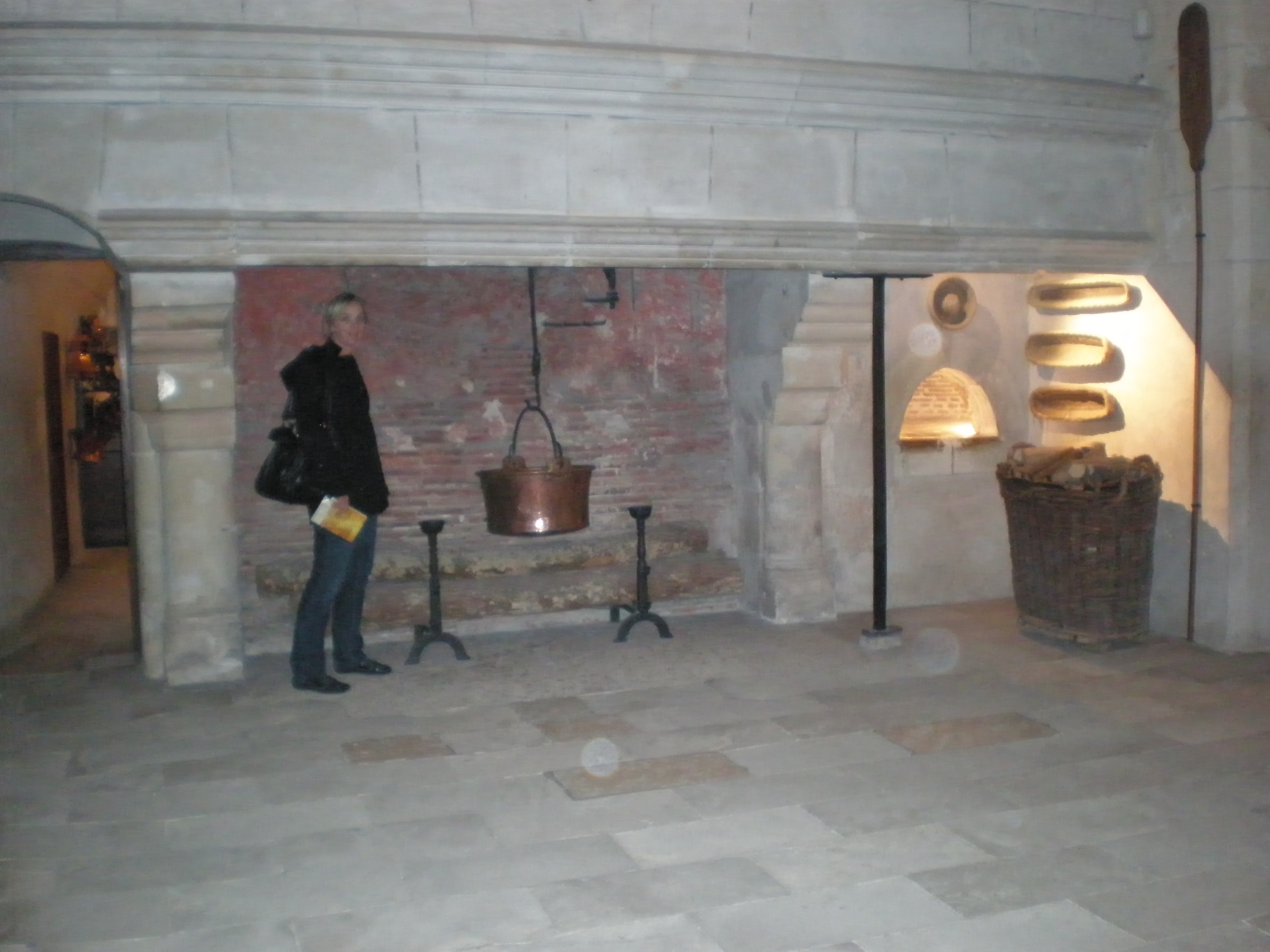

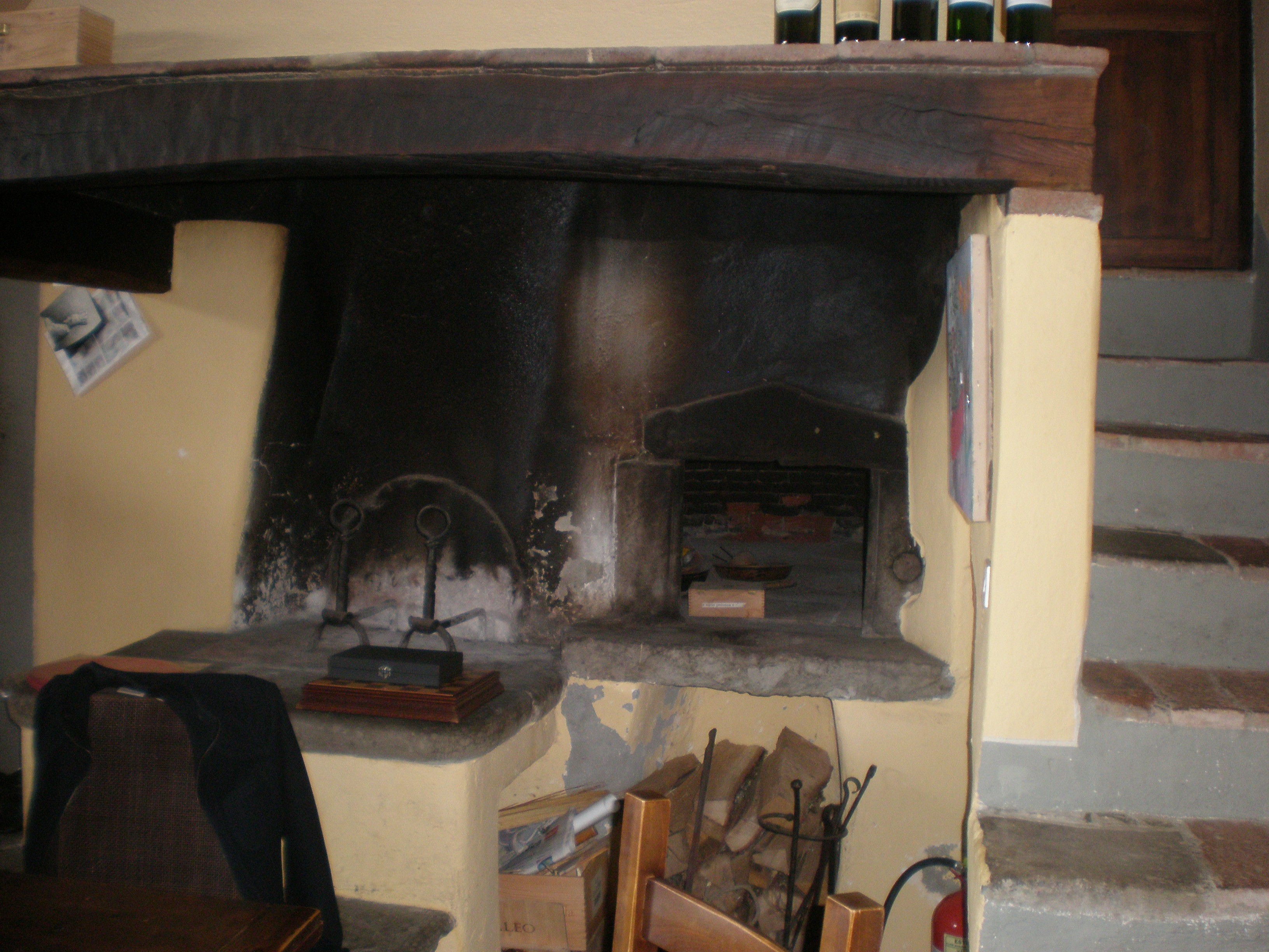

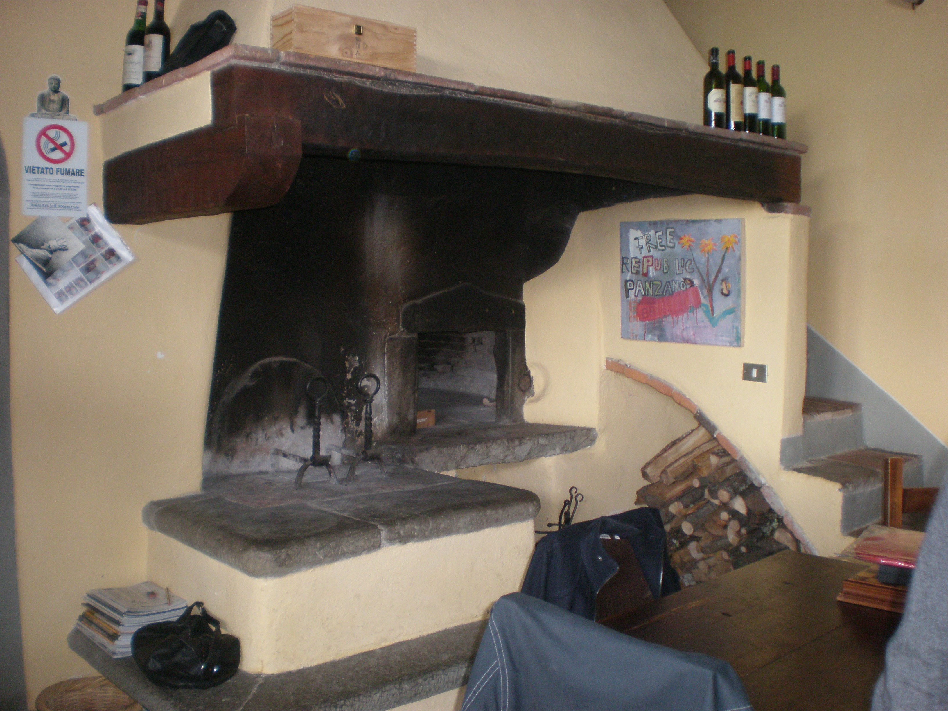

            This solution has been around for several centuries, with the oven sharing the same chimney with the fireplace. Many European castles had ovens sharing the kitchen fireplace chimney. The second one, on a smaller scale, is from a 400 year old villa in Penzano, Italy. Note the stairs leading to rooms upstairs which are heated by the chimney.
            Click image for larger version  Name:	chinon castle.JPG Views:	0 Size:	848.3 KB ID:	443500 Click image for larger version  Name:	Penzano oven detail.JPG Views:	0 Size:	1.42 MB ID:	443501 Click image for larger version  Name:	Penzano oven.JPG Views:	0 Size:	1.42 MB ID:	443502
