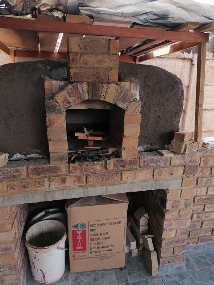

            Enter the beginning of the drama. ( I promised you drama)
            The base of the frame that I was using to hold the roof up while I was working my way forward and waiting for the mortar to dry. Yes I was counting bricks and working out what I would be using all the time. I still went back twice to get more as I didn't include enough. :-)
            Inside the oven showing the arch that I had worked in to the build. Key was to make this build as easy as possible.
            Once the mortar was dry, I would knock out the two bricks at the base, move the frame forward and then start again. The upper course of bricks were cut in half so that the roof arch could have a good 40mm to rest on.
            Enter the drama. When I worked out the door and % of the opening regarding the internal height as well as the stack. I messed up and didn't take the thickness of the base into account, DAMN DAMN DAMN. Everything was locked into place and the opening was too bloody low to allow for proper draw.
            I was pretty heartbroken and didn't touch the oven for a good week until I had a plan in mind on how I was going to fix it without tearing the whole thing apart.

              In the end I decided to chisel out the two bricks in the arch and would cut them and refit, without disturbing any of the other surrounding them.
              The cut was made and then refitted. It actually turned out pretty much fine. Well besides the days of no sleep.

                        I can get the oven up to the mid 450's Celsius with ease, but I find cooking pizza around the 400 mark gives me the best play time.
                        One of the peels being shaped again as I wanted it thinner.
                        Nice fire going and everything still clean.
