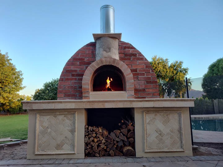

    I finished up a barrel style pizza oven build a few months back. I got a ton of help and inspiration from this forum, so I wanted to post what I built in hopes that it may help someone on their build, especially since I had a harder time finding barrel style oven examples. I plan to just post mostly pictures in chronological order with possibly a few clarifications here and there and maybe some key words to help with searches. I hope you enjoy the picts.

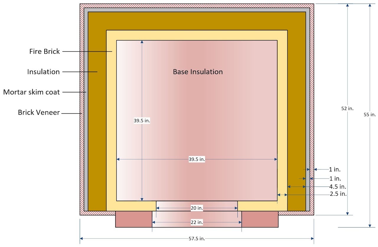

        Deciding I needed more of a plan. Started sketching and planning a bit better with the help of this forum.
