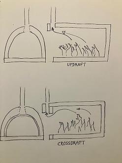

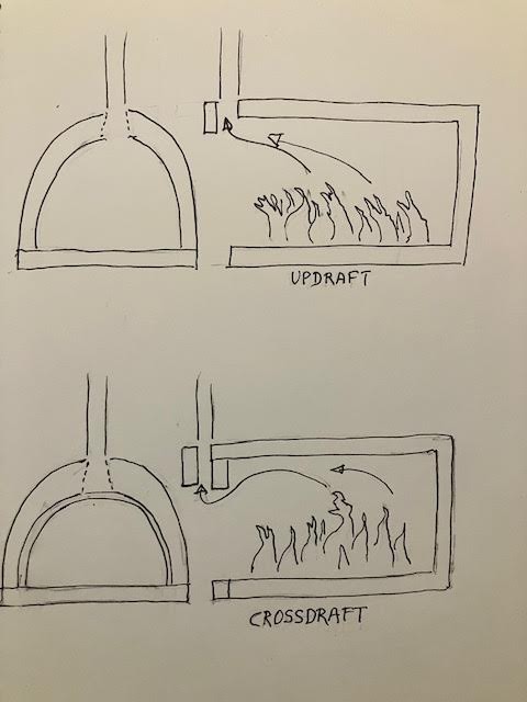

    Ah yes, my error and apologies. Yours is a cross draft.
    Your pic from post #13 explains how the flame will be drawn across the crown of the vault and down and out to the chimney. Here is a drawing explaining the difference.
    Updraft vs cross-draft.
