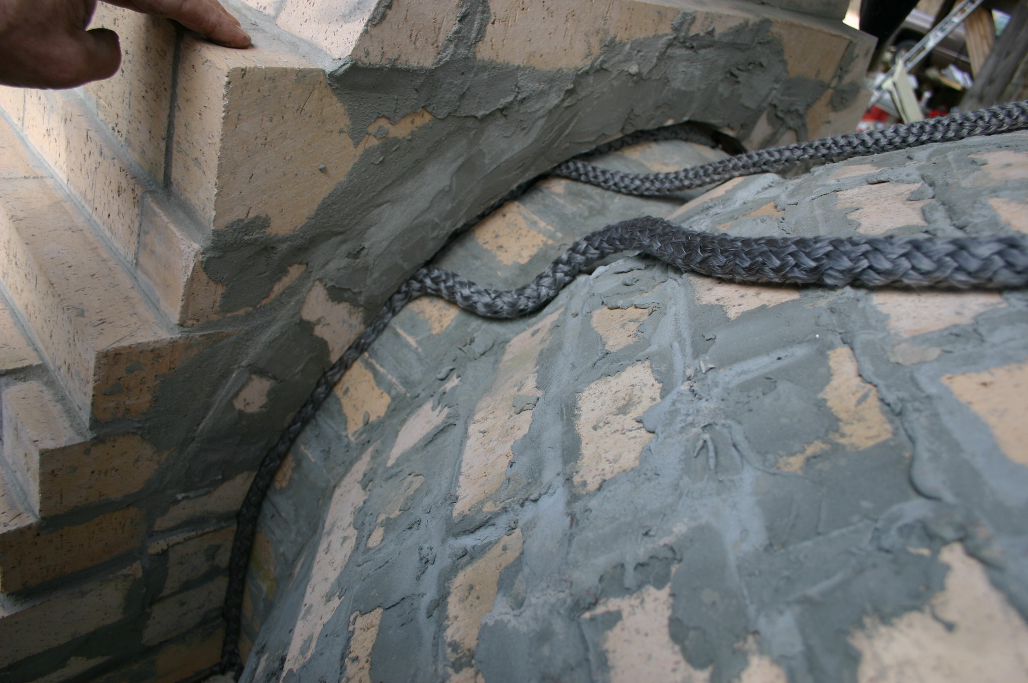

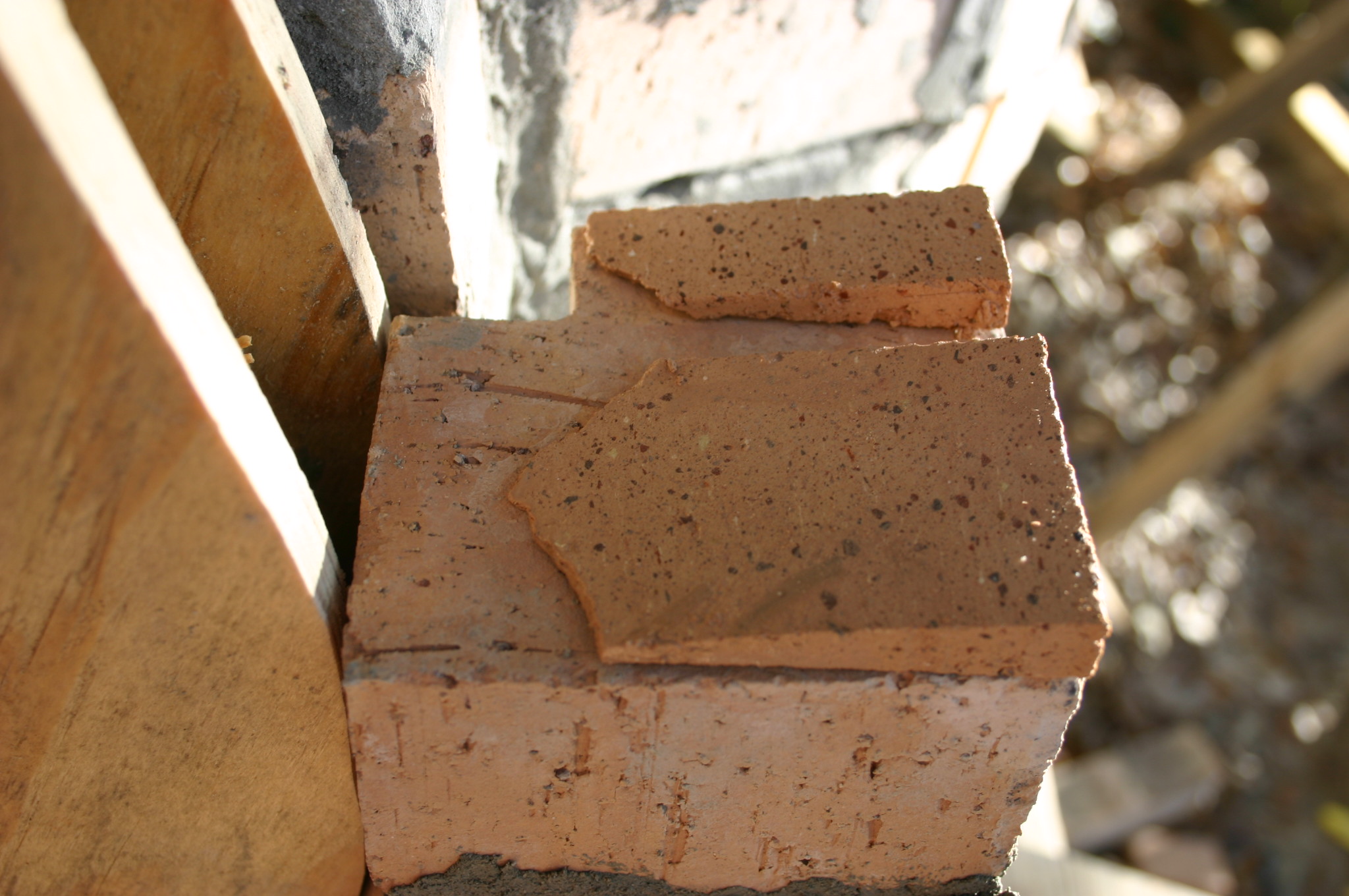

    .........But what should I use to seal the inside arch to the outside arch on the bottom of these two .?? I have a 1 inch overlap unlike yours where you placed it above the 1st arch .. It is a 1/4 inch space .. sealant or do I pack it with gasket material Looks like you used the black sealant for your whole closer.. ......
    I did use gasket material to pack the space. Mine is an L shaped joint. If I had it to do again, I would not notch the outside arch brick for the break. I would just overlap it with a space outside the inner arch.

    I did seal over the joint inside the flu entry, but I wouldn't do that again. I speant a considerable amount of time cleaning that mess out of my oven. Afterward, I used an artists brush to seal the rope fibers. I used a slurry of Type-N masonry cement and fireclay. Actually, the fireclay was the fines colected from my wet saw.
    I think that 3/8th " rope is as thick as you could place in the 1/4" joint. I would use the rope for the final pass inside the flu entry, if you can find it. For the rest of the gap, I would use strips cut from one end of the cf blanket. That would be cheaper that buying enough rope to fill the entire gap. I used a sharp utility knife and a metal straight edge for cutting the blanket. A framing square works great for a straight edge. Just place a piece of plywood or a 2X4 directly under the cut. Press down firmly on the square and cut. You can use a good pair of scissors, but they won't be a good for very long .

      thanks I will use the rope and I have some heat stop 50 left over, to seal the rope for the inside .. .. I`ll use the rutland for the top ..
