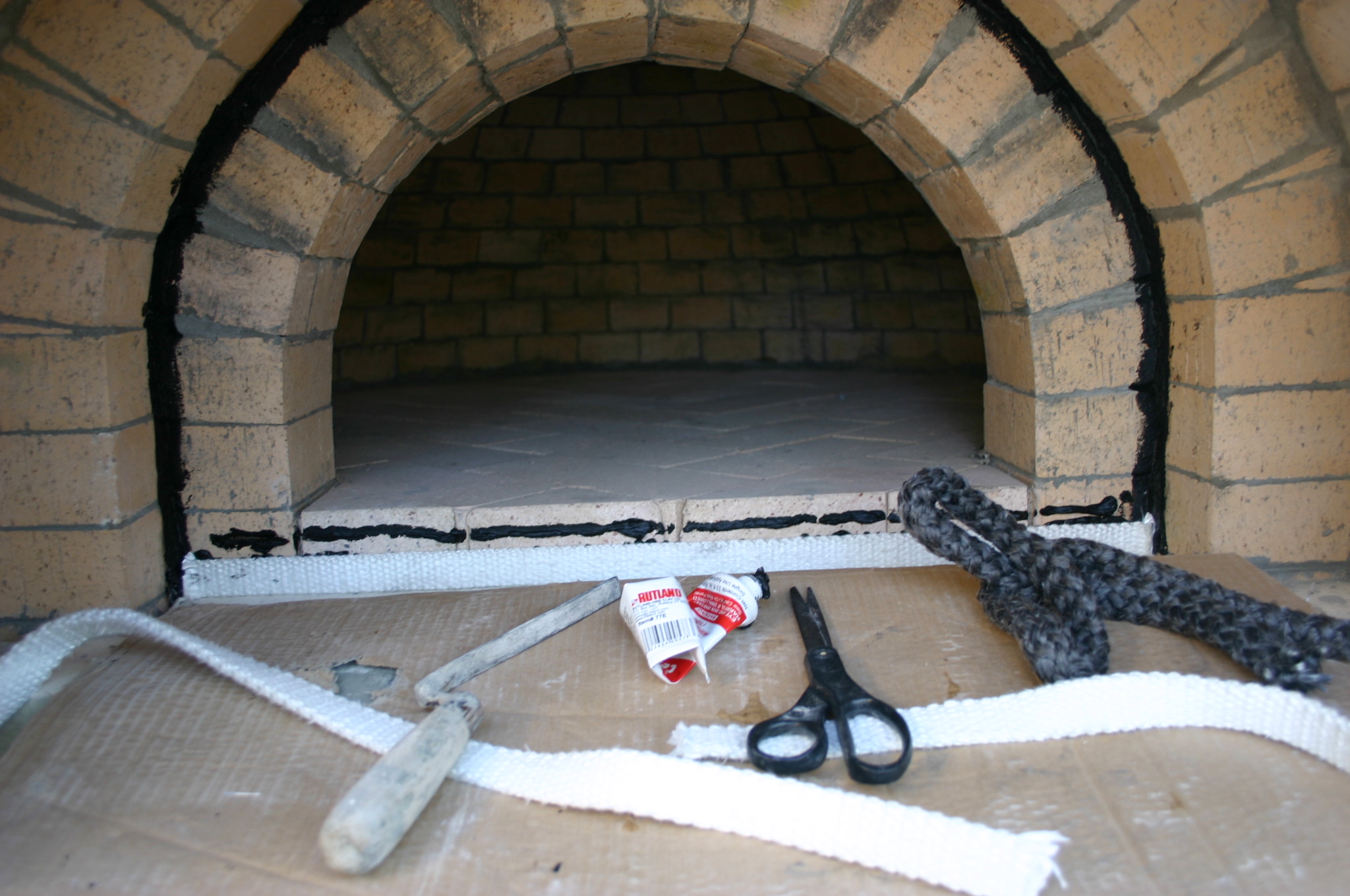

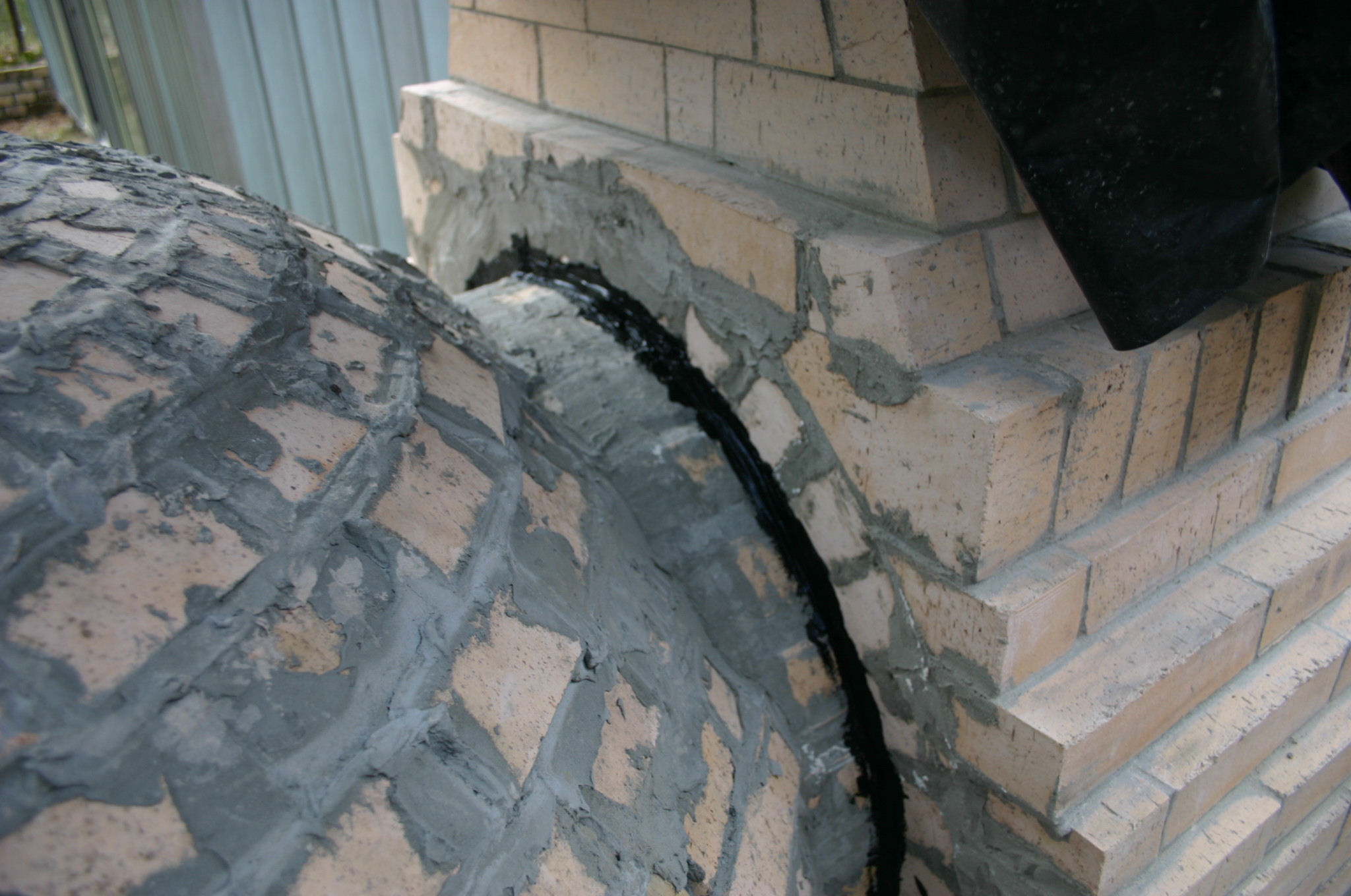

                            Merlyn,
                            Have you picked up your cf blanket, yet? If so, the blanket material is flexible enough to lightly pack the gap. Rutland Black is available at most Ace Hardwares. It is rated for 2000 degrees. It would be fine to use for sealing the backside of the heat break.
                            But, I would not use for the inside ........
                            again.............
                            Also: I bought the "ceramic fiber rope gasket" from a fireplace store locally. I now believe that is actually a graphite impregnated fiberglass. "Grapho-glas", which is also made by Rutland and sold by Ace is rated for 1000 degrees. They sell it in a kit as a stove gasket replacement
