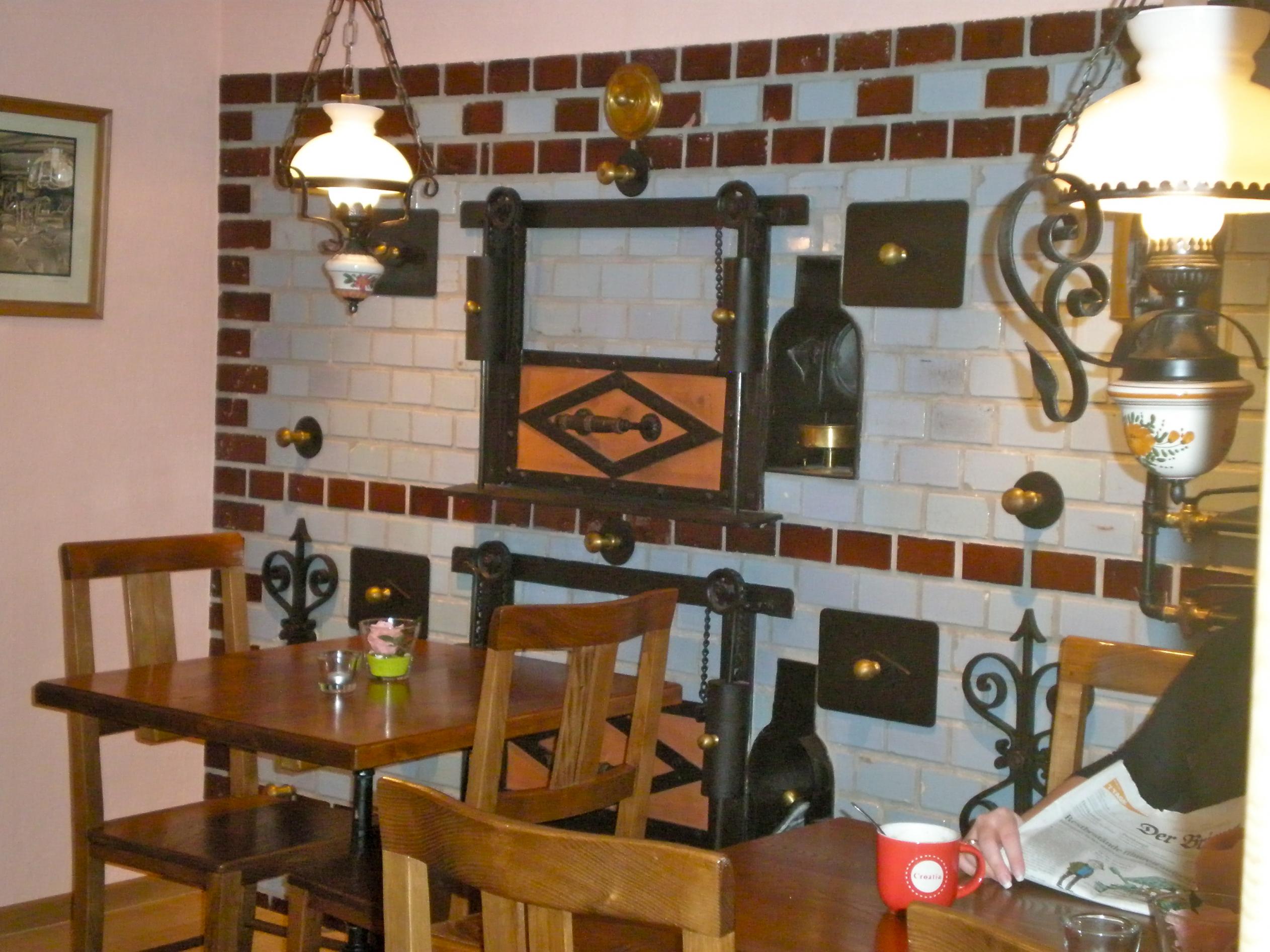

                I've finally decided that the outer door will be made of ceramic fireproof glass. When fully closed you can see the whole fire without the radiating heat. If the door is totally closed, two air vents, which take air from the outside of the building feed the fire from either side at the bottom of the vent area (see recess holes in picture). The glass will sit within a U shaped frame and will be removable. There will be a counter weight the same weight as the door which hangs inside the Inside the envelope/box. It will be a bit like how a sash window works, and enables the window to stay in any elevated position due to its counter weigh https://en.wikipedia.org/wiki/Sash_windowt. All this will be will be removable for servicing
                • #23
                  Here's such a door. This one from our visit to Switzerland in 2010.
