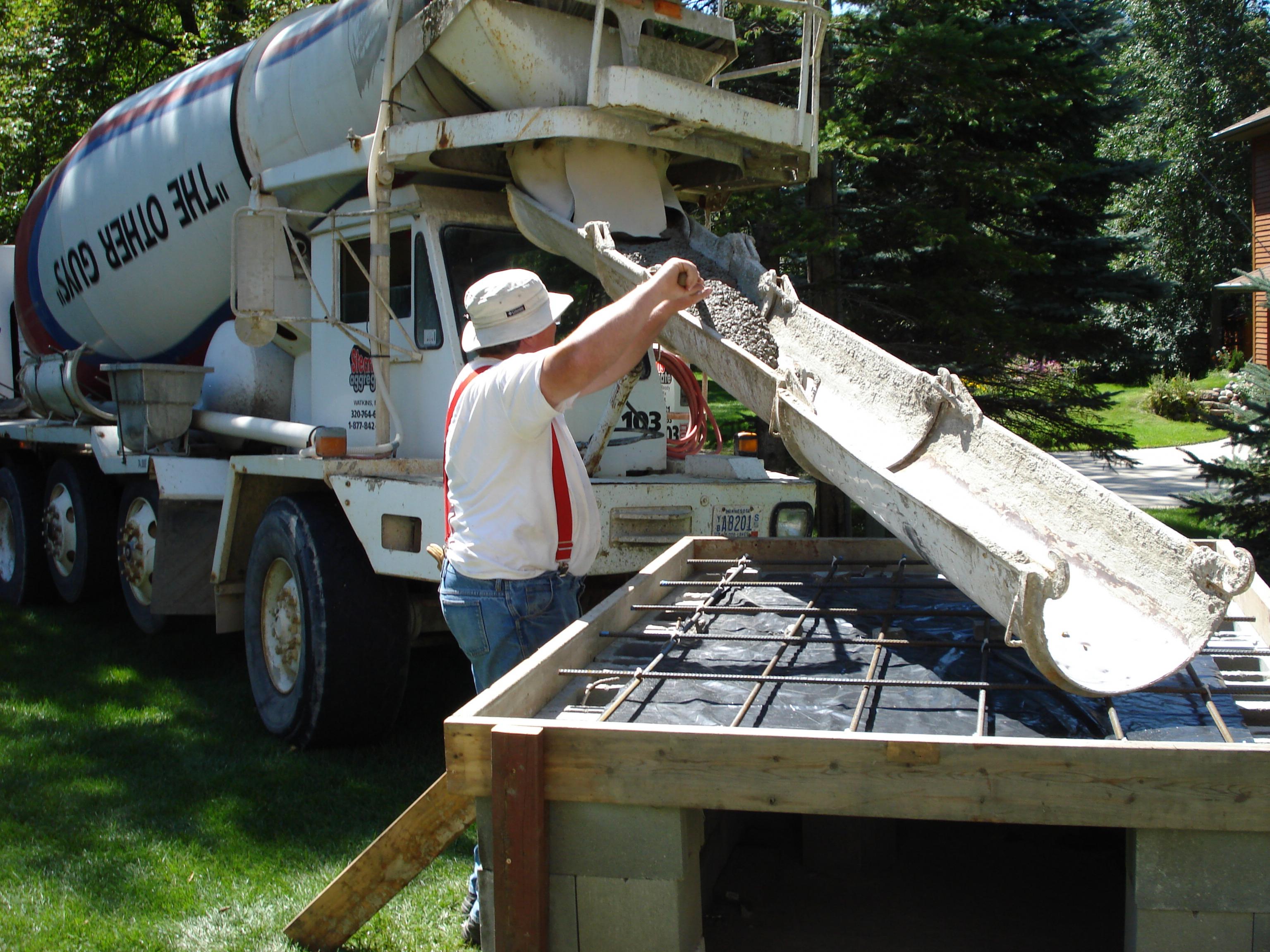

    Thanks to this forum I am off to a good start on my oven project. I started on 8/3 and have poured the slab, erected the stand, poured the hearth and the vermicrete in two weeks! I have everything I need lined up, just need to transport the firebricks and start sawing. I will use homebrew mortar and loose vermiculite in some type of house enclosure. I'm planning on having the dome/landing/vent completed by early Sept. I put together an indispensable tool and bought a beefy looking 10" saw with stand from Menard's for $250. I was able to get "redi-mix" delivered to the build site for $140 per yard. No muss, no fuss, no mixing; just screed and trowel.
