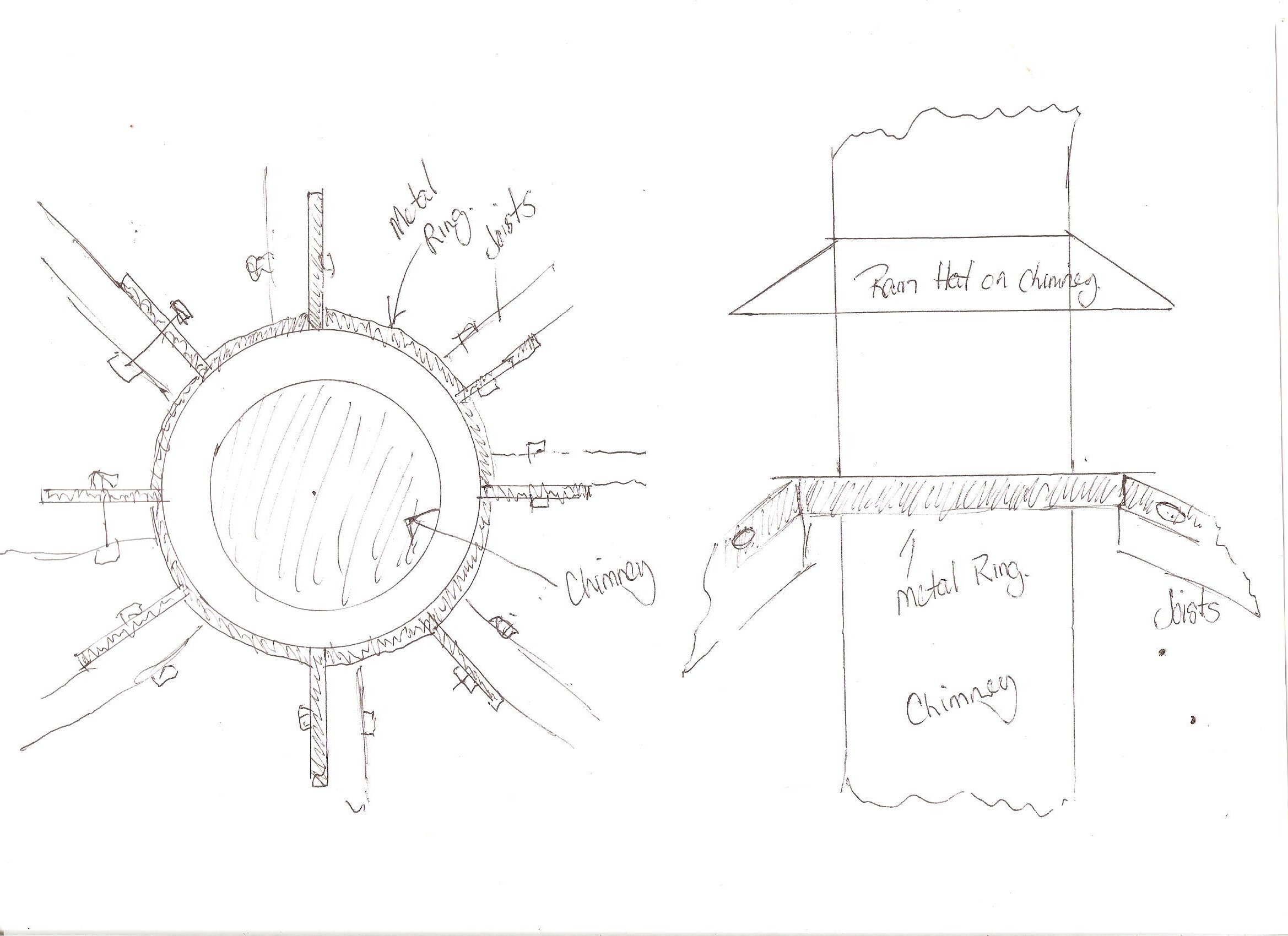

              #81
              Re: Red Clay Brick Oven in the Philippine Islands
              Gudday
              find attached possible way if putting chimney through an octaginal roof
              this is not my idea but something I seen used on a house renervation yrs ago. Mod 1 from the engineer did not work he didn't allow for the lenght of the bolts. We changed it and had it remade and powder coated black againt varnised wood beams it was special
              Regards Dave
              • Lancer
                • 423
                #82
                Something like that was kicking around in the back of my mind, but with double metal bars to carry each joist. The elevated rain flange too, it allows for hot air to rise through but sheds anything but sideways rain. Nice find cobblerdave, and I really appreciate the time you've spent. I have one reservation, we live on the ocean and everything rusts. I could have this welded up in stainless but...$. I'm trying to think up an alternative long lasting cheap solution and not coming up with much. Doubling the chimney is what I'm considering, then on the outer, cooler chimney attaching the wood directly. Still in the planning stages.
                Btw, 'Measure twice, cut once' was the saying my old carpentry teacher from high school swore by.
                • Lancer
                  • 423
                  #83
                  I think something like that would be best Dave. If I'm going to spend all the $ doubling the chimney I might just as well get stainless welded up as shown, with a single plate and stainless bolts. The more I look at it the better I like.
                    #84
                    Gudday Lancer
                    Or have a bet each way and only double up the section that passes through the roof ? Stainless bolts are expensive ,double dipped gal through the wood beams should do. I live 1/2 km off Morton bay double dipped gal does the job.
                    • Lancer
                      • 423
                      #85
                      I would if I could, believe me. Finding galvanized here is a problem. Forget galvanized nails and screws... I can find stainless bolts not too expensive. They're a basic part to the motorcycles here and sold in the city. Found stainless welding rods as well, just have to find stainless plate.
                      Amazing things these stoves. At every turn I'm having to learn some new procedure or use materials which are totally unfamiliar. This will be a fun project.
