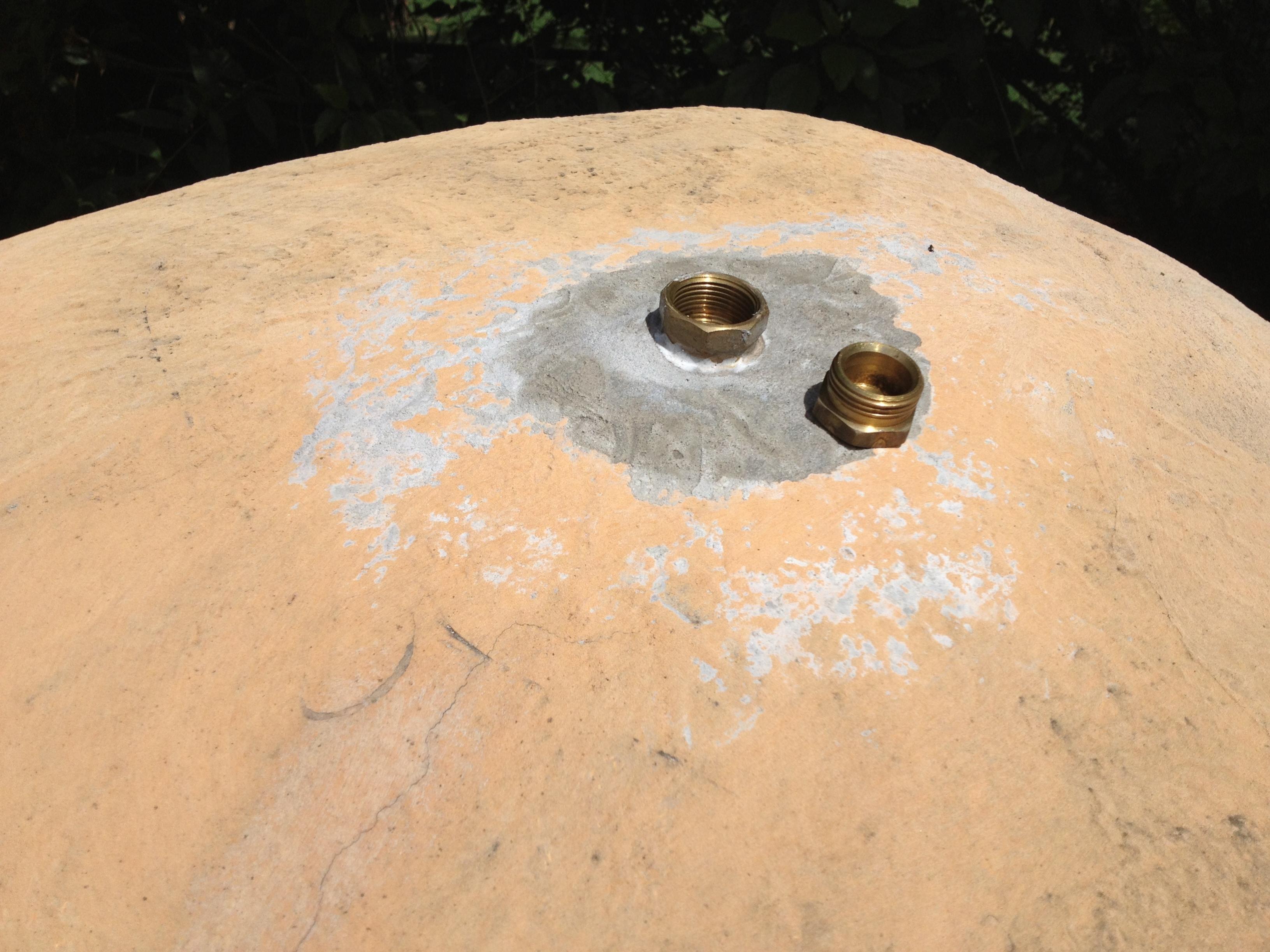

                            The curing fires are done and the coals of the last fire are on the way down as I write this. I cured the oven without the insulation. There seems to be multiple schools of thought about that but the ambient temps here are not extreme and frankly it made sense to me to have a way out for the moisture as the heat drives it out. There are some small cracks in the mortar but they have settled back to be nothing much (the pic was taken when the oven was very hot but the exterior had not saturated). The inside has no evidence of cracks.
                            Tomorrow I will put the ceramic 'wool' insulation on, the chicken wire and start on the vermicrete layer. I am thinking of applying the vermicrete in a couple of layers to allow it to dry more easily. Would a couple of days between layers be of use for this purpose? Also, how long is good before applying the stucco?
                            There has been some mention of leaving a vent for moisture to escape the dome. Would anyone care to expand on the notion?

                                #60
                                Re: New 36" Pompeii at Bundaberg
                                Gudday Steve
                                Dome cap mk 11 basically a brass water pipe end cap silastic to the dome. Hole was caste by rolling a bit of cardboard and mortaring around it . Once the mortar had cured the cardboard was wet and soggy and easy to remove. A chain has been attached to the cap and drops down the pipe so "little fingers" don't lose it.
                                Perhaps a bigger end fitting and cap is made irrigation pipe? , there's a bit of that in you area.
                                Hope this helps in some way
